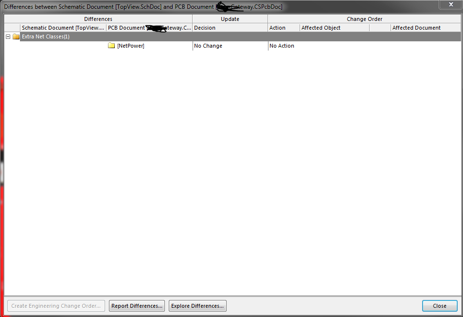

  • gussabina
    gussabina over 9 years ago in reply to gussabina
    Peter:
    From the PCB document, selecting Project->Update Schematics I get the following message;
         None of the 1 differences detected can be resolved by automatically generated ECOs
         View Differences?
    And selecting Yes, the following window opens;
    Clicking on second line, following window appears;
    where update schematic option is disabled...
    So it seems I can't do anything from here...How should I proceed?
    Also, when schematics are selected, I don't see Classes option available...
    I would appreciate any help.
    Thanks
    Gus
  • e14softwareuk
    e14softwareuk over 9 years ago in reply to gussabina
    The net classes should really be defined on the schematic and will then be added to the PCB when you run Update PCB Document.
    To add a new class on a schematic:
    1. Home > Directives > Net Class
    2. Attach the directive marker to a net.
    3. Double click the marker to open the property dialog.
    4. Change the NetClass parameter value to the class name you want.
