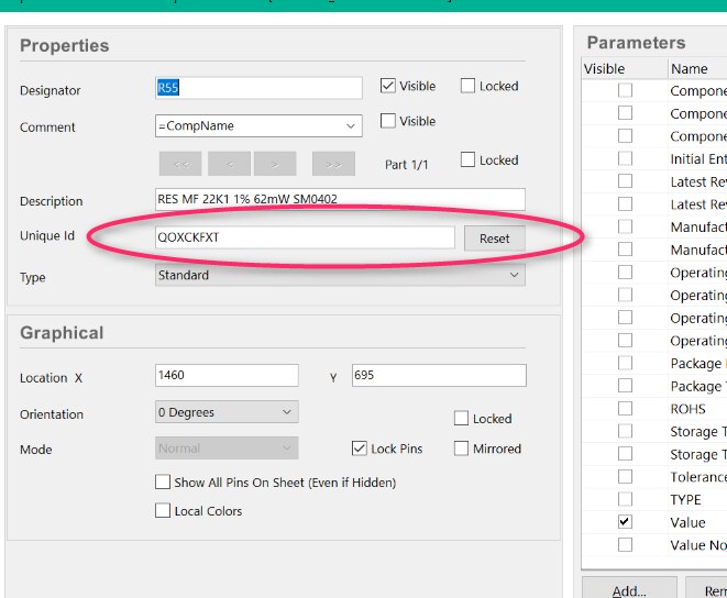

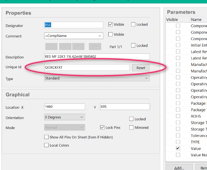

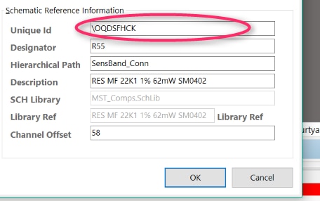

    It is a good idea on projects to verify that all the schematic and PCB components are matched and the edit component links tool (from the PCB menus) is the way to do that.  So you know, the schematic and PCB instances of a a component have a unique ID code that match.  When you cut and paste parts and then edit and change the reference designators, these unique codes end up not matching.  What you are doing with the tool is rematching them based on the check boxes for designator, command and footprint.
    You can learn more by Google search on Altium and unique ID.  Here is a link to a relevant page. http://www.altium.com/documentation/17.0/display/ADES/((Annotating+the+Components))_AD
    Here are properties of the schematic.
    And here is the PCB instance.
