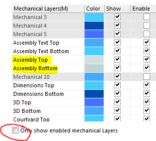

I used Mech12 & Mech13 as my top and bottom assembly drawing layers in Altium for many years. All my footprint libraries have "data" on these layers.
Now that I've switched to Circuit Studio anything on Mech12 in the PCB library editor comes in on the "Dimensions Bottom" layer in the CS PCB editor. I think I want it on the CS "Assembly Top" layer. There is no Mech12 in the layers list in the CS PCB editor, nor is there a "Assembly Top" layer in the CS PCB library editor.
So how can I get this Mech12 library data on the PCB "Assembly Top" layer?

    My guess on this one is you would need to edit your library components to move the data to the new layers. I believe Mech12 = Dimensions Bottom and Mech13 = 3D Top. There are Assembly Top and Assembly…

    My guess on this one is you would need to edit your library components to move the data to the new layers. I believe Mech12 = Dimensions Bottom and Mech13 = 3D Top. There are Assembly Top and Assembly Bottom within CS.

    e14softwareuk over 8 years ago in reply to optoeng
