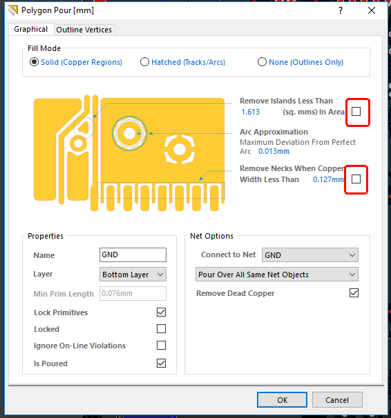

    1) Try adjusting the polygon properties, unset the two options shown.

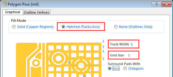

    2) Use a hatched polygon with properties set so that it is actually filled, set the track width and grid to the same value (e.g. 1mil).

    Hi, thanks for quick reply, but it didn't help.

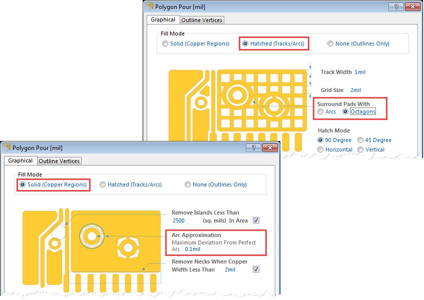

    Thanks for sharing. Best solution I can find up to now is delete the polygon and replace with a number of smaller ones (I tried 8 horizontal strips). You can safely overlap to create one large seamless copper area because the polygons are all the same net and set to cover same net objects. This seems to improve things from several minutes to 10 seconds or better.
  • e14softwareuk
    e14softwareuk over 8 years ago in reply to e14softwareuk
    Another hint that seems to speed up operations considerably to add to the above. If using solid fill try setting the Arc Approximation to a larger value, I tried 0.1mm and this reduced the time from around 10 seconds to under 2 seconds. If using hatched then try using Surround Pads With Octagons rather then Arcs.
