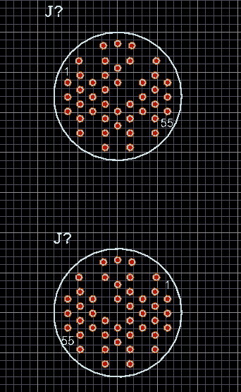

I have encountered a very strange problem.
At first I thought it was  a bug that makes Altium Vault components inconsistent in terms of their footprint when placing multiple instances of that component.
See video below to see what I mean.  D2_1 and D2_2 are the same component, but their footprints appear to be mirror images of one another.
Upon further friggin around I was able to replicate this phenomenon by copying the component, and then pressing the X button when placing it.
See below video for what I mean:
After yet more friggin around, I was able to determine that the erroneous footprint was indeed likely caused by inadvertently pressing the X button during placement of the component by double-clicking on the component and taking a peek at it's Comment's Mirror property.
A couple of things:
  1. How can I figure out which components on my board have had their footprints mirrored using the X and Y placement modifiers?  I see no property that specifies whether the component itself has been mirrored (though there does appear to be an accessible mirror property for the designator and comment).
  2. Why is there an option to mirror a component's footprint in the first place?  I can't think of any use cases for such a feature, and if you don't realize it is happening when it occurs, you are effectively now using an erroneous footprint.
In my case, this error got copied 6 times, meaning that each on of my prototype boards have multiple problems and are now built and faulty.
Not impressed!

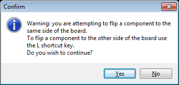

    Sorry to hear about the board problems and thanks for the video. In the video you show the warning dialog when attempting to use the X or Y command
    Are you saying that at some point you could use X and Y without this warning appearing?
    I'm not sure of any automated way to detect such components once mirrored.

    I would vote against removing the feature. it is useful for example using asymmetrical connectors. I created a footprint for a mil s
    spec connector, where to introduce male and female, I had to mirror the footprint. If the option wasn't available, I would have had to create two footprints. manually introducing all these pads with xy coordinates is very tedious... and mirroring saves a lot of time.  as long as a clear warning appears at the time of mirroring, I see no issue, with allowing this feature. perhaps removing the hotkey would aid in preventing accidental flipping, but it should be an option available through the inspector at least.

    Hi Ricardo many thanks for the use case for mirroring. Although a suggestion was logged with Altium for removal it did not look likely to happen because of the big warning message that is given if you try to use this feature. Sounds like the current situation is the best compromise - the feature works but generates a warning when used.

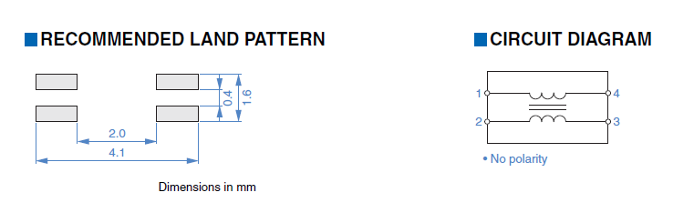

    One other component where this is maybe helpful (I say may be as pin swapping pairs is probably the correct way) is common mode chokes, which have a land pattern that can be swapped either way.
    While I use this type of part I don't think I've had need to resort to flipping the footprint to improve routing as I try and make sure the schematics consider the layout. But it could be useful to flip in some cases?
