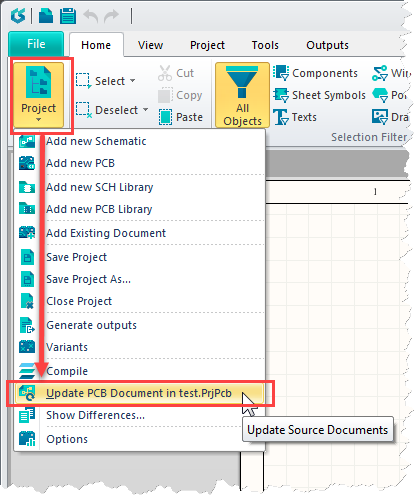

I feel kind of dumb, even being a noob to the software. I cannot figure out how to update my PCB document. I added a component to my schematic but I just keep clicking through the menus trying to figure out how to get the footprint/component to show up in my existing PCB document.
I saw where I can view differences, which it shows one component and two nets, but I just don't know how to push the changes to the board

    CircuitStudio does take a little getting used to but so does any of the CAD packages and some have a much higher learning curve. To update the PCB from your schematic use the Home | Project menu option as shown below.
