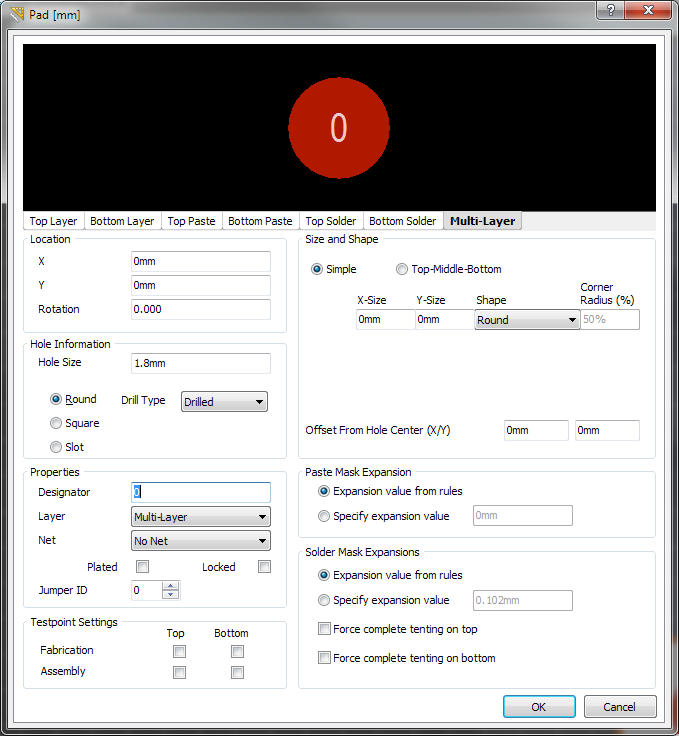

I'm evaluating circuit studio and trying to make a footprint for this switch: LS12-Side-press type-Tactile switch | CITIZEN ELECTRONICS CO.,LTD.
As seen the land pattern requires two mechanical through holes that are not electrically connected anything.  What's the best way to add a hole to a footprint in circuit studio?  I've tried using the polygon pour cutout with the board cutout option selected, but I can't figure out how to do a round hole and when I view the footprint in 3D it doesn't appear to render as a hole at all.

    For the hole just add a pad that's not plated and no copper, for example:
    which is from a power connector I made:
    (I can't comment on odd pad shapes as I haven't had to do that yet.)
