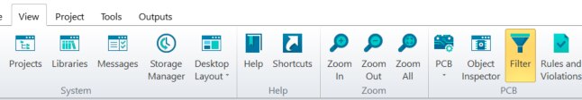

    To the original poster; you can use the View tab and PCB Filter to enable the filter selection window.
    Then choose Object as Text and Layer as Silkscreen Top or other layer.  <Sigh, layer name should match the actual layer name of Top Overlay in this window>
    This would let you separate tracks and lines from the text on legend or assembly layers.
    Now, there is something that confused me a bit at first.  You cannot simply mouse drag select the text.  You need to hold the CTRL key down and drag select.  Other objects seem to work differently so you may need to experiment to see what works using drag with SHIFT or CTRL.  I suspect it is related to whether they are objects on the layer in the PCB or are on the layer but are associated with a component (that is they are not free objects).
    Then you can use the Object Inspector window to view and edit the individual parameters you want; change font, size, etc.
