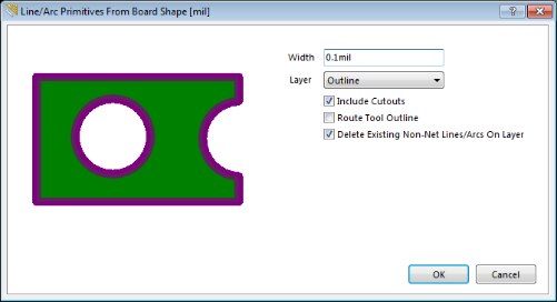

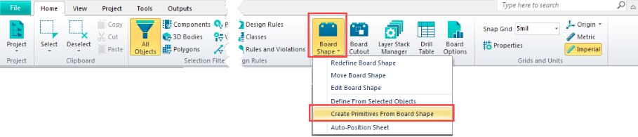

Step #1: Run Home | Board Shape > Create Primitives From Board Shape
The layer you save the primitives to should be a spare layer not currently used for anything else. It is easiest to select Delete Existing so that you can easily select the generated primitives when re-creating the board.
Step #2: Import your DXF data.
Step #3: Restore your board shape by selecting the primitives from the first step and then running Home | Board Shape > Define From Selected Objects. To make it easier to select the primitives you can going into single layer mode with View | Single Layer Mode, select the Outline (or other layer used for saving the primitives) as the current layer (bottom tabs in editor window) and then selecting all items on the layer with Home | Select > All.
