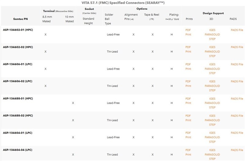

I was trying to make a breakout board for the Xilinx ZC702 and specifically to be able to utilise the FMC pinouts. I believe the board uses the Samtec ASP-134603-01ASP-134603-01 Low Pin Count (LPC) connector but looking at their website I am uncertain what the mating part is. I've narrowed it down to ASP-134604-04 or ASP-134606-04 (the leaded option rather than lead-free) - the difference is described as:
VITA Standards specify configurations for the SEARAYTm High-Speed Array VITA 57.1 FPGA Mezzanine Card (FMC) connector in 8.5 mm and 10 mm stack heights.
But I cannot work out what that actually means and which I should buy. Any advice would be appreciated.

    As an update:
    I had also contacted Samtec.com and they have explained that the stack height is the distance between the two boards when the connectors are mated together...which is so obvious now. I could opt for either but the closer 8.5mm could mean my board fouls on ZC702 components and therefore the 10mm clearance is recommended, which is ASP-134604-04 (leaded) or ASP-134604-02 (lead free).

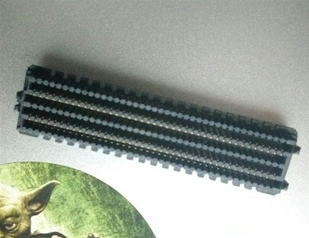

    14rhb over 7 years ago in reply to 14rhb
    And here is the new connector, which fits my ZC702 FMC LPC connector....time to crack on with the Logic Analyser.
