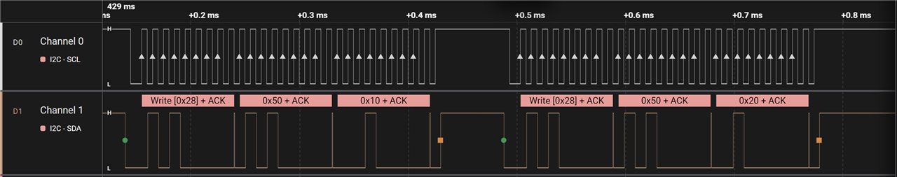

    I just tried out my $9 Logic Analyzer that the software has an I2C Analyzer - I am blown away (Amazon Title "1 Set USB Logic Analyzer Device Set 8 Channel 24 MHz UART SPI Debug Logical Analysis Device…

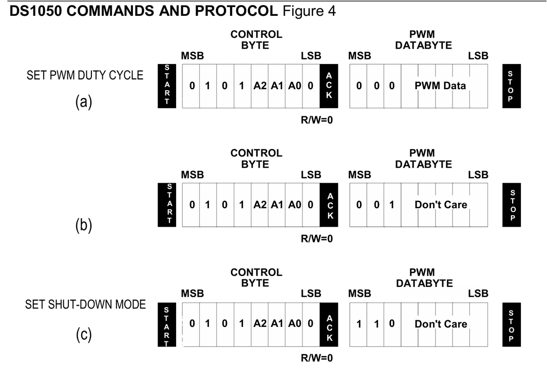

    Perhaps I’ve missed something but you are sending 0x20 as data which is 0b00100000 but the data byte only allows for 5 bits (which are all 0).  If you look at page 11 of the data sheet, sending 0b00100000 tells the device to ignore the data bits (it’s effectively a NOP command). What is the data value you are actually trying to send?

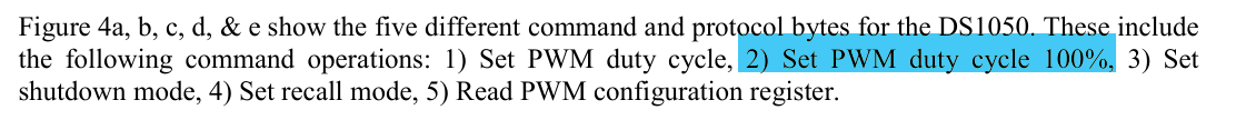

  • beacon_dave
    0 beacon_dave over 1 year ago in reply to Andrew J
    0x20 is the command to "Set PWM duty cycle 100%"
  • Andrew J
    0 Andrew J over 1 year ago in reply to beacon_dave
    Ah ok, makes sense.  That is shown in the logic analyser output so it looks like all is working.

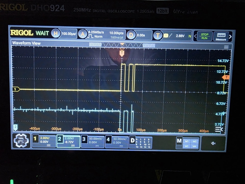

  • beacon_dave
    If you look at the scope trace, it transitions from 50% to 100% as per the commands but then after around 450us it transitions to 0%. The logic analyser capture stops before it transitions to 0% so can't see if there was another command sent or not to cause this.
    Trace 2, cyan, shows the start of something that coincides with the drop from 100%.  Is it reasonable to assume the two are connected, trace of SCL perhaps?  I expect the LA trace was taken at a different time to the scope trace but it would be useful to see it synchronised across the problem.  However, it would be good  for the OP to come back with more info as to what he/she expects to see.
  • dfansler
    +1 dfansler over 1 year ago in reply to Andrew J
    Hi Andrew and Dave - thanks for your comments.
    The cyan trace is in inverse of the yellow trace - my motor controller requires two PWM signals that are the inverse of each other.
    I see the problem now - when you look at the data sheet on page 11, the first command (a) is to SetPWM, the second command (b) has no label and I thought it was a continuation of the SetPWM command, since the rest of the commands have labels!
    I dropped the second command and all is well - the PWM works as expected.
