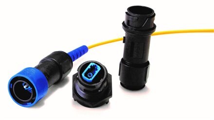

Instead, a much better approach is to specify a rugged LC connector that is specifically designed for harsh environments. For example, Bulgin’s 4000 Series Fiber connector is the smallest sealed standard interface connector on the market. The fiber connection is UV resistant, salt spray resistant and sealed to IP66, IP68 and IP69K, while still providing an industry-standard LC interface as specified by IEC 61754-20.
The connector and its housing can be completely immersed in water up to a depth of 10 meters, for a period of up to two weeks (based on IP68 rating tests), without allowing water to gain access to the conduit and hence potentially to freeze and damage the fiber. The connector can also handle temperatures from -25 to +70c and protects the fiber against dirt and dust.
4000 Series Fiber Simplex Connector
4000 Series Fiber product code: PXF4050
