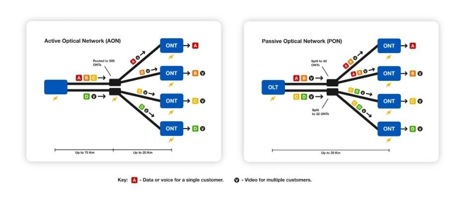

There are two common ways this problem can be solved, both based on the principle of splitting the signal, so that each fiber from the central office in the network’s core is shared between multiple end users. The two methods are called Active Optical Networks (AON) or Passive Optical Networks (PON), and in both case the split into individual fibers for each user happens fairly close to the customer; within a few kilometres at most.
The key difference between AON and PON is how the signal is split between the multiple fibers going to each customer. AONs use active, electrically powered devices to direct the appropriate signal only to the relevant customer. Ethernet is commonly used, and a switching device will typically route signals to up to about 500 customers.
In contrast, a PON uses optical splitters, which require no electrical power, to send the signal to each customer. Each switching cabinet can handle up to 128 end users. You can see in the diagram that each customer also receives signals intended for someone else, so encryption ensures privacy is maintained. For upstream signals sent back from customers, these are combined into one signal at the switching cabinet, typically using Time Division Multiple Access (TDMA). The PON also uses wavelength division multiplexing (WDM) to carry both upstream and downstream traffic over single mode fibers.
Benefits of each approach
PONs have a number of key advantages; for a start, because they don’t require electrical power for the splitter, they have lower installation and operating costs than AONs. They also use less energy, and less network infrastructure, than AONs, and are highly reliable. Compared to the copper wiring that is being replaced by fiber, using PONs means the fiber is smaller, easier to manage, and more secure than the legacy cabling it replaces.
On the other hand, AONs enable the fiber ‘last mile’ link to operate over longer distances than with a PON: typically, up to around 70 to 100km, compared to about 20km for PONs. Troubleshooting and finding a problem is easier with AONs than with PONs, because each fiber is carrying signals dedicated to one customer. AONs also don’t suffer from the drop-in speeds that PONs experience at peak times, due to multiple customers’ traffic being sent down each fiber.
