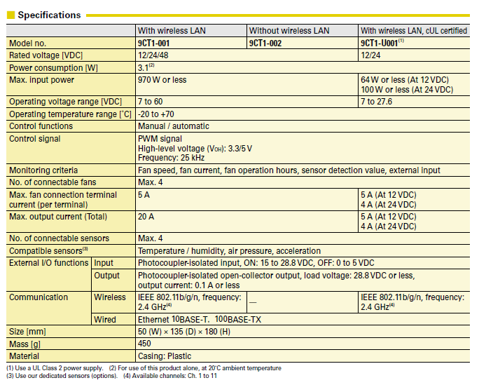

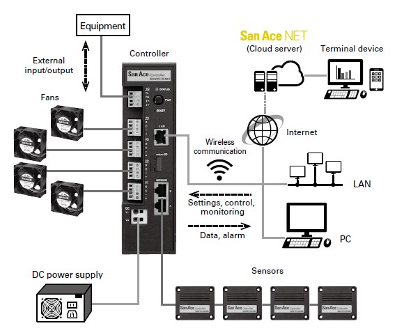

The new 9CT1-U001 IoT enabled fan controller from Sanyo Denki can remotely monitor and record the status of up to four fans in a cooling system and can use its network of remote sensors to measure the enclosure's temperature, humidity,  and air pressure whilst the accelerometer can monitor g-force in the system across 3 axes. These measurements, which can stored in the cloud can be used to optimise the thermal management of  the cooling systems by remotely controlling the speed of the fans. The operating data recorded includes cumulative fan operating time, any alerts set by the system and the history of the data on temperature humidity and pressure measurements. This data can be used to prevent overheating problems in the equipment, and this can contribute to reduced maintenance costs, improved energy consumption and insight into the need for maintenance of the cooling system.

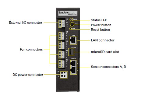

The IoT controller unit front panel layout and the connection ports arrangement is shown below:
Front View
System Configuration
Download Full product data and the details of the Graphical User Interface here
The optional sensors for the IoT controller are also available from Farnell /Element14 and include:
9CT1-T   -  Temperature and humidity sensor
9CT1-P   -  Air pressure sensor
9CT1-A    - Accelerometer sensor
