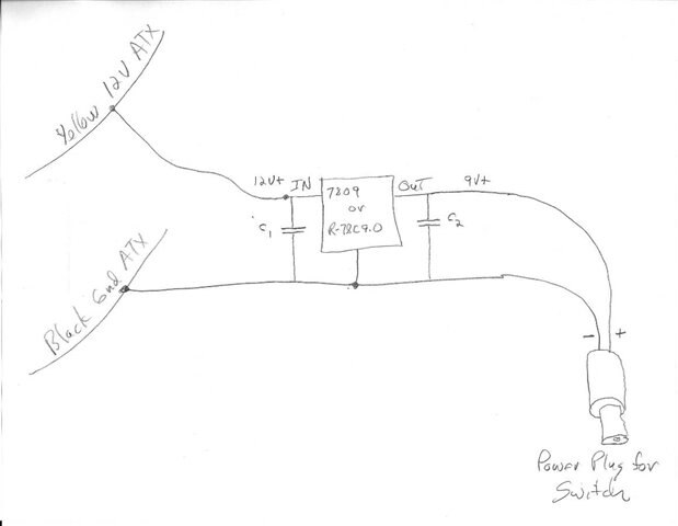

    0 jw0752 over 11 years ago in reply to ats1995
    Hi Aslak,
    Here is the schematic in case it will help clarify.
    • Reject Answer

    0 ats1995 over 11 years ago in reply to jw0752
    Thanks a lot! Just one thing. What is the "c1" and c2"?
  • ats1995
    These are the Decoupling capacitors for the different regulator/converters. For the 7809 C1 will be about 0.1 uF and C2 can be about 10uf. For the R-78C C1 should be about 22 uF and C2 can be 100 uF. The voltage ratings on the capacitors should be at least 25 volts DC. The data sheets for the part you decide to use may give slightly different recommendations. You probably can't go too wrong using their recommendations.

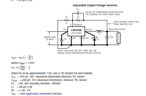

    Hi Aslak,
    the LM 2596 does not come in a fixed 9 volt unit. You can get a variable version but then you will have to install external resistors to set the output voltage at 9 volts.
    Here is a schematic for the LM 2596 that I got from the data sheet that shows how to calculate the value of the resistors.
    Here is a link to the whole data sheet.
    http://www.ti.com/lit/ds/symlink/lm2596.pdf
    Because it comes prepackaged at 9 volts and doesn't need a lot of peripheral support I still think the Recom R-78C9.0-1.0 is the best. In lieu of the R-78 you might check ebay to see what is available in an inexpensive DC to DC adjustable converter. I do not know if you have access but I have purchased some good little converters from China for less than $5 US.

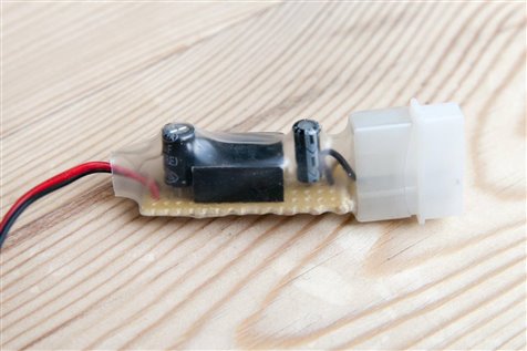

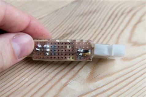

    I hope a late reply is a lot better than no reply:
    I ended up using a R-78B9.0-1.0. From the info I found it was very similar. It works without a problem. I measured the output voltage on the original wall adapter. It was at about 9.5v! I guess that makes the R-78B9.0-1.0 overkill in terms of accuracy, but it's too late to change.
    A friend of mine is a lot more experienced in soldering, so after doing it myself with a standard DIY PCB. He recommended me to redo it with a stripboard (as shown in the picture. More pics at Switch in computer casemod - Album on Imgur ). I think it ended up perfectly. Measuring the output confirms that (reading 9.04v).
    Thanks a lot for the help! I learned a lot.
    Aslak
    Hi Aslak,
    I really enjoyed the results that you posted and the pictures were great.
