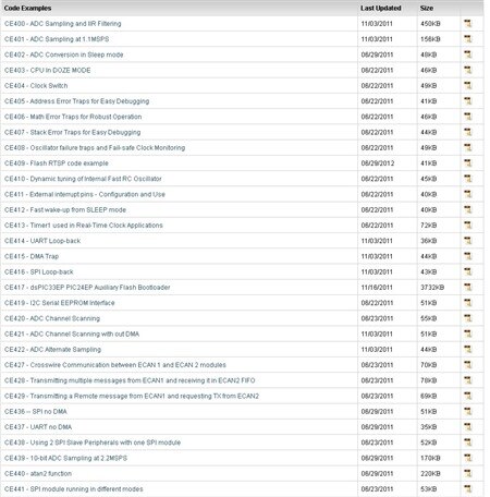

    Im using PIC24EP512GU814 a 16bit controller, im very new to this 16 bit controller. and what my doubt is, i cant able to identify the TX and RX pin of UART. but it having 4UART's. In the Pin out diagram i found PPS(Peripheral Pin Select) from that we can modify the IO's, but still i cant understand which pin is used for TX and RX. could you help me to identify the Pins of UART.
    Thanks in advance,
    Anboli.C
  • MicrochipRTCfr
    MicrochipRTCfr over 13 years ago in reply to e14 Contributor
    Dear Anboli,
    Most of the Microchip 16bits products have "PPS" Peripheral Pin Select which allows to connect digital I/O pins to digital peripherals by programming (like an FPGA).
    So at reset, the internal peripherals are not anymore connected to pins ;=)
    You have to program how they should be connected. This is very flexible. You can even dynamically change connections while the micro is running !!!
    Of course this is not so easy to do the first time, this is why there are many code examples.
    At first, I suggest you read the Family Reference Manual related to PPS for your PIC24EP512GU814.
    Then, to save time use the code example which shows how to setup registers to map I/O to/from peripherals.
    In fact most digital peripherals will need to setup appropriate pins so any code example using a digital peripheral will have code to do that.
    Go on the page of the PIC24FJ512GU814 and look for the code examples :
    Have fun with PPS ;=)

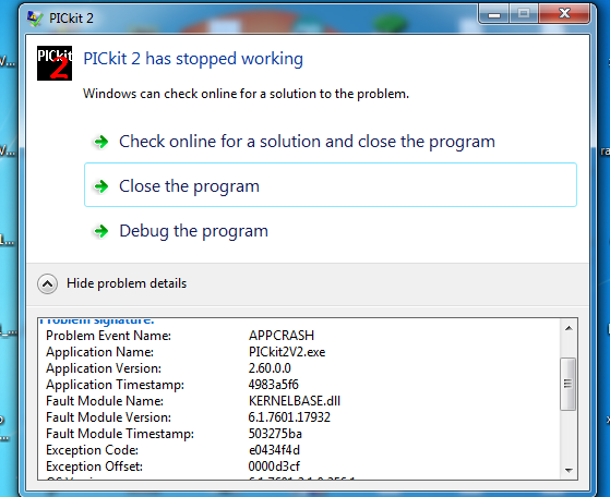

    Hi,my pickit2 crash when I try to start him,my OS is W7 and the pickit2 it works fine about couple years until now.I check the pickit2 with the same windows installed on another hdd and works fine,so pickit2 its ok,I guess is something wrong with detection or what,in Device Manager appears HID when I connect the pickit2 to USB.The error that i received from windows is "Pickit2 has stopped working".

    Hi,
    If your Pickit2 is detected as HID device it means from PC side it is OK.
    The error message you see can be due to lots of different reasons but the number one is that there is some issue on your hardware side.
    1/ wrong ICSP connections
    2/ wrong PIC reference selected
    3/ incorrect reset circuitry
    4/ damaged ICSP on pickit2
    5/ unsupported PIC
    Best is to test the same hardware on another machine to make sure board + pickit2 are fine.
    Using some tools like USBdeview you can remove the Pickit2 driver and plug it back so that it reinstalls
    Which SW do you use ?
    Pickit2 is a very old tool which has been released to open source community. It does not support lots of recent PICs. You may want to consider to buy the successor Pickit3 which supports are PICs ;=)
    regards
    e14 Contributor over 12 years ago in reply to MicrochipRTCfr
    I explain wrong the problem,I apologize.
    The GUI is the problem,won't start,the GUI should start even the Pickit is not connected to PC.I suspect Visual C++ library or NetFramework.
