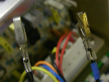

    A piece of kit has been built for us and they used a wrong type of crimp terminal in one of the connectors which I believe is Molex (it's marked MX and looks like one from the KK series). I'm having trouble locating a replacement terminal and having looked on Farnell I wonder if it's type 08-50-0106 (101-3097)or 08-50-0108 (1012346) but the cat ear version? Even though the drawing on Farnell doesn't look quite the same.
    Please can somebody suggest where I can get a replacement from, it's the one on the right and the wrong one is on the left.

    MolexConnectors over 16 years ago in reply to e14 Contributor
    Hi Richard.  I was able to confirm that the terminal at the right of your image is a TrifurconTm terminal.  Depending on the wire size gauge,plating, and packaging, you have about 12 different part numbers to choose from .  You can view the list of parts here: http://bit.ly/dvAAPB and then you can order samples from us if available or if you need to purchase them you can check Farnell's stock.  Please let us know if you have any more questions.    Thanks.
