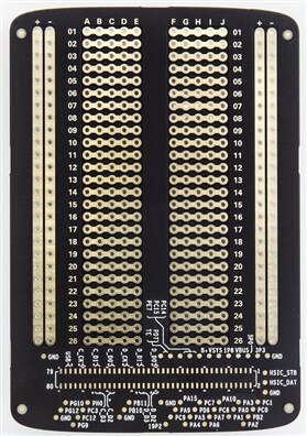

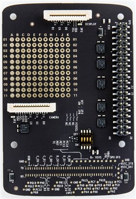

Moto Mods Development Kit (MDK)
  • Contains MuC and Moto Bridge
  • Integrated battery and charging circuit
  • Perforated Boards enable flywired projects
  • Personality Cards provide hardware to go with the examples, including released schematics
  • 80pin interface allows easy swapping
  • USB Ports for Serial Wire Debug/Console, power, data, and MyDP
MDK Users Guide
http://developer.motorola.com/build/mdk-user-guide
Perforated Board
http://developer.motorola.com/build/mdk-user-guide/perforated-board
HAT Adapter Board
http://developer.motorola.com/build/mdk-user-guide/hat-adapter-board
