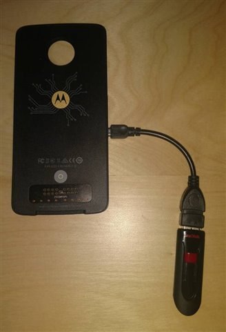

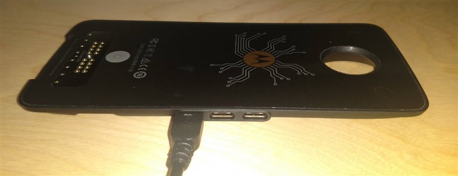

Attach your USB 2.0 Device
  1. Plug your USB device into the OTG adapter
  2. Plug the OTG adapter into USB #3 (the bottom and only microUSB port on the MDK)
Note: USB 2.0 devices can also be used through the USB #2 (TypeC middle port on the MDK).  You will need a TypeC OTG cable.  When using the TypeC port for USB 2.0, set A4 to ON and all other dip switches OFF.
Really Note: The TypeC port does not auto-swap.  If things should be working but aren't, try flipping the cable over.
