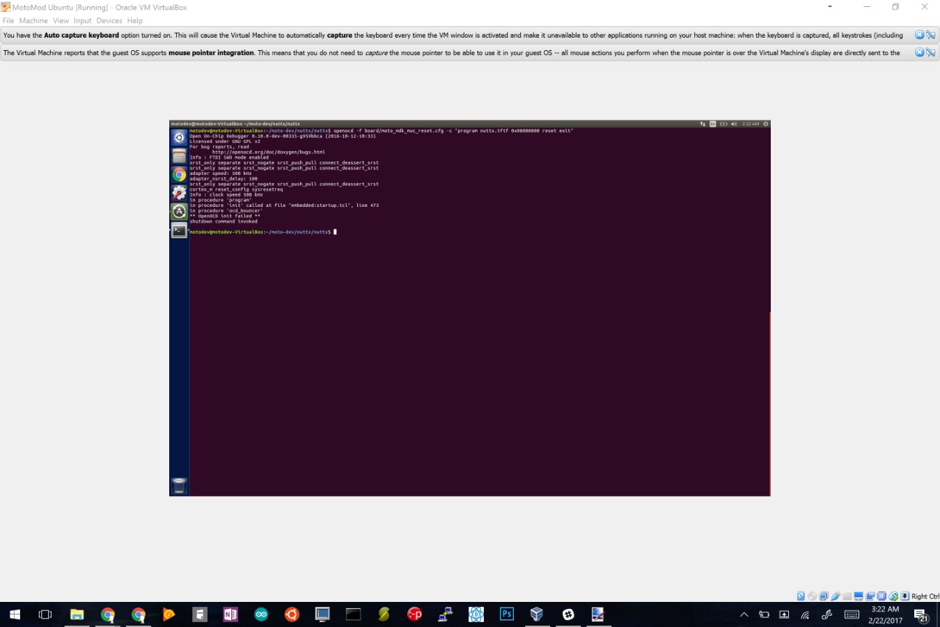

Not sure if I bricked my MDK... I flashed my MDK firmware using MDK utility with a tftf file I just built, however now whenever I attach the mod I get a notification on my phone saying "The Moto Mod can't connect and isn't working. Try attaching it again". I can't upload over openocd either, I get something about error code -4. I might just have openocd misconfigured though as I've never used it before this. Has anyone gotten any of these errors before or know how to flash the MDK without it responding? Thank you!

    Did you switch to Developer Mode before flashing (although flashing should not be allowed unless you did)?
    Did you ensure you're using VID=0x42 in the firmware you built?
    As for openocd, really need to see the exact error message.  I have a guess, but I'd like to see the error (and double check on my setup).
    The good news is, since openocd is Serial Wire Debug you really can't brick your MDK.

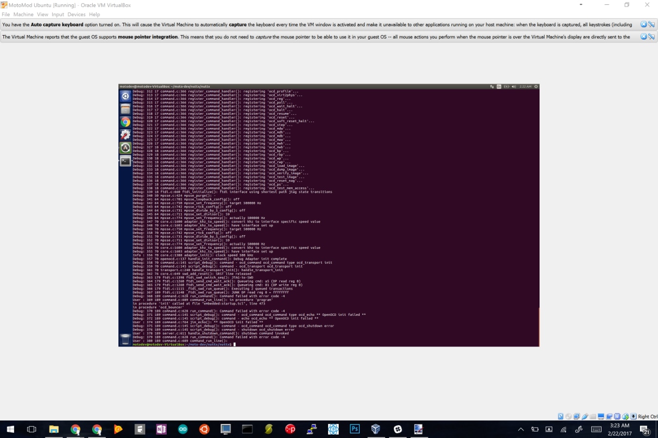

    Thanks for the response. I'm definitely using VID 0x42. I've attached screenshots of OpenOCD's output. The first image is running the command to flash it, the second is running the command again with the "-d 3" option which shows a little more information about the error.Any thoughts? Also, good to hear that it's not brickable haha.

    Christian, I am seeing the EXACT same issues with my system that used to work.  Previously you helped me get usb2 working on my two MotoMods.  Today I did a git pull on anything that needed it and rebuilt everything for compute (so I can do USB3).  Now I error out just like Andrew.....
    This is a setup that used to work, the only difference is that I grabbed the more recent updates.  I verified that my system is seeing the FTDI part when it is plugged in, so it isn't like it is dead or something....
  • garengllc
    garengllc over 9 years ago in reply to garengllc
    Some more information.  I tried rolling back my nuttx and muc-loader to the hashes from the end of JAN and rebuilt, but that didn't seem to do anything.  I tried different USB cables, no dice. I tried with and without the protocards, no dice.
    The error that get printed as debug: "_ftdi_swd_run_queue(): JUNK DP read reg 0" seems to mean that there is a bad connection (though I am not sure why that would be).
