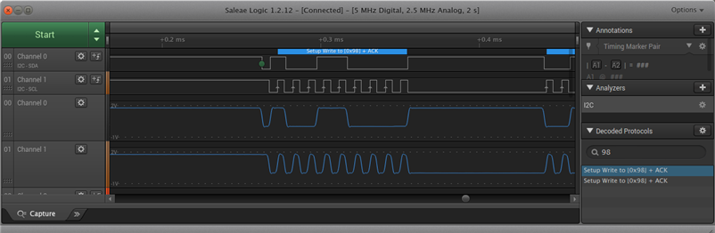

    Thanks Michael, I double-checked my settings and took another trace this morning.
    Blurry, but this is the `write` to an address set in menuconfig as 0d76 (0x4C).
    SCL is the second trace, counting bits shows address (TX'd MSB-first) 0b1001100 + 0 at the end for a write operation. That is 0x98...

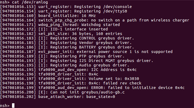

    Ramlog Shot - (ignore tfa9890, I am re-writing the previous tfa9890 driver)
    You can see the driver echoing the i2c_addr as 0x4C.
    Thanks again.

    The I2C bus is right. The traces I took were captured from the  PCM5142's SDA and SCL pins. I can see the STM32 sending the i2c commands and the PCM responding.
    This is mostly just trying to figure out why the Address is set in Menuconfig to 0d76 (0x4c), but what is actually sent is a 0x98.
