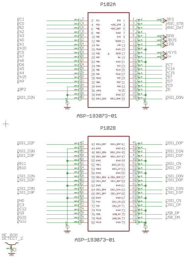

    Just a very quick question I have about some of the pins.
    I have the following pin outs to connect to the Stereo decoder.
    BTB Pin IDIdentificationCorresponding pin (UDA1334A)
    3P3Regulated 3.3-volt, 500mA power source (see note 1)Vin
    GNDSystem GroundGND
    PC15Master_I2S_WSWSEL
    PC14Master_I2S_BCLKBCLK
    PD7Master_I2S_SDODin
    GNDSystem GroundAnalog Ground
    I don't think that any of the SysCLK, Mute, DEEM, or PLL since they all have default values that are used.
    However, the SP0, SP1 signals may need to be altered. They are automatically drawn low for I2S but may need to be altered for LSB Signals. I doubt that I will need this though.

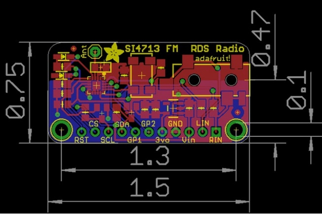

    I have the following pin outs to connect to the FM Transmitter:
    BTB Pin IDIdentificationCorresponding pin (Si4713)
    Lout from Stereo DecoderNo Identification. Passing a wire from the stereo decoder to the FM transmitter.Lin
    Rout from Stereo DecoderNo Identification. Passing a wire from the stereo decoder to the FM transmitter.Rin
    3P3Regulated 3.3-volt, 500mA power sourceVin
    GNDSystem GroundGND
    PA9MuC_GPIORST (Reset toggle)
    PA4MuC_SPI1_CS0 (ONLY if I have to wind up going the SPI route.)CS
    MuC_PB11MuC_I2C2_SDASDA
    PB10MuC_I2C2_SCLSCL
    This is my Current idea. I have looked at this in many ways, and I'm now trying to configure nuttx to work with the given ships on the board.
    If you have any observations about this design, especially with regards to feasibility, PLEASE let me know.

  • motomodsdev
    motomodsdev over 8 years ago in reply to krobar14
    To be clear, you aren't routing the i2s signals to the MuC.  So you're not actually going to PC14, PC15, or PD7 on the MuC but instead are pretty much raw i2s lines that the Moto High Speed Bridge combines, and then expands back out on the Moto Z side.  That said, your pin selection makes sense, although the UDA1334A spec implies that SYSCLK is necessary.  Please note that pin 36 on the 80-pin connector can be used as a 19.2MHz output.  Not entirely sure what you're referring to with the SP0 and SP1.
    PB10 and PB11 seem like good choices for talking i2c to the FM transmitter, it should be very easy to configure those pins as well as your reset output.
    One final note would be that the MuC runs at 1.8V logic level.  You'll either need level shifters to bring it up to 3.3V, or you can use the Pi HAT Adapter which contains shifters to the 3.3V level.

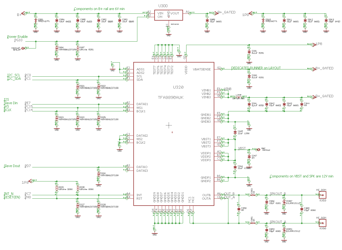

    This is the Audio Amplifier for the Moto Mod personality card for the audio speaker mod. I'm trying to find patterns between the inputs that are shown between the two modules.

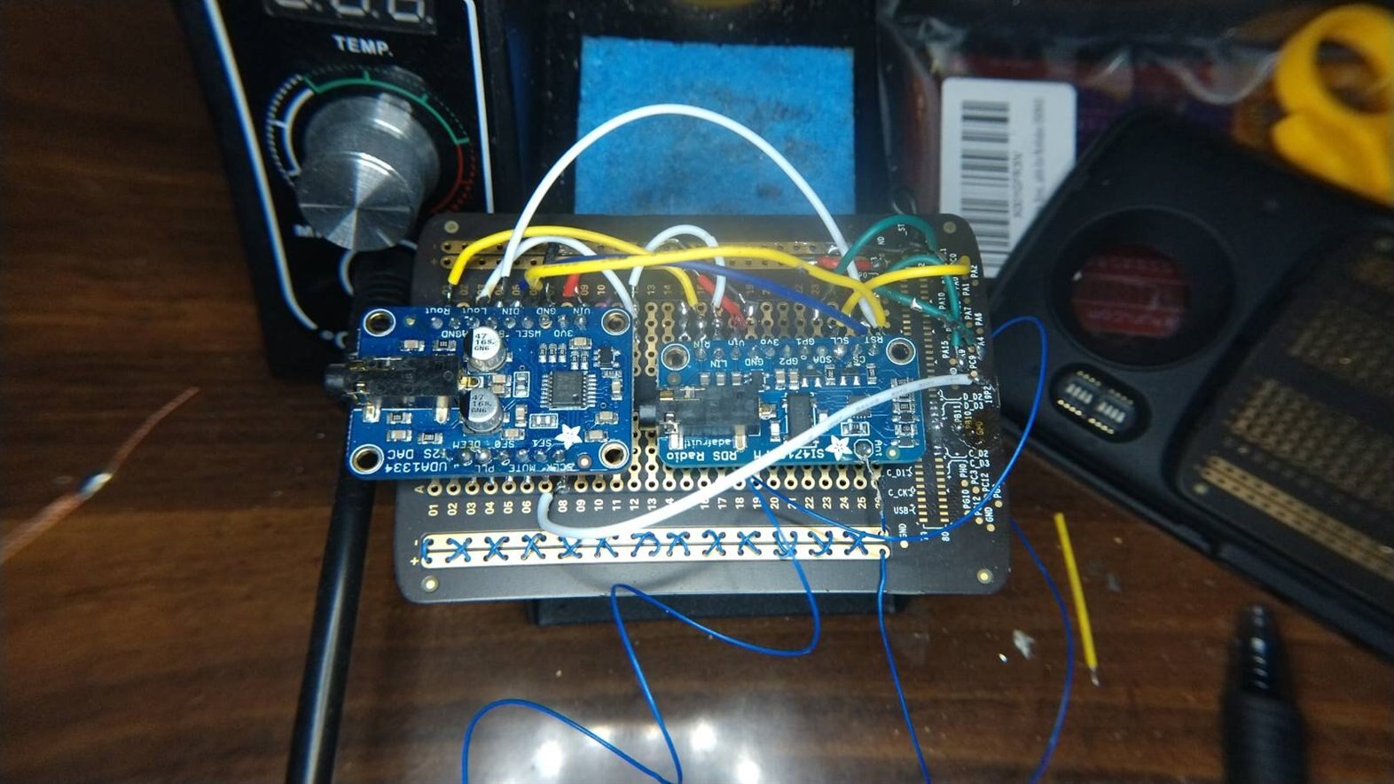

    Major update to the project. The board is soldered. I'm not the best at soldering, so it took me a few hours to do this.
