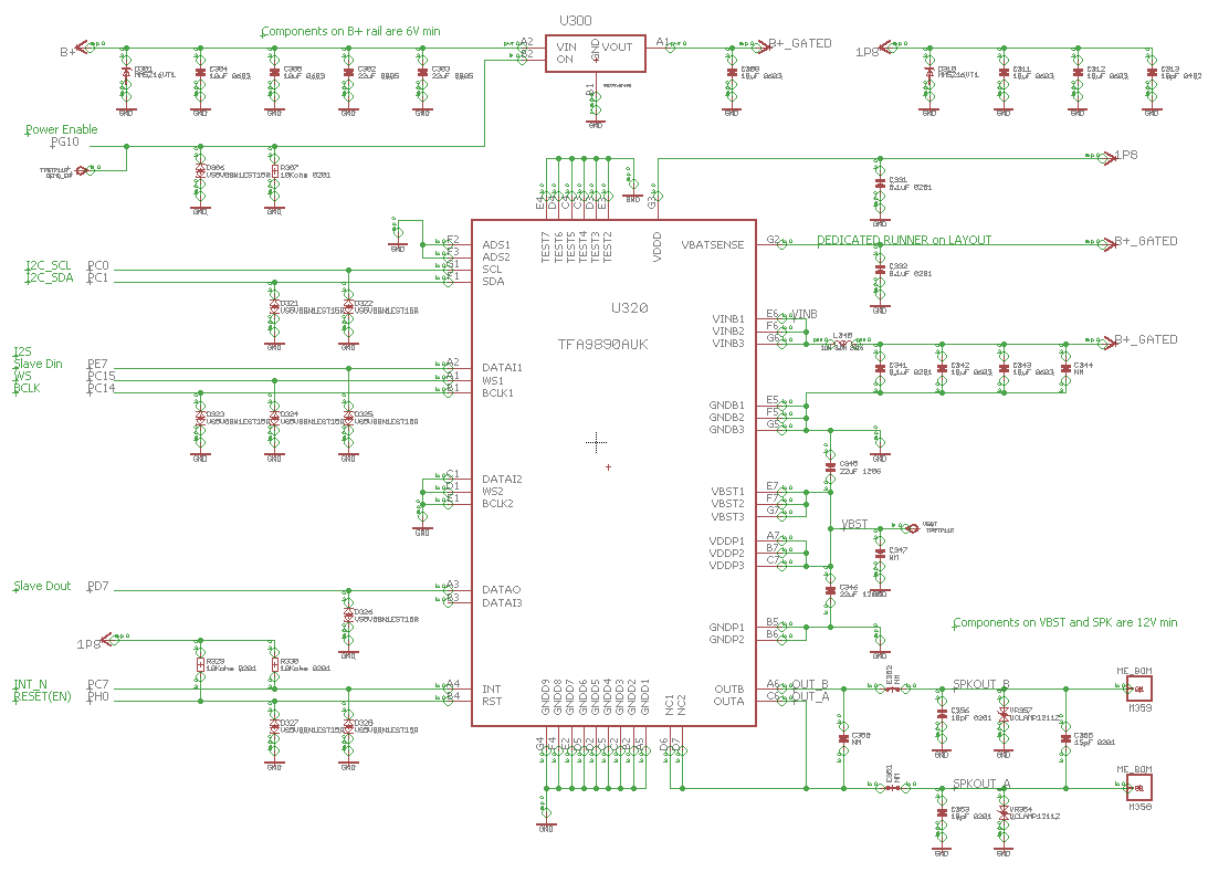

    I've decided to switch to using PC0 and PC1 for SDA and SCL. This corresponds more with the Audio Mod
  • krobar14
    krobar14 over 8 years ago in reply to motomodsdev
    This is the Audio Amplifier for the Moto Mod personality card for the audio speaker mod. I'm trying to find patterns between the inputs that are shown between the two modules.

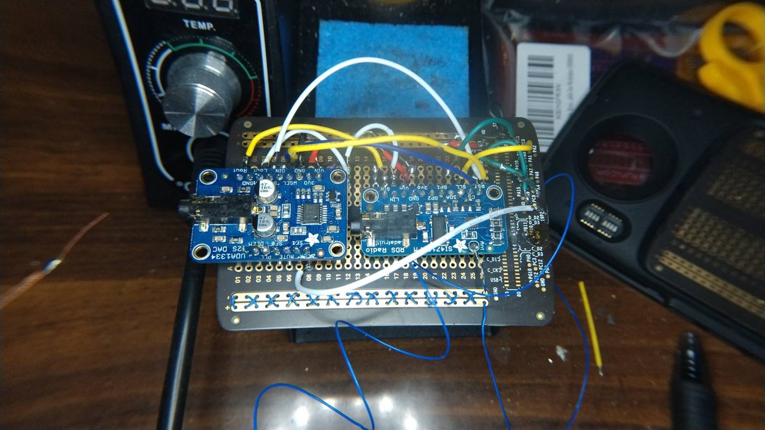

  • krobar14
    Major update to the project. The board is soldered. I'm not the best at soldering, so it took me a few hours to do this.
