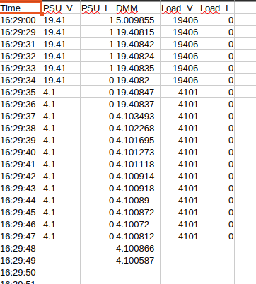

PSU output characterisation / load regulation Set the PSU to a target rail (say 5 V / 2 A on CH1), put the DC Load in CC mode at a series of current steps, and watch the PSU's actual output voltage in the live chart. The load current readback and PSU voltage readback are plotted together, so you can see how much the rail sags under load without manually writing anything down. Export to CSV and you've got a load-regulation curve.

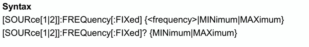

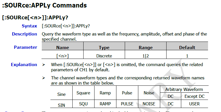

    Were you able to find a programming manual describing the SCPI commands for the MP750513 ?
    I couldn't  - although I didn't spend very long looking.
    MK

  • michaelkellett
    michaelkellett 5 months ago in reply to mayermakes
    Slightly hard to help because I don't have the generator so I'm flying blind, but looking at the video at 4:53 I see:
    Looking at the manual for a Rigol DG1000Z SOURCE works like this:
    Focus on this bit:
    It looks to me as if when you use the short form command for (for example) FREQ you can't specify the channel.
    So you will need to modify the driver so that you can set the target channel and then change frequency (etc)  using:
    SOURCEN:FREQ X
    where N is the channel
    I think you might well be able to download Rigol manuals which could be helpful.
    MK

    shabaz 5 months ago
    I think you've got artificial smoothing enabled in the charts (I recognize it from that chart style because I've encountered it before), it makes voltages or other signals appear to have levels that were not there in reality, e.g. the little rising humps before the level goes low, and then the little negative dips immediately afterwards, were probably not real. It's an annoying side-effect from some of these chart libraries examples/default settings. They tailor the examples to look nice in online demos, but are not practical.
    Perhaps it's best to get rid of the smoothing (I feel anyway), otherwise people may assume a PSU is going beyond what it was set for, or a voltage was measured that the source equipment never generated.
  • mayermakes
    mayermakes 5 months ago in reply to michaelkellett
    https://github.com/mayermakes/MP750513_python
    that worked!! thanks for the valuable tip! alrready tested and merged in the driver repo + Lab_UI repo.
    I also updated the demo to use channel 2 as well.

  • mayermakes
    mayermakes 5 months ago in reply to shabaz
    indeed the chart shows bumps , but the actual data points recorded do not. this seems to be a quirk of the chart lib as you say.
