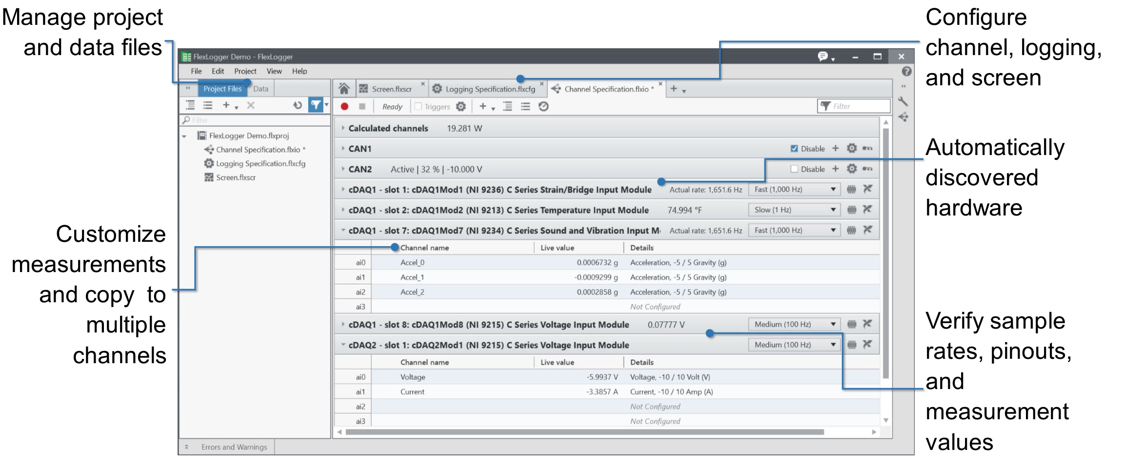

FlexLogger is application software used to build customizable, scalable data-logging systems with the wide breadth of CompactDAQ hardware. Use FlexLogger with CompactDAQ to acquire analog measurements like temperature, pressure, voltage, strain, and force along with CAN messages. This means that you can use FlexLogger to acquire, view, and log all test data to a single file. You can also customize screens to view and alarm the most important measurements before and during a test. The FlexLogger user interface gives you ways to manage project and data files, configure and customize measurements, view hardware information, and verify your data.
Figure 1: View Configured Measurements in FlexLogger
