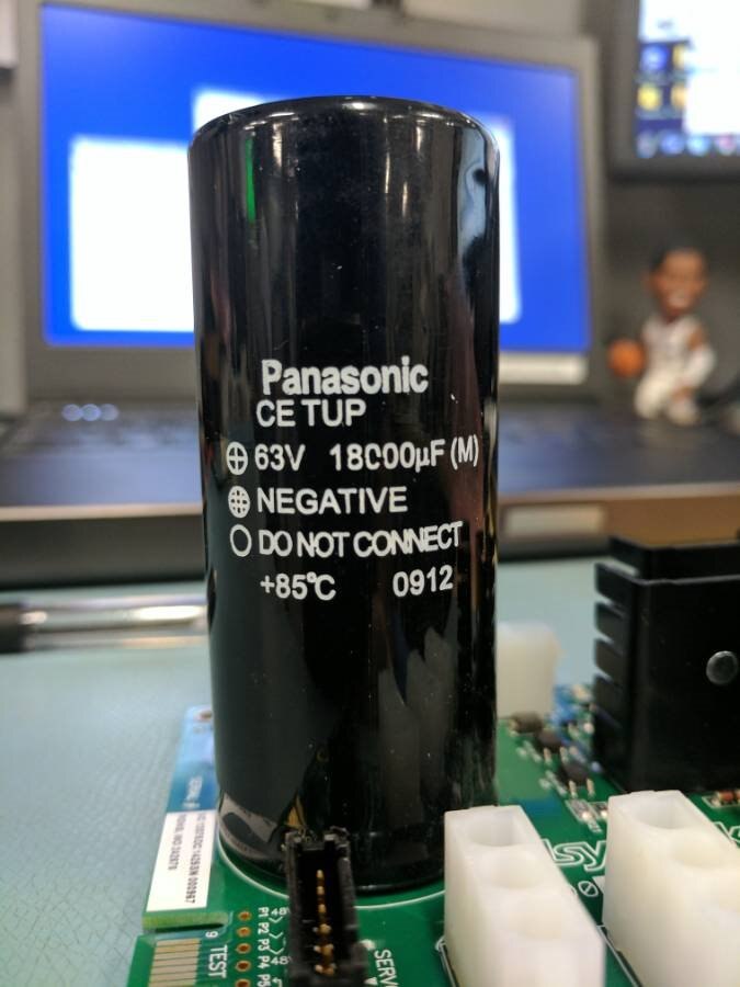

  • ahaustin77
    ahaustin77 over 9 years ago in reply to e14 Contributor
    Hello Hiroshi,
    I have these Panasonic capacitors that have been bulging from the top. Could you help tell me if these are counterfeit or legitimate Panasonic capacitors? Any help would be great. Thanks.image
