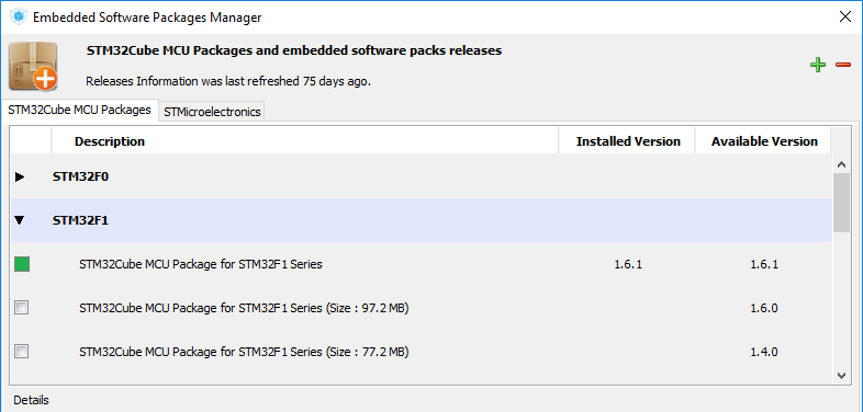

    Rod,
    I've been using CubeMX + Atollic Studio to program a STM32F103. I'm using the STM32 HAL, and it seems to be working fine for me.
    First setup CubeMX by downloading the MCU Package:

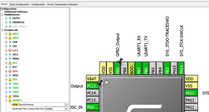

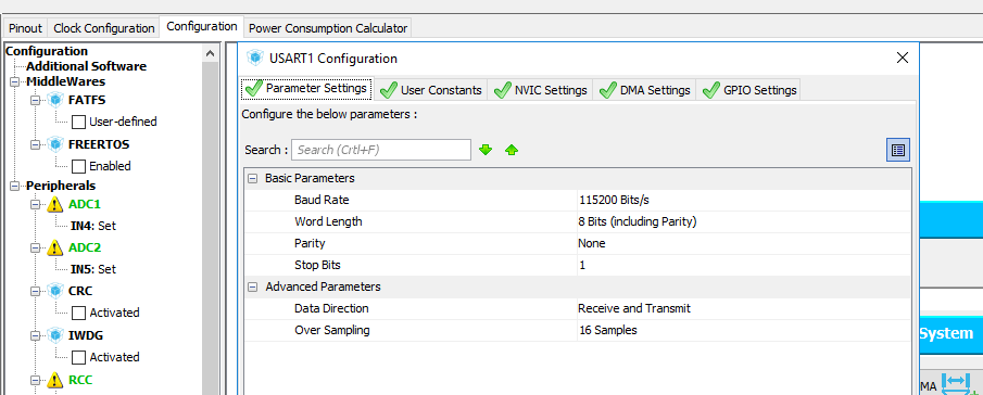

    Create a new CubeMX project, and enable the peripherals you want (let's go with the GPIO & UART):

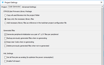

    Go to the 'Configuration' tab and configure the settings:
    This is how my project settings look:

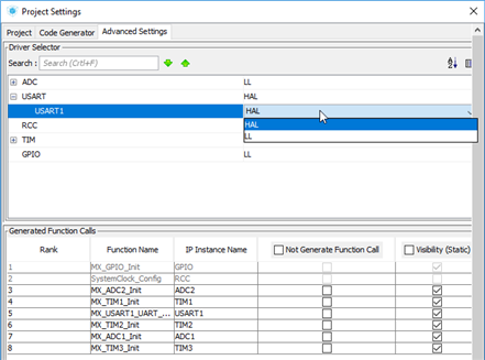

    Note that you can select between the 'LL' & 'HAL'. The HAL is easier to work with due to the higher level of abstraction:

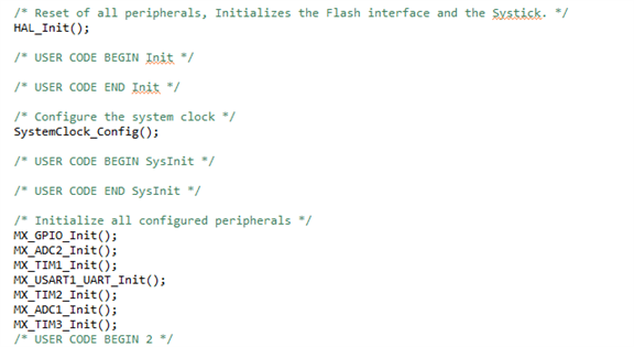

    Now click on 'Generate' source code. It should automatically create/update the Atollic TrueStudio Project, add the initialization code (so that you don't need to manually configure the baud rate, and set the GPIOs to the alternate function i.e. UART) & import the required drivers.
    Launch TrueStudio, and you will see something like this:
    If you open up the those functions, you'll see that CubeMX has already implemented the code required to setup the peripheral.
    To transmit you can try adding this after the peripheral initialization:

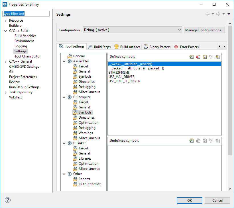

    Regarding the preprocessor macros/symbols,
    TrueStudio > Project > Build Settings > C/C++ Build > Settings > Tool Settings > Symbols (under C Compiler)
    I wouldn't bother with copying files over manually - CubeMX does all of that for you!
    Create a CubeMX project, and add you code between the /*User Code*/ comments. When you want to modify pinmuxing, enable peripherals, or even change peripheral configuration, open CubeMX, make your changes and regenerate the project. CubeMX will not modify anything within the /*User Code*/ braces.
    It's probably easier to start with the CubeMx project, and import whatever code you have rather than the other way around.

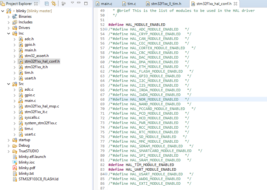

    This is what my project looks like:
    CubeMX generated the hal_conf.h file, and automatically defined the macros.
    Since you're working with an example project, you could try importing the drivers manually.
    The hal_conf.h file also contains a bunch of other defines, and does a:
    #ifdef HAL_UART_MODULE_ENABLED
     #include "stm32f1xx_hal_uart.h"
    #endif /* HAL_UART_MODULE_ENABLED */
    Try generating a new CubeMX project, and look at how the whole thing is structured. I think that you should be able to copy over files from the CubeMX project to your example, and with a little fixing, it should work.

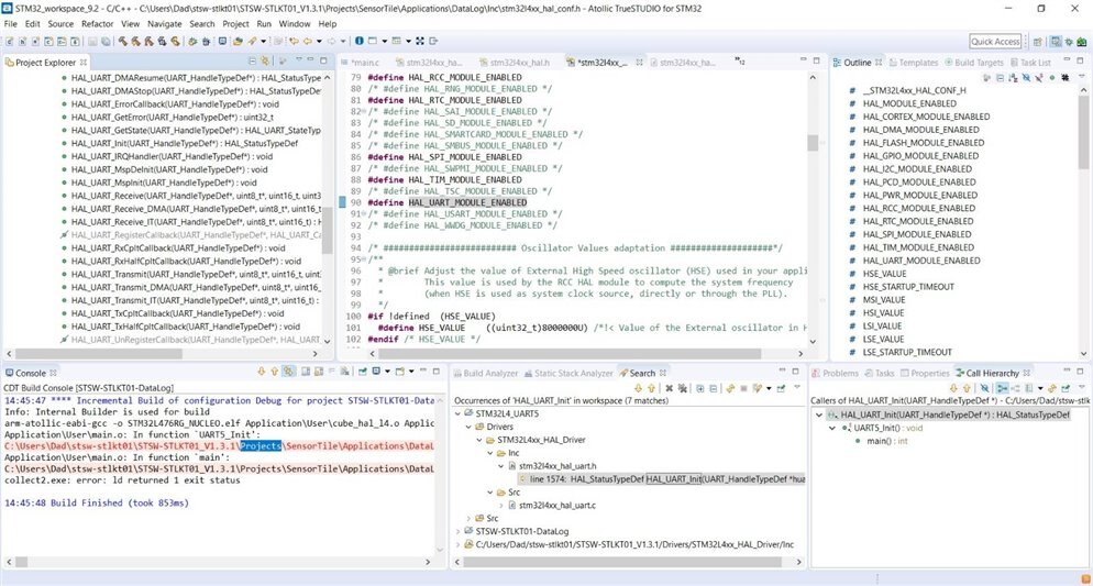

  • 14rhb
    14rhb over 7 years ago in reply to avnrdf
    Good advice, thank you again Avner.
    The more I browse around and try stuff the better I'm getting. I have been in the ...hal_conf.h file and enabled the UART (as in photo below) although that definition never seemed to get recognised in the HAL_UART.c and so I changed the #ifdef to #ifndef to get the code to be included....probably a bad approach as there is something obviously not quite right still. I suspect my includes or where the IDE is looking is incorrect although strangely I can trace through from one declaration to the next (so the IDE knows where everything is even if the compiler doesn't).
    I'll likely be giving this a break for now as I think my brain is getting confused - a nice fresh start again tomorrow might help along with all these great comments. A screenshot from my IDE looks like this:
    I have two projects open - the SensorTile example and my own, very basic, UART5.

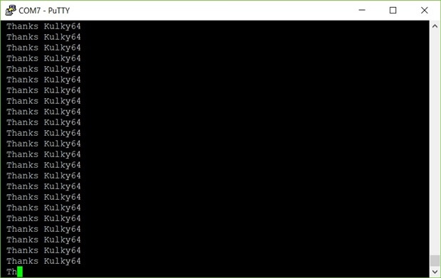

  • 14rhb
    14rhb over 7 years ago in reply to kulky64
    Just like before I read what you said and followed it on the schematics to see if it made sense which it does. A bit of trial-and-error with PuTTY and my SensorTile boards would like to say:
    Rod
