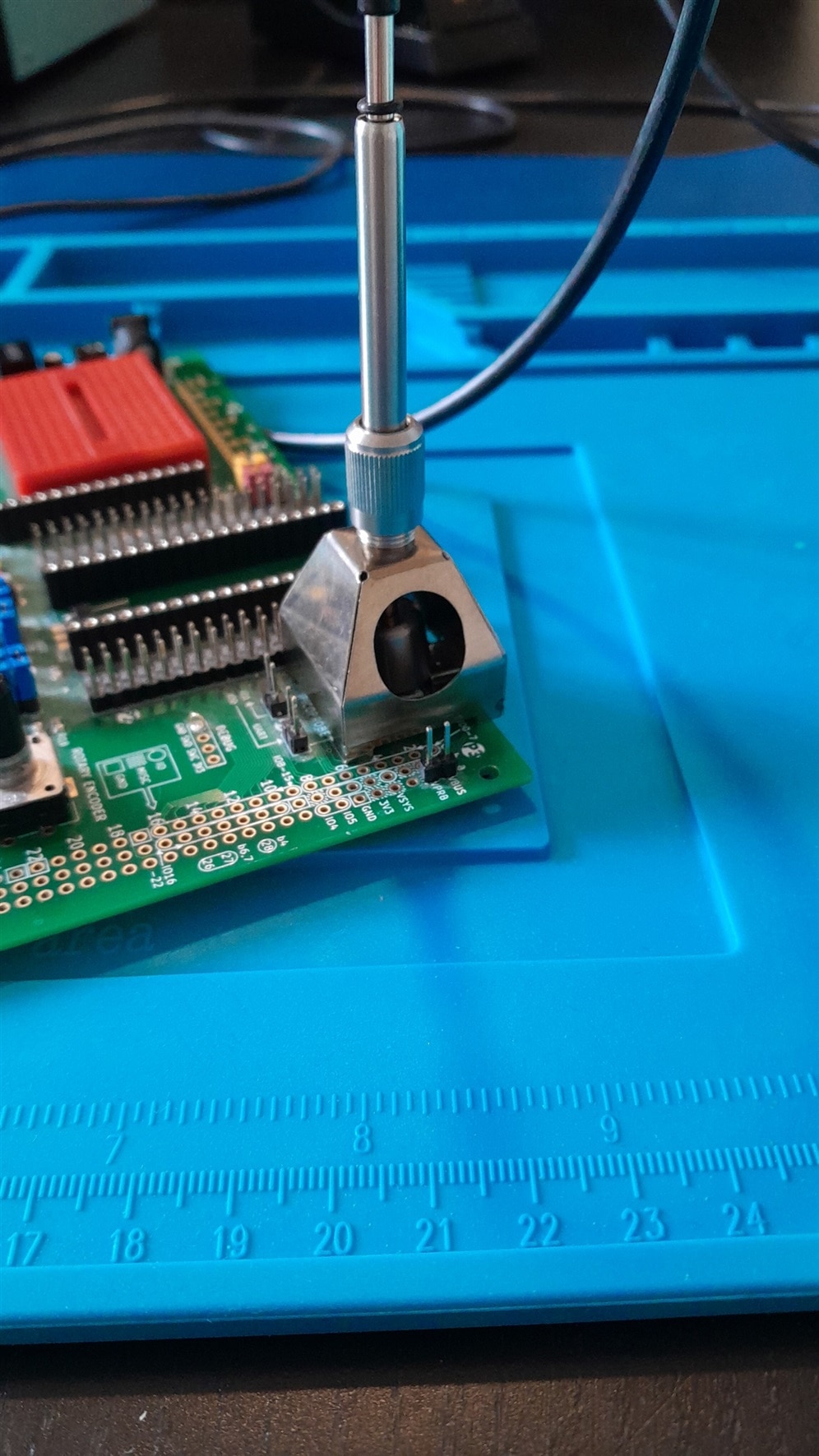

The title says it all. I have a Weller solder station. They have IC reflow gizmos that work together with its hot air gun.
image source: sinuss.nl, the element14 retailer in Belgium and the Netherlands
These are little ovens, that you put on top of the IC you want to rework. Then you put the hot air pencil inside, to flow the solder.
There's a chip lifter (think: coal mine headframe) that can then lift the IC.
It can also be used to place ICs. Should help me with BGA designs.
It may be over-fancy. Paul Daniels and Louis Rossmann do all of this with just a heat gun. But I'm not that skilled - don't do it enough to be repeatedly successful.
My kit is also expensive. The one I bought, with support for 10x10 mm to 33x33 mm (with 6 steps in between), costs 500 €. An amount that I do not easily give away for tools.

    Customer Action Video: https://youtu.be/-oNphHi_tUk The video is real time, raw footage. No comments or talk. End result: no pads ripped, no pins bent.
    Jan Cumps over 4 years ago +4
    Test 2, with a bigger IC and one of the bigger ovens. This was more eventful. Not because of the kit, but because of me, learning while on video. https://youtu.be/lWrsRHoDSZM The editing is very…

    I don't fully understand, is the chamber unit unheated, and then hot air is blown in? Or is the chamber heated too? Is the tube on top of the chamber for sucking fumes?
    Also, is the hot air unit part of your Weller solder station. or separate?

    dougw over 4 years ago
    That is definitely a significant investment.
    It looks like the metal frame conducts heat from the air gun to the pins.
    Are chips lifted with a vacuum?
    Jan Cumps over 4 years ago in reply to dougw
    The solder is heated with the hot air directly. The housing spreads the heat over the IC's surface.
    The lifting works with my station's pick-and-place vacuum pump. It has 3 air connections. For the hot air pencil, for the desoldering sucker, and the pick-and-place one.

    It’s an interesting tool Jan.  I’d always read that one should try and uniformly heat up a PCB with the hot air tool to avoid localised hot spots and I took that to mean try to avoid keeping the hot air in one place too long but keep it “moving around” the part.  This looks like a way of evenly heating up the area around the chip: I bet it works well with the board on a hot plate.
    How much clearance around the IC is required?
