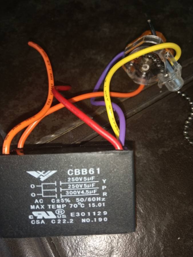

I have an outdoor ceiling that has failed and want to switch out the capacitor and pull chain switch.  I have searched anywhere and everywhere I know to look.  It appears they no longer manufacturer this particular capacitor.
It is a CBB61 with two orange 600v wires on the one side and on the other side it has:
Yellow @250V  5uF
Purple @250V  5uF
Red .@ 300V   4.5uF
Is there anything that I can safely use to get the fan working working and can you
Point me in a direction to find get one?
Sure appreciate any assistance I can get.image

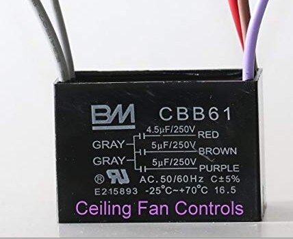

    Hello Rick, Seems that capacitor is not common (tried to find it myself, no luck), but I've found this one from Amazon that maybe could work for you... If the diagrams printed on them are accurate, the…

    ral411 over 7 years ago in reply to luislabmo +1
    Thank you sir, That's exactly I was wondering but wasn't confident enough to risk it. Very helpful and I appreciate it.

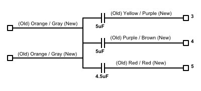

    If the diagrams printed on them are accurate, the new one should work by wiring it in a way that matches the capacitances of the old one -see below diagram-
    Luis

    My suggestion was to connect three discrete capacitor values corresponding to those required. A lead from each capacitor would be common, with the other leads used for each capacitor value. The solution may take up more space that available. The alternate capacitor suggested may fit the bill better.
    Sean
