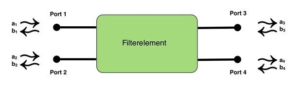

Scattering parameters, or S-parameters, are a measure of how much power or voltage is transferred via a port from the chip to the board. They describe the behavior of linear electrical components by means of wave parameters. S-parameters play an important role in high-frequency technology, as in many cases current and voltage cannot be clearly defined. However, what can be measured is the wave entering a port or being reflected by a port. The advantage of recording the parameter with wave impedances is that undesired impedance transformation at the inputs and outputs of a network are avoided.
The number of S-parameters needed to describe a network depends on the number of ports and is calculated from the square of its port number. A filter element with two inputs and two outputs (Figure 1), a 4-port element, is described with 16 S-parameters (Figure 2).
Figure 1: 4-port filter element with incoming (a) and outgoing (b) guided waves

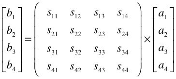

The scattering matrix represents the connection between the individual ingoing waves a1, a2, a3, a4 and the reflected waves b1, b2, b3, b4.
Figure 2: Scattering matrix of a 4-port filter element image
The scattering matrix depends on the reference impedance Z0, the characteristic impedance, which in HF technology is usually chosen as 50 Ω. Network analyzers measure the S-parameters as a function of the frequency and show this as a dimensionless complex number that is often converted to decibels and phase. In principle, all devices under test with more than two ports can be measured with a two-gate network analyzer. All gates that are not being measured at a given time must be connected with the reference impedance. To determine all S-parameters, with this nodal method n(n − 1)/2 complete 2-gate measurements are necessary. On the one hand, this method is very time consuming and cannot be automated because of the manual bonding of the coaxial measuring connection or of on-wafer measurement peaks. Parasitic influences cause a measurement error, on the other.

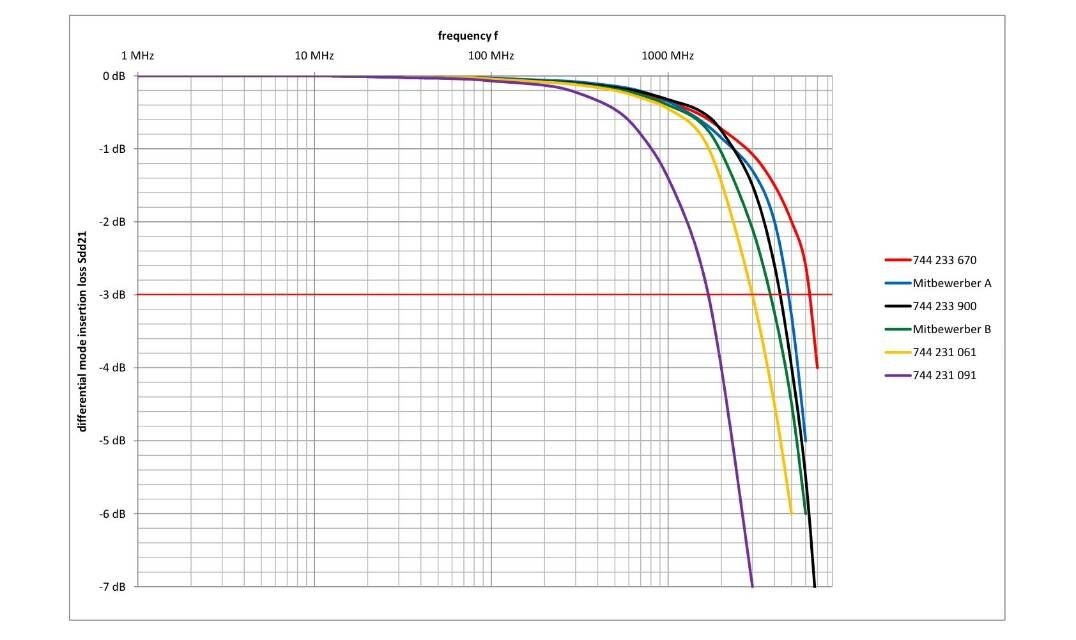

The current-compensated chokes in the WE-CNSW series, the high-frequency variants WE-CNSW HF and components from competitors (table) were investigated. The components were placed on the middle of a test PCB and each was connected to the outer ends of the lines with an SMA connector. A differential signal was then fed into the two signal paths of the choke. The cut-off frequency fc defined at -3 dB shows the frequency at which fed and reflected differential signals are no longer phase-shifted by 180°, or when the useful signal suffers parasitic interference by the out-of-phase signal and its quality is too severely impaired. A network analyzer calculates the insertion loss sdd21 from the nodal scattering parameters.
Figure 5: Results of the sdd21 measurement. The cut-off frequency fc at –3 dB is defined as the reference. The line filters from the WE-CNSW HF series achieve a maximum at 6.5 GHz.
Because common-mode chokes for common-mode signals exhibit high impedance and for differential mode signals much lower impedance, these filter elements enable the common-mode rejection of differential transmission systems and, hence, increase interference immunity. Conformity with the EMC Directive is thus ensured.
The difference with filters especially for high-speed data lines such as for USB 3.0 can best be explained by a direct comparison between the line filter WE-CNSW HF  744233670744233670 with a common mode impedance of 67 Ω @ 100 MHz and the filter from competitor A with a common mode impedance of 60 Ω @ 100 MHz. Although both have high common mode attenuation, the cut-off frequency of the HF modules in the WE-CNSW series is about 1 GHZ higher at 6.5 GHz. This means that with increasing frequency the influence of asymmetries on differential data signals in the HF modules from Würth Elektronik is lower than with competitors' products.
The reasons for this are, on the one hand, the special ferrite material and, on the other, the winding geometry with larger gaps between two windings. Because all of the filters that were investigated have the same design, 0805, a larger gap between the windings also means fewer windings. The fewer windings, the lower the impedance, which, in turn, shifts the resonance point towards higher frequencies. In relation to the sdd21 measurement, this means: the lower the common mode impedance, the better the filter properties in differential high-speed data lines.

With the sdd21 measurement it could be shown that the HF variants in the WE-CNSW current-compensated data line filter series are suitable for common mode rejection at transmission frequencies up to 6.5 GHz without them affecting differential data signals. Conventional current-compensated filters cannot fulfill this requirement, as demonstrated by the measurement results.
