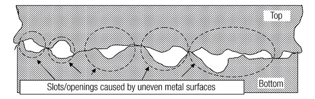

2. “Why is this happening?"

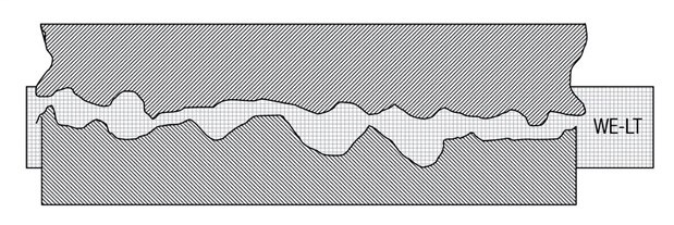

If you look at a flat metal surface microscopically, you begin to see the imperfections. You will find that the material is uneven, with roughness on the surface. Therefore in the metal case itself there is no continuous connection between these two surfaces. Consequently, the seal (or meeting point) is interrupted by slots and if you look at the joining from a RF-technical point of view, it is “highly vulnerable”. These slots and apertures, which were formed due to the roughness, cause an open gate for shortwave radiation to break out/in from the shielding cage (see Figure 1).
Fig. 1: Reduced shielding effect of casings due to apertures
Suggestion to solve the problem:
The solution to the problem lies in the bridging and sealing of these apertures. For that purpose, our conductive textile gaskets WE-LT is an excellent fix (see Figure 2).
Fig. 2: Sealing of the slots and “apertures” using conductive gaskets WE-LT

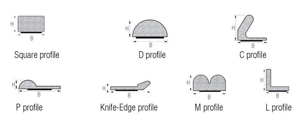

The conductive gaskets are available in following profiles:
Fig. 3: Available profiles of the WE-LT

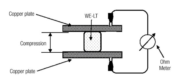

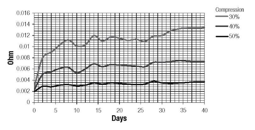

For the application of conductive gaskets a certain minimum compression is necessary in order to keep the transitional resistance steadily low. Long term studies with different compressions have shown that the mounting compression of the gaskets influences the conductivity over time (see Figure 5). A steady compression for contact surfaces of at least 50% is necessary in order to keep the transitional resistance over a long period of time low and steady.
Fig. 4: Test setup surface resistance WE-LT vs. compression
Fig. 5: Long-term run surface resistance vs. compression
The typical surface resistance of the series WE-LT is below 8 mOhm. The achieved shielding effect is approx. 80 dB at 100 MHz and approx. 75 dB at 1 GHz (according to MIL 285 standard).

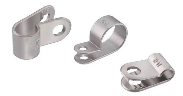

Another shielding mistake which can occur when shielded cable connection to the GND, from a shielded cable, thought an intertwined connection (called “Pig Tails”) are kept too long are used. The result is a high impedance connection and will not give a good path for the noise to travel to GND. It is recommended that all cable connection are using a shielding connection which are low impedance to the GND. This can be solved very easily, using Conductive Nylon Clips (Figure 6).
Fig. 6: Conductive Nylon Clips

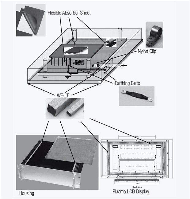

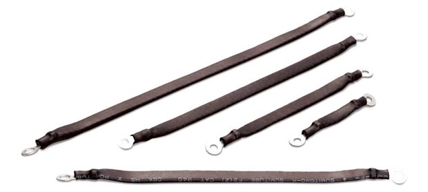

Conductive Nylon Clips are available for cables from 3mm to 15mm in diameter. They are very flexible, extremely low weight and without sharp edges. In this way the cables are well connected and also well fixed to the board without damaging the shielding cable. The connection between the PCB and casing (housing) should also be considered when thinking of EMC issues. Normally the steel spacer studs used are not the best solution because of undefined connection from the PCB to GND. The better solution would be to use Earthing Belts (Figure 7). These Earthing belts provide a solid connection, wider range of frequencies to travel through and so will reduce unwanted noise.
Fig. 7: Earthing Belts

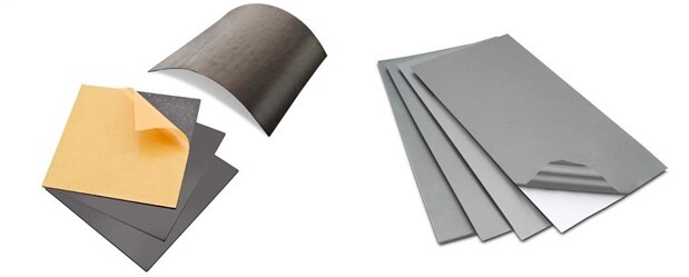

If the system contains several PCB’s in same housing, very close to each other, some uncalculated coupling from PCB to PCB can occur. Those couplings are most in high frequencies and can be solved using a metal cage around the PCB’s. This system called “Zone Concept” can be useful, but is most of the time too expensive. A much more cost effective solution is the use of Flexible Absorber Sheets (Figure 8) which are glued directly to the PCB. The Ferrite Sheet already has the double sided adhesive attached to it. These absorber materials do not need to be grounded or connected to any other device. Because they are very flexible they can be molded even over the components (please avoid high temperatures!).
The shielding is realized through the absorption principle the magnetic field energy is transformed into heat (∆K can’t be measured).
Fig. 8: Flexible Absorber Sheets
Fig. 9: Applications
