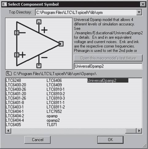

3.4.1 Drawing a schematic
3. We are not going to open a saved schematic, but we are going to create our own in order to go through all the creation steps. To start with, let’s position on our schematic an operational amplifier symbol. To do so, click on
the icon representing the AND logic gate symbol https://community.element14.com/resized-image/__size/1200x900/__key/communityserver-wikis-components-files/00-00-00-00-56/4784.contentimage_5F00_29304.html. Click once on this icon and another window appears. The imageleft-hand column contains a series of words in brackets. In this column, double-click on [Opamps] to access the
operational amplifier directory. (See figure 3.6).
Figure 3.6
A list of operational amplifier appears, scroll to the very end of this list and double-click on UniversalOpamp2, which is currently the last item in the list. It is a standard operational amplifier with average performances. (Figure
3.7).
4. You automatically come back to the schematic page and your cursor is now shaped like an operational amplifier symbol. Go to the centre of the page and click left to drop the symbol on the schematic, figure 3.8. Another copy of this symbol appears straight away and follows the movement of your mouse.
