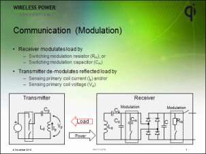

6. The Qi System
How is the WPC Qi standard structured The low power class solution consists of a transmitter that provides 5 W to the receiver coil The transmitter and receiver communicate via a specific power management protocol(Figure 1 The power is delivered between the coils at an operating frequency range of 100 205 kHz The receiver requests the required energy from the transmitter and the transmitter adjusts to the request The energy transmission is monitored and adapted by the power management system If the receiver does not need any more energy the system goes into standby mode Semiconductor manufacturers offer designers evaluation kits and reference designs For example here is a picture of the bq500211AEVM-210 transmitter board from Texas Instruments with a transmitter coil from Wrth Elektronik(760308111
Figure 1: Principles of the WPC Qi standard (Source: Wireless Power Consortium 2012)

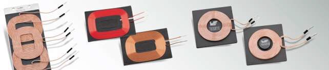

The characteristics of the transmitter and receiver coils are crucial to achieve low power transmission losses. The proper selection and positioning of the transmission and receiver coils has a major influence on the efficiency of the energy transmission.
Figure 2 Transmitter board bq500211AEVM-210 from Texas Instruments(Source Foto Wrth Elektronik
Figure 3: Selection of transmission and receiver coils according to the WPC Qi standard (Source: Würth Elektronik)

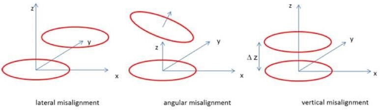

8. Placement of the coils
The transmission and receiver coils need to be properly aligned to minimize losses. Lateral, canted and
vertical misalignments are particularly detrimental to energy transmission. (Fig. 4).
Figure 4: Types of transmission and receiver coil misalignments (Source: RRC power solutions' own representation)
Good coupling and maximum energy transmission depends on the size of the effective area of the receiver coil in the magnetic field of the transmitter coil. Moreover, it also depends on the distance in the z direction. If the receiver coil is centered with the receiver coil without canting and the distance in the z direction is as low as possible then it is more likely that transmission losses are minimal. A coupling factor of 1 is ideal. This means, the effective area of the transmission and reception coils is equal.

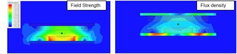

Another important element that crucially influences the coils efficiency is the magnetic field pattern. The magnetic field pattern determines the unwanted radiation into the surroundings. Unwanted radiation into the surroundings has significant effect in system efficiency. Figure 6 shows the magnetic field strength and magnetic flux density of the transmission and receiver coils in optimal coupling.
Figure 6: Simulation of the magnetic field strength and flux density in inductively coupled coils on ferrite (Source: Würth Elektronik)
It is clear that the magnetic field is selectively limited to the space between the coils and there is practically no influence on the surroundings. The simulation of the flux density shows the effect of the ferrite plate. The magnetic flux is concentrated within the ferrite. Figure 7 shows the magnetic field strength and flux density with a lateral misalignment (28%) of the transmission and receiver coils.

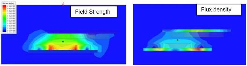

Figure 7: Source: Würth Elektronik
With this misalignment, the magnetic field and magnetic flux are mainly limited to the overall configuration of both coils. There is no increase of the field in the z direction. It can be deduced that by using a suitable ferrite shield, the magnetic field in the inductive coupling is limited to the area between the coils, and therefore, additional shielding measures are not necessary. In addition, the Qi standard regulations prevent greater losses arising from misalignment of the coils. For example, if the energy transmission efficiency of the connection drops below 70%, then the power management system aborts transmission. Only when the alignment of the coils allows for energy transmission with an efficiency >70%, then energy transmission starts.
