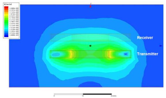

During energy transfer in a magnetically coupled pair of coils the magnetic flux flows from the transmitter through the receiver, using its surrounding environment to provide the return path. As you can see in Figure 5 this directed flux can flow up through the receiver and continue into the device being charged. This will have negative effects, as these magnetic fields will cause self heating within any conductive component other than the charge coil (eg Battery). The inductive coupling will also provide noise current loops in these conductive materials (Eg IC’s, PCB traces, etc) thus creating EMI Issues.
Figure 5: Wireless power magnetic flux without shielding

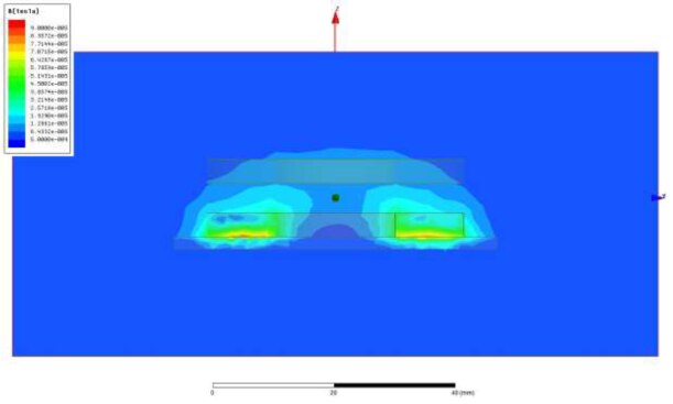

In Figure 6 the image shows the result of a simulation. This shows with colors how the flux is concentrated in the transmitter coil (green and yellow) and the interaction with the receiver coil but also shows us the field which passes beyond this into the back of the transmitter particularly (light blue). Placing ferrite sheets behind the transmitter and receiver coils, the flux is concentrated in the area between them, and the circuitry outside is protected. (Figure 7, Figure 8)
Figure 6: Magnetic flux density distribution without shielding (software Simulation)

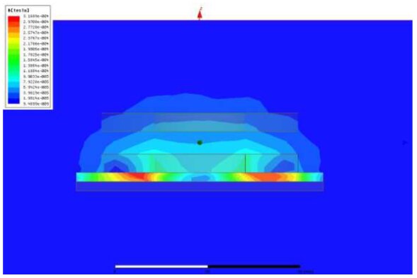

Figure 7: Wireless power with shielding
Figure 8: Magnetic flux density with shielding (software Simulation)

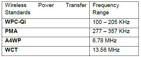

There are several wireless power standards working with inductive charging incorporating different frequencies (Table 1). The ferrite sheet material must be selected accordingly to give maximum performance (maximum μ’and minimum μ”). WE-FSFS 354 losses μ” are lower than 2 up to 2 MHz while its μ’ is higher than 200, and it is the perfect shield for Qi and PMA standards. For higher frequencies the best option is WE-FSFS 364 because of its low losses (μ”<2) up to 13,56 MHz while its μ’ is still above 100.
Table 1 Wireless Power working frequencies

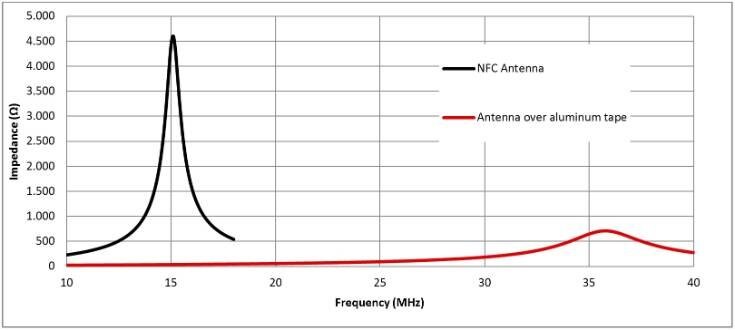

But the presence of a conductive surface (i.e. battery, ground plane, metallic enclosure) close to one of the coils will not allow the communication due to the shielding effects of these devices. The flux generated by the Reader (blue lines) traverse the conductive plane generating eddy currents.
These eddy currents generate an opposite flux (red lines) reducing the efficiency of the communication (Figure 9 NFC-RFID communication without shielding, Figure 10 Conductive plane effect in magnetic flux distribution (simulation)). At the same time, the presence of the conductive material close to either transmit or receive coils, reduces their inductance. The resonance frequency will consequently increase and thus takes the circuit out of tune with the resonance frequency. This will increase the fail rate and could prevent successful communication.
Figure 9: NFC-RFID communication without shielding
Figure 10: Conductive plane effect in magnetic flux distribution (simulation)
Figure 11: Conductive plane effect (frequency shift and Q reduction)
The loss in inductance value comes about by increasing the losses of the coils due to the losses created in the conductive material by the eddy currents. This will add to the RDC of the coil, and the Q factor of the resonance will drop (Figure 11 Conductive plane effect (frequency shift and Q reduction)).

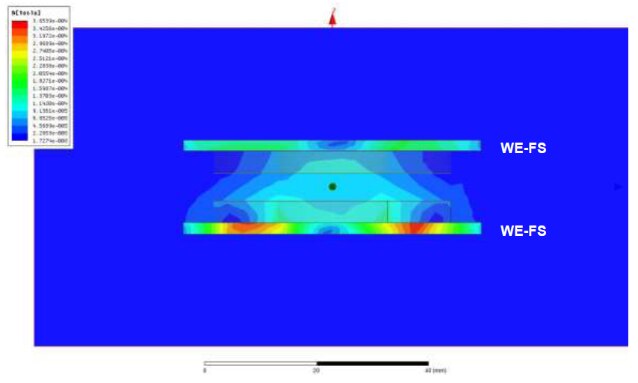

It will be very difficult for the matching circuit to compensate these shifts in frequency and Q. A ferrite sheet WE-FSFS 364 with high μ’ at 13.56 MHz can redirect the flux, avoiding the conductive plane, the eddy currents, and increase the inductance.
Low losses (μ”) at the same frequency will assure that the losses (R) are not increased significantly, thus ensuring a high quality (Q) resonance (Figure 13, Figure 12, Figure 14)
Figure 12: NFC-RFID shielding
Figure 13: Conductive plan with ferrite shielding (simulation)
Figure 14: Ferrite shield countermeasure (frequency shift back and Q increases
