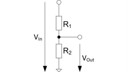

In any case, Ohm´s Law describes the behaviour of a linear resistance. If a simple voltage divider made of ideal resistors is considered, its output rises when its input voltage is increased.
This is illustrated in Figure 2.
Figure 2: Voltage divider with ideal resistors

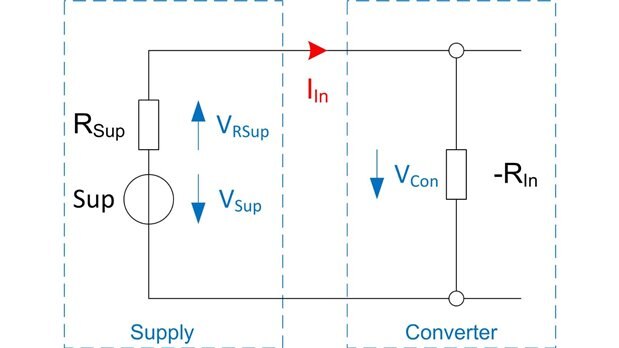

However, in our case, input resistance of a switching regulator is not linear but very non-linear and also negative. Figure 1 makes this clear. For further illustration, we would like to consider a voltage divider which is not constructed from two ideal resistors but from one voltage source with defined internal resistance and a switching regulator with negative resistance. Figure 3 shows such a voltage divider. A basic design of the switching regulator and its components is not further required here for the closer consideration.
Figure 3: Voltage divider consisting of voltage source and negative resistanceimage
If the voltage "VSup" of the source increases, the current "IIn" drops and consequently the voltage drop "VRSup" at the internal resistance of the voltage source. However, the voltage at the switching regulator input
increases. The input voltage of the switching regulator is reduced by the voltage drop at the internal resistance of the voltage source. The following approximately applies:
VCon = VSup - VRSup
Electronic components such as electrical resistors do not occur in real life with negative values. The real input resistance of a switching regulator is also not negative, but its behaviour during change of the input voltage. Accordingly, this behaviour shows a negative resistance which is based on a mathematical origin. If a tangent is applied to the voltage-current curve in Figure 1, its increase of the negative resistance can be determined at any operating point. This is "generally" defined by:
As the slope of the tangent is negative in this case, the input resistance of the switching regulator is negative!

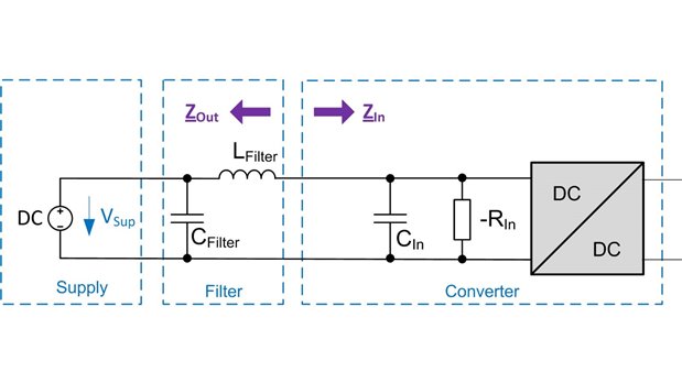

A pulsed current flows in the input circuit of the switching regulator; this current should be suppressed to prevent conducted emission interference. Therefor, an additional input filter is placed before the switching regulator input in practice. Figure 4 shows such an arrangement.
Figure 4: Simplified arrangement of a switching regulator with input filter.image
Figure 4 should show the input impedance ZIn of the switching regulator which is formed by the input capacitor CInand the negative input resistance -RIn. The input filter, which can be realised for example using a WE-PD2 or WE-TID filter coil from Würth Elektronik, forms a series resonant circuit with the output impedance ZOut in the direction of the switching regulator input. The input filter is parallel to the input capacitor CIn and the negative input resistance -RIn and can result in oscillation of the input circuit at resonance frequency. However, if a small signal analysis is performed, the voltage source at high frequencies presents a short circuit whereby the filter capacitor is short-circuited resulting in only the filter coil still being considered. A high quality coil is usually selected as filter coil.

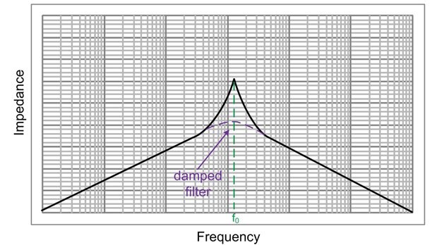

Figure 5 shows the impedance curve of the inductance and the resulting output impedance of the filter which clearly shows its maximum impedance at its natural resonance.
Figure 5: Impedance curve of the input filter at resonance frequencyimage
The output impedance of the filter is at its highest at resonance frequency and conflicts with the input impedance ZIn of the switching regulator. To prevent any oscillation, it is recommended to attenuate the filter as shown in Figure 5 to reduce the impedance during resonance. Therefor, a design tip is to kepp the output impedance of the filter much lower than the input impedance of the switching regulator.
ZOut << ZIn
Ceramic Capacitors are often used in the input circuit; however this results all the more in oscillation of the filter as ceramic capacitors have negligibly smal ESR. This increases the quality of the filter. Reduction of the quality could theoretically be realised by a parallel circuit of resistors; however this is not a practical solution. It is therefore recommended as a design tip to use electrolyte capacitors here which have relatively large ESR. A large ESR can sufficiently reduce the qualtiy of the input filter whereby the input filter is attenuated and oscillation at the switching controller input is prevented.
