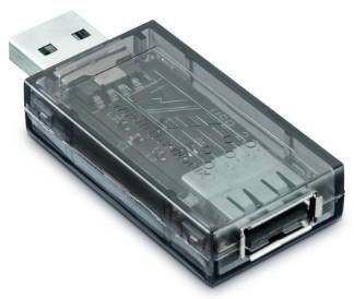

ANP024: The USB Interface from an EMC Point of View
ANP024C, BY HEINZ ZENKNER

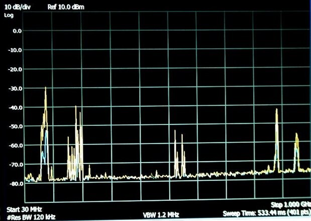

What EMC phenomena do we have to consider developing a product with USB and what are the most critical phenomena? These are:
  • interference emission (interference field strength)
  • interference immunity against electrostatic discharge (ESD)
  • interference immunity against fast transients (burst)

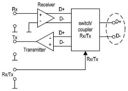

The USB interface is a bidirectional, symmetric interface, as presented in Fig. 3.
Fig. 3: The USB interface is symmetrical and bidirectional
Symmetrical transmission techniques have numerous advantages in terms of signal integrity, which are apparent in lower interference emission and higher interference immunity. Fig. 4 provides a more detailed explanation.

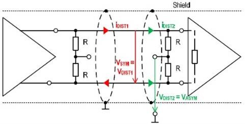

Fig. 4: The symmetrical interface with its measurable interference voltages
The following are measurable:
a) Usym: interference voltage between the signal wires
b) UAsym: interference voltage between the voltage midpoint and the reference voltage (ground) and the cable shielding.
This means that the USB transmission path can be affected by both differential mode, as well as common mode interference voltages. This can be both interference voltages from the interface itself, in this case described as interference
radiation or interference emission or an electromagnetic effect from the outside in the form of inductive, capacitive or wave coupling - in this case described as interference coupling, which assumes a certain interference immunity of
the interface in order to maintain continued function.

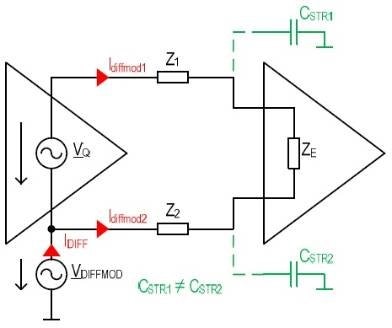

In the case of USB transmission, differential mode interference is mainly generated by non-linear signal harmonics due to mismatching and inadequate circuit design. Given asymmetry of the transmission path, i.e. transmitter, circuit board and conductor tracks, possibly filters, cables through to the receiver, this interference can lead to interference radiation and impairment of signal quality.
Common mode interference arises from parasitic coupling in the circuit environment of the USB controller, which can usually be found from capacitive coupling on the USB signal with rising interference frequency and increasingly in amplitude. However, these interference types are found on both USB wires in phase and at the same amplitude and therefore do not impair the useful signal. Asymmetries in the cable or at the receiver often convert the originally common
mode into a differential mode interference signal, however, which can then contribute to signal impairment. High quality circuit design is called for this too. Fig. 5 illustrates the case.
Fig. 5: Conversion of differential mode to common mode interference due to parasitic coupling capacities.

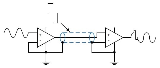

4.2. Interference immunity
Differential mode data transmission offers a significant advantage over the simple coaxial cable when it comes to the effect of interference on the USB. Fig. 6 presents the effect of interference on a coaxial cable. Depending on the shielding
effectiveness of the coaxial cable, a burst (electric field), for example radiated from a mains cable in parallel with the USB cable, couples into the data line and interferes with the data signal. This leads to data or communication errors, which
depend on the interference signal length and amplitude.
Fig. 6: Effect of interference on a coaxial data transmission path

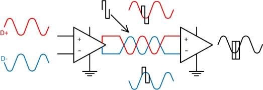

Fig. 7 represents the case of differential mode data transmission, in this case with only a twisted pair of wires. The polarity of the useful signal is shifted from one wire to the other by 180°, the signal difference is evaluated at the input of the receiver. But the interference signal affects both wires in the same phase, so this cannot have an effect as an interference signal at the receiver.
Furthermore, in the case of the inductive interference effect (magnetic field), the twisting of the wires achieves compensation of the interference effect. As a result of the symmetrization of the partial inductances of the respective twisted wire, the interference influences compensate each other.
Fig. 7: Compensation of electrical interference coupling of the differential mode signal input and twisted wire pairs

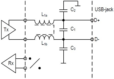

Both points can be fulfilled using additional filters and the USB interfaces. Fig. 8 shows the basic circuit of a symmetrical USB signal filter.
Fig. 8: Basic circuit of a symmetrical signal filter
Capacitances of up to approx. 3 pF between the data line and ground are tolerable with USB 2.0, beyond this the signal is impaired too much so that non-linear distortions occur that cause phase shift and attenuation in the harmonic component of the useful signal. The capacitors C2 and C3, together with the current-compensated choke, reduce the symmetrical interference components. The capacitances C2/2 and C3/2 affect the signal. It goes without saying that - C2 = C3. C1 reduces the symmetrical interference components and thus also affects the useful signal, its capacitance should be less than 4 pF. The values depend strongly on the properties of the current-compensated choke. The choke must have a high degree of symmetry and low stray capacitance between L1a and L1b. Furthermore, the real component of the ferrite permeability - that is the inductive component - must be low and within the useful frequency range. In contrast, the resistive component of the permeability - that is the complex component - must be high and within the frequency range to be filtered. Fig. 9 illustrates the relationships. The ferrite material has its transition range at around 200 MHz.

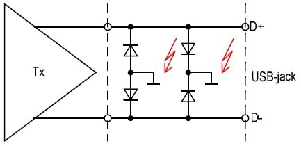

Transient interference signals, such as ESD and bursts, can generally be limited with varistors. Especially SMD multilayer varistors which are particularly fast and withstand a high level of energy. What they all have in common is their high
capacity, which is why they are not suitable for limiting transients at the USB. Transient limitation with diodes is shown in Fig. 10. Transients are limited against ground, both on D+ as well as on D- up to the forward voltage VF of the diodes. This voltage is around 0.7 V for silicon diodes. A problem appears very quickly here, which is why the diode pair on the right has two red flashes: The signal voltage of the "mid-speed" signal is up to 2.8V (D+ to D-), i.e. 1.4 V to ground. The positive branch must therefore be provided with an "offset" in order to avoid impairing higher signal voltages.

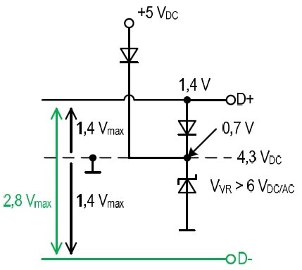

Fig. 10: Diode limiter to reduce coupled transients (burst, ESD) on the USB interface
Fig. 11. shows the solution. An additional TVS diode with a limitation voltage of 6 V sets the threshold value to approx. 6.7 V. That is sufficient for protection; TVS diodes with lower limitation voltages are too slow to limit ESD. The voltage levels are illustrated in Fig. 12.
Fig. 11: Diode limiter to reduce coupled transients (burst, ESD) on the USB interface with "offset" for higher signal levels
Fig. 12: Voltage level of the positive diode path
Transient limitation at the connection of the supply voltage can be achieved at the same time using the additional diode D5 in Fig. 10. Although the capacitance of the TVS diode is low at 5 pF, it would be too high for USB. As VR1 is in series
with D3 and D4, however, the capacitance of VR1 reduces the overall capacitance that affects the signal here - so it is uncritical, as D3 and D4 have capacitances of approx. 2 pF. As in Fig. 8, the capacitors are in series with D3 and D4 with
reference to the signal, there is an overall signal-to-signal capacitive load of 2 pF and signal against ground of around 3 pF.

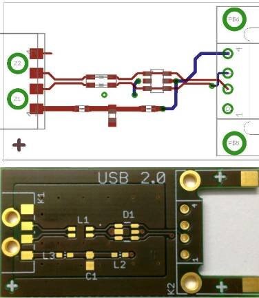

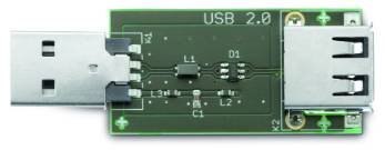

5.2. Practical example
Fig. 13 shows the complete circuit diagram. The associated technical data of the components are specified as follows.
Fig. 13: Complete circuit diagram of the USB 2.0 filter

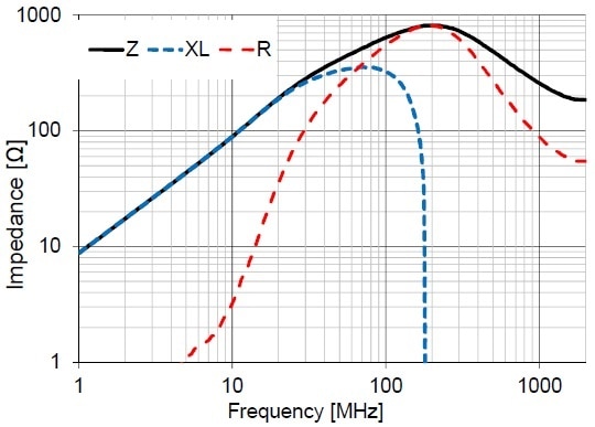

Rated currentΔT = 40 KIR1000mAmax.
DC resistanceRDC0.20Ωmax.
Table 2 Electrical characteristics of SMD ferrite  742792651742792651
Fig 14 Impedance curve of the SMD ferrite  742792651742792651

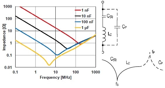

The capacitor WCAP-CSGP X7R0603684K016DFCT10000 used here(Part No  885012206051885012206051 has the following characteristics:
  • Max. voltage 16 V
  • Capacity: 680 nF
  • Tolerance: 10%
  • Ceramic: X7R
The capacitor should have its series resonant frequency above 500 MHz, which depends on the dielectric and the package. Small packages like 0603 or smaller with lossy dielectric such as X5R or Y5V are well suited. Lossy dielectrics exhibit less pronounced resonances, which is desirable for filters in the supply voltage area. The resonance is a series resonance, which, as a result of the parasitic components above the resonance frequency of the filter, make the capacitor unfit for use, i.e. in advance: The ground connection of the capacitor also has to be low-inductance (layout) in order to keep the total impedance as low as possible. Fig. 15 illustrates the relationship.
Fig. 15: The capacitor with its parasitic properties (simplified)
Depending on the package and dielectric, the capacitor has a series resonance that can already occur at a few MHz. Furthermore, the capacitor has a second resonance, whose frequency is significantly higher, however. Typical package capacitors with X5R ceramic of 100 nF have their series resonance at approx. 500 MHz and their parallel resonance at 1.5 GHz.

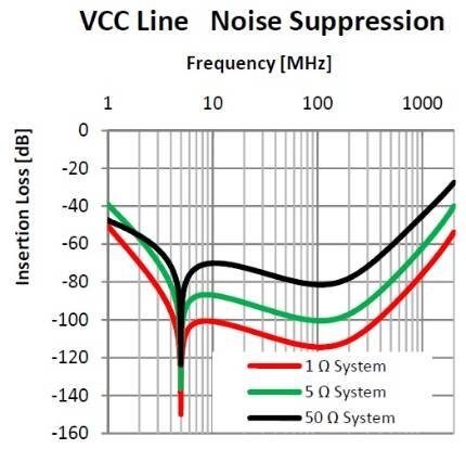

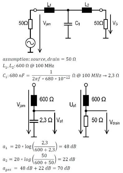

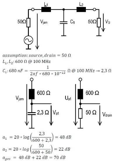

The T-filter constructed this way for the supply voltage has a high insertion loss. The T-circuit was therefore chosen, because it has to be assumed that both the source, as well as the sink, in the power supply area are of low impedance.
This gives rise to an optimal mismatch and therefore maximum suppression. In Fig. 16 the theoretically possible insertion loss is calculated for the example of a 50 Ω system. There is a maximum attenuation of 70 dB at 100 MHz. This should be sufficient even for the toughest of situations.
Fig. 16: Calculation of the insertion loss of the T-filter in the supply voltage

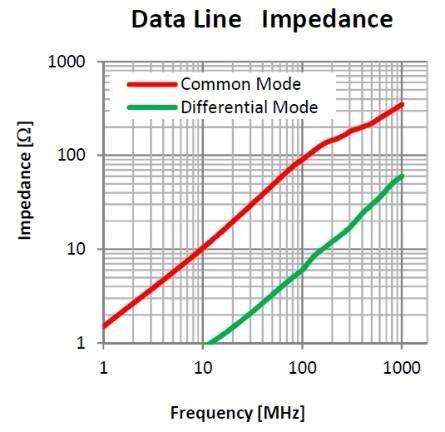

The current-compensated choke  744232090744232090 is the heart of the data line filter. On account of its winding technology and the few windings, the choke has a high degree of symmetry and low parasitic capacitances. A high insertion loss can be
attained as a result of the high permeability of the ferrite material. The structure is shown in Fig. 17, the most important parameters are given in Table 3.
Fig 17 Current-compensated choke  744232090744232090 for the data line filter
PropertiesTest cond.ValueUnitTol.
Impedance100 MHzZ90Ω±25%
Rated voltageUR50Vmax.
Rated currentΔT = 40 KIR370mAmax.
RDC
@ 20°CRDC0.30Ωmax.
Table 3 Electrical characteristics of current-compensated choke  744232090744232090
The impedance curve of the choke in common and differential mode is presented in Fig. 18. It is its common mode or asymmetrical suppression that takes effect if the same interference components are on D+ and D- with respect to ground. This is always the case for capacitive or inductive coupling on the circuit or its conductor tracks. So this impedance component must be as high as possible. At 100 MHz the choke has around 90 Ω. The differential mode impedance is the impedance compensated by the winding structure. "In one branch the current goes in - in the other out again", which is how current compensation should arise and the useful signal sees this impedance. This impedance must be as small as possible. All components of this impedance arise from asymmetries in the set-up and due to losses in the material from eddy currents and the skin effect. At 100 MHz this choke has a differential mode impedance of 6 Ω (both windings together).
Fig 18 Impedance curve of current-compensated choke  744232090744232090

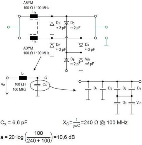

Now to the filter capacitors that form a low-pass 2nd order filter in the output of the filter. A diode array is used here instead of capacitors. The integrated diodes also have a capacitance, a parasitic capacitance, which we make use of here. In addition, the parasitic inductance of the TVS diodes in the array is very low. This has to be the case, as otherwise a short response time to the overvoltage transients cannot be attained. So we combine an almost ideal capacitor with effective transient protection. The most important electrical characteristics and the structure of the array are presented in Fig. 19.
PropertiesTest conditions
Value typ
Value max
Unit
CIO
VPin5=5V, VPin2=0V,
VIO=2.5V, f=100MHz,
I/O to GND
2.02.5pF
CX
VPin5=5V, VPin2=0V,
VIO=2.5V, f=100MHz,
I/O to GND
0.40.6pF
Fig 19: Electrical characteristics and structure of the diode arrayWE-TVS  8240010282400102
The interference signal attenuation can also be calculated for this filter; assuming that the interference occurs at both signal wires in the same amplitude and phase angle, the calculation in Fig. 20 applies.
Fig. 20: Calculation of the insertion loss of the USB data line filter
Here the attenuation is 10 dB at 100 MHz. Even this is sufficient, as the interference components can be assumed to be lower than on the power supply connection and the useful signal should not be affected. Every capacitance to ground acts as a signal load of half capacitance.

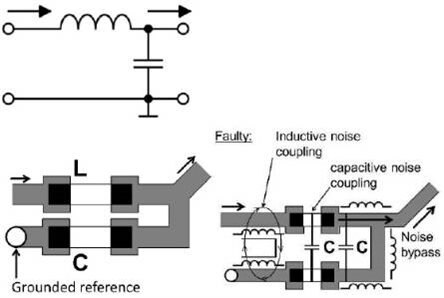

The circuit board with its conductor tracks is an arrangement of components with capacitances and inductances. The layout therefore has to be developed according to the circuit requirements. A simple LC low-pass filter can be significantly
impaired in its effectiveness by an unfavorable layout. Fig. 21:
Fig. 21: Example of a low-pass filter for high frequencies with an unfavorable layout
What is wrong with the layout in Fig. 20?
  • The ground connection to the capacitor is too long. 1 cm of track corresponds to 6-10 nH.
  • The ground connection should pass directly to the housing, as the ground reference of the cable shielding and the ground reference of the filter must lie on the same HF potential.
  • A stub line to the capacitor passes between the inductor and capacitor. This stub line is an additional inductance in series with the capacitor and, as a result of the higher reactance of the inductance with increasing frequency, renders the capacitor ineffective.
  • The filter input and filter output couple inductively with each other. The filter is short-circuited with increasing frequencies.
  • The components couple capacitively as they are located parallel to one other. Here too, the coupling is greater with increasing frequency.

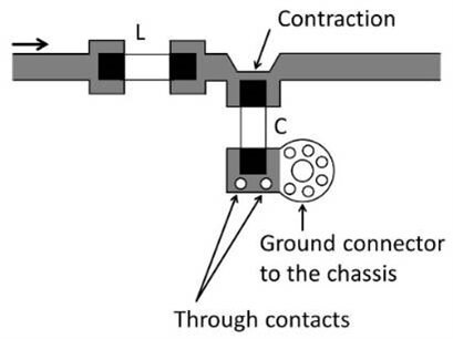

  • The corrected layout with the associated HF-compatible arrangement is shown in Fig. 22.
Fig. 22: HF-optimized layout of an LC filter
What is right with the layout in Fig. 22?
  • The contraction prevents that interference current is bypassed at the capacitor. The capacitor "lies" in the signal path.
  • The rectangular arrangement of the components prevents mutual coupling.
  • The short ground connection at the capacitor, which is of low impedance as a result of two through-contacts, offers an ideally HF-passivated reference point for the capacitor.
5.3. The Würth Elektronik eiSos  USB 2.0 EMC Application Board
All the points discussed so far have been considered in the USB Application Board.

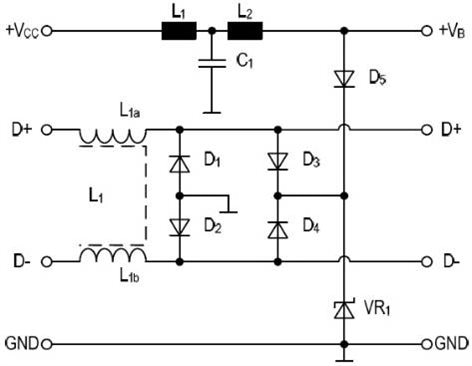

The data lines are routed symmetrically, all ground connections have the shortest connection to the chassis and the circuit board also has a ground plane. The empty space, also around the components, has been filled with compound in order to reduce coupling between the tracks and between the components. All ground connections are provided with at least two through-contacts. The layout and both sides of the circuit board are presented in Fig. 23. Fig. 24 shows the
resulting USB dongle; the circuit diagram corresponds to that in Fig. 13, the layout to that in Fig. 23. The optimal connection of the reference and chassis ground is clearly identifiable from the USB receptacles. It is obvious that this ground
reference is only ensured if the USB receptacles of the device (PC) are of low impedance, connected directly to the chassis and the USB cable is also shielded, as described previously.
Fig. 23: Layout and component side of the EMC ApplicationBoard for USB
Fig. 24: USB Dongle, closed and opened, layout according to Fig. 23, circuit diagram according to Fig. 13
The following curves in Fig. 25 a-c show (from top to bottom) the insertion loss of the power supply filter, the commonmode and differential mode impedance of the data line filter and the transient limitation of the data line filter.
Fig. 25a: Insertion loss of the power supply filter
Fig. 25b: Impedance of the data line filter, common and differential mode

imageFig. 26: Use of the EMC USB dongle
Used in this way, as a signal source for a PC and as a peripheral device, a USB hard drive emits an interference emission spectrum as in Fig. 27. The yellow curve shows the interference spectrum on D+ in front of the filter, the blue curve behind it. The interference is reduced by up to 35 dB. The magnitude of suppression is strongly dependent on the impedance of the interference source, which depends of the type of coupling, i.e. capacitive, inductive or radiated. The

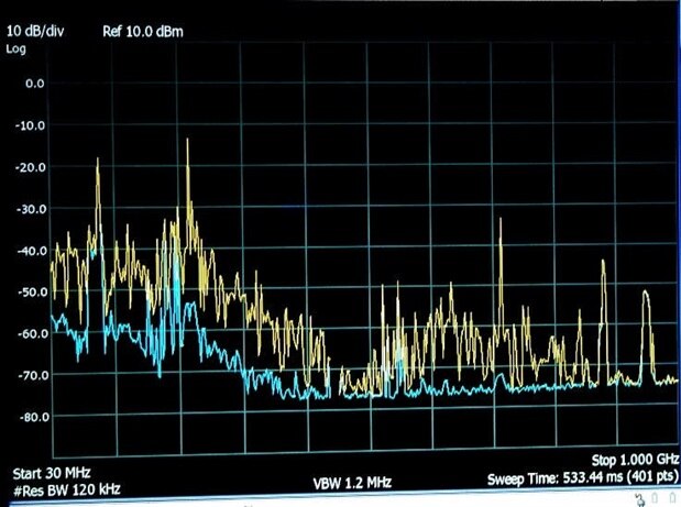

Fig. 27: Interference emission spectrum on D+ before and after the data line filter
Fig. 28 shows the interference spectrum before and after the power supply filter. A reduction in interference of around 20 dB is apparent here too.
Fig. 28: Interference emission spectrum on the power supply line before and after the data line filter
