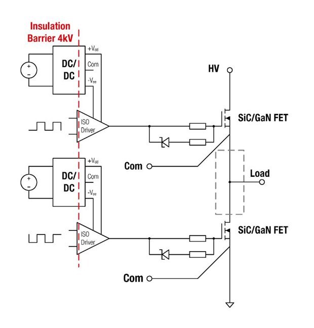

Figure 1: Overview of a HV half-bridge control of the High-side & Low-side SiC-MOSFET.
In applications using SiC/GaN high-voltage semiconductor devices under hard-switching operation, galvanic isolation is a common requirement for safety and functional reasons, and depending on the application, a basic or a reinforced insulation will be required. The operating voltage, insulation material, pollution degree and the applicable regulatory standards set the minimum creepage and clearance distances as well as the dielectric isolation voltage requirement affecting the components placed across the isolation barrier. The high-speed isolated gate driver IC (e.g. TI UCC21520) and the transformer in the isolated auxiliary power supply (DC/DC Block in figure 1) both ‘bridge’ this isolation barrier, thus having to meet stringent safety and functional requirements.
Some of the latest SiC-MOSFET devices require typical gate voltages of +15 V for full turn-on and -4 V for reliable turn-off. For a GaN-FET usually only +5 V and 0 V are required respectively, although a small negative voltage can also be applied to ensure turn-off in presence of excessive gate voltage ringing. Please note that these values may vary depending on manufacturer. In figure 1, a half-bridge configuration is shown, and several of these stages are typically required in an inverter circuit to drive AC-motors in the kW range. Each SiC/GaN FET would require an independent gate driver stage with its own isolated auxiliary supply. This not only enables individual control of each SiC/GaN device, but also helps to keep the gate current loop small and local to the device, minimizing the adverse effects of parasitic loop inductance and ground bounce caused by the very high ΔI/Δt generated during the switching transition (figure 2 and figure 3).

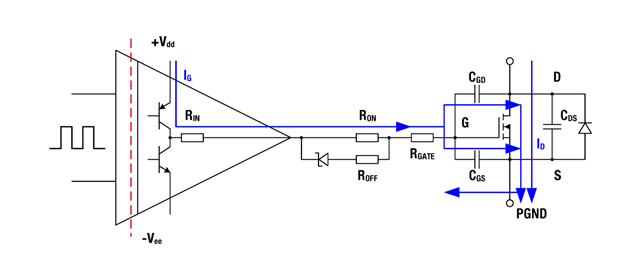

Figure 2: High ΔI/Δt current paths on turn-ON of SiC/GaN FET.

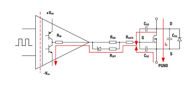

Figure 3: High ΔI/Δt current paths on turn-OFF of SiC/GaN FET.

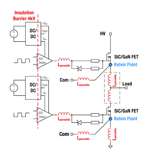

Otherwise, this may cause uncontrolled turn-on/off of the MOSFET and thermal issues. Some SiC MOSFETs are designed with an additional low impedance Kelvin source connection (figure 4) for a gate current return path. This connection does not carry the high switching current and therefore has a lower interference potential than the source connection, which significantly improves gate driving. (e.g. Infineon IMZ120R045M1 1200 V / 52 A).
Figure 4: Kelvin connections and critical parasitic inductances in a half-bridge configuration.
Regarding the auxiliary supply, it should be compact with its output capacitors (with minimal ESL and ESR) placed very close to the gate driver and SiC/GaN device to minimize the gate current loop and associated parasitic effects.

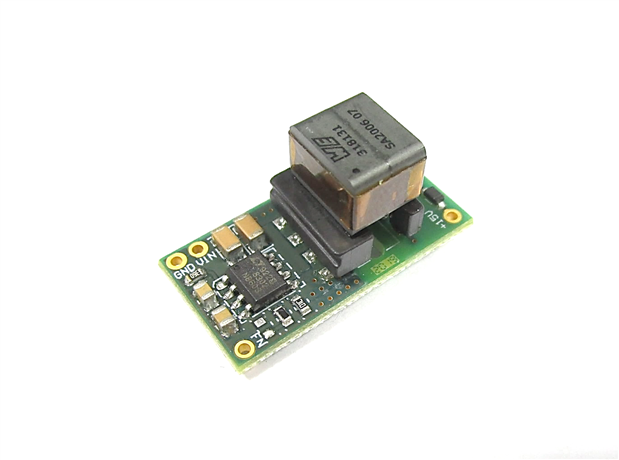

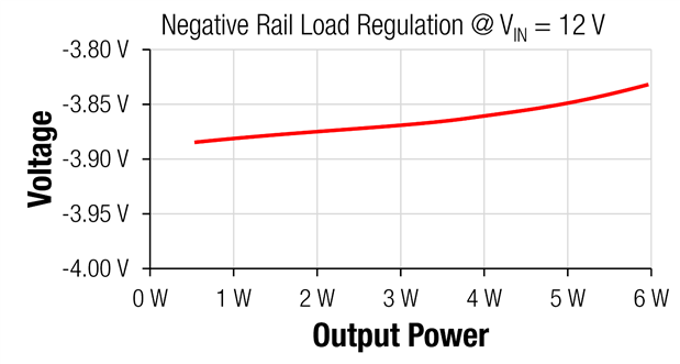

4. Würth Elektronik Solution up to 6W (10W)
The high-performance bipolar isolated auxiliary power supply design of Würth Elektronik features the following specifications:
  • Input voltage range: 9 - 18 V
  • Output voltage: bipolar +15 V / -4 V or Unipolar 15 - 20 V
  • Power up to 6 W
  • Peak efficiency of up to 86% (83% @ 6 W)
  • Parasitic coupling capacitance less than 7 pF
  • Size: 27 x 14 x 14 mm (L x W x H)
        -> Over 50% smaller than similar DC/DC converters currently on the market
  • Weight: < 4 g
  • Basic insulation for VBus: 800 V
  • 4000 Vrms insulation voltage Pri-sec
Figure 5: Würth Elektronik reference design for a compact, isolated DC/DC converter for HV SiC/GaN/IGBT Gate Driver

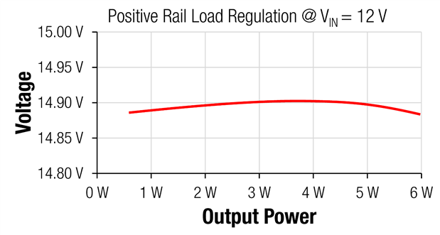

Figure 6: Voltage of Positive and Negative rails versus load power (@ VIN (nominal) = 12 V)
In addition to the controller (Analog Devices), the key component in the design is the new power transformer (WE-AGDT-750318131). A compact EP7 customized package was used and optimized to meet the following requirements:
