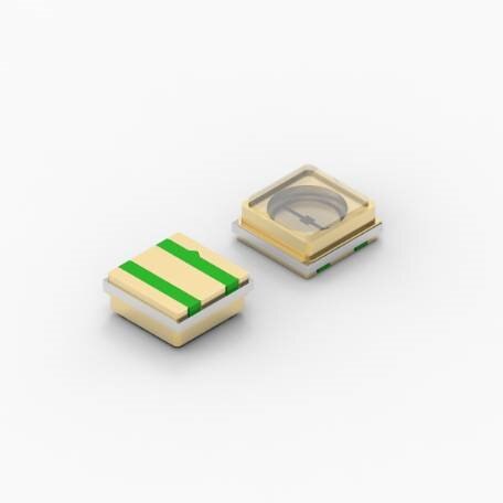

Figure 1: Würth Elektronik eiSos WL-SUMW UV-C LED with 275 nm wavelength.
The 15335327BA250 LED is suitable for small disinfection targets while the 15335327BA252 product has a higher power for disinfection on a larger scale.

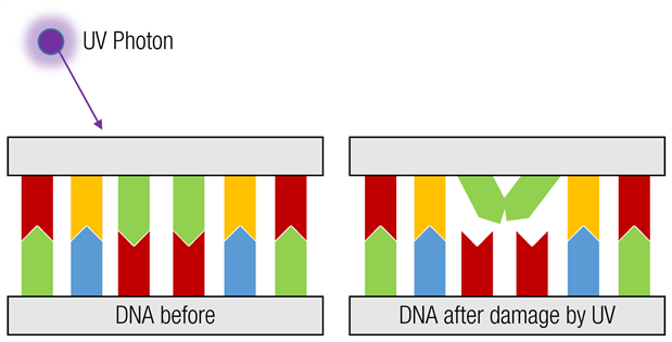

Desinfection with UV-C is based on the fact that UV-C radiation can damage the DNA or RNA. This high energetic UV light can induce formation of pyrimidine dimers [2] and other damages to the DNA which can inhibit multiplication of cells such as bacterial, fungal, plant and animal cells. Similarily the UV light can damage the RNA of viruses leading to their inactivation.
Figure 2: Schematics of DNA damage induced by UV light

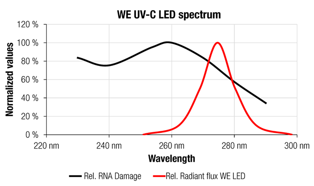

Figure 3: Wavelength dependence of RNA damage and radiant flux of Würth Elektronik eiSos LEDs.
In Figure 3, the wavelength dependent RNA damage [3] is shown. The more damage that is done to the RNA, the less capable is the virus of infecting other organisms. It is important to note that for a good sterilization result, a combination of the correct wavelength and a high amount of radiation is required. For the best sterilization result, the wavelength as well as the radiant power need to be considered. As the ratio of the optical power over the electrical power, the Wall-Plug-Efficiency (WPE) is a parameter showing how efficiently the LED can convert electrical power to optical power. The WPE of our standard 275 nm LEDs (PN 15335327BA252), is higher than other UV-C emitting LEDs with shorter wavelength. The optimal wavelength with the best sterilization efficiency will be an LED solution where both the WPE and the wavelength are as ideal as possible. An overview of the combinded sterilization efficiency of some LED solutions available on the market is shown in Figure 4. Here the combined sterilization efficiency is calculated as the product of the corresponding LEDs’ WPE as well as the wavelength-dependent RNA damage. For the investigated LED wavelengths the most efficient solution for disinfection is in fact the 275 nm wavelength LED.

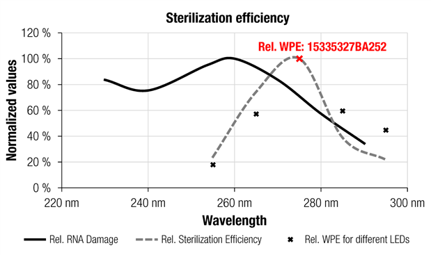

Figure 4: Sterilization efficiency (grey) as the product of RNA Damage (black) and WPE (crosses) is shown in dependence of the wavelength. Compared to other UV-C LED wavelengths available on the market, image
a good sterilization efficiency can be achieved with our 275 nm LED.

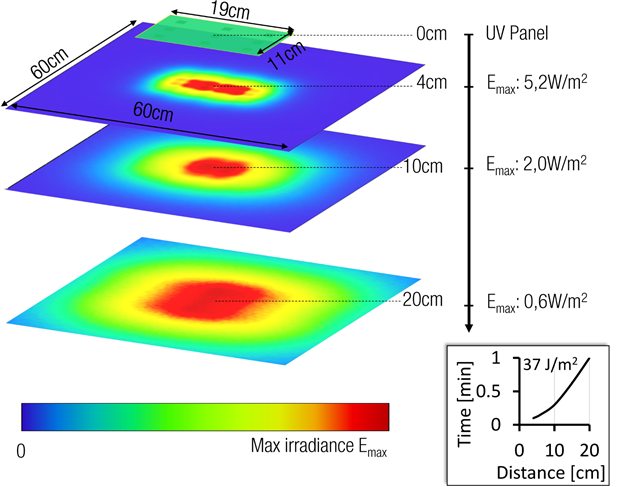

In Figure 5 the irradiation distribution for different heigths of a PCB with 9 WL-SUMW 15335327BA252 LEDs is shown.
Figure 5: Examples simulation of irradiation distributionimage
When the height increases, the irradiated area gets larger, but also the maximal irradiance decreases. As the irradiance decreases, the required exposure time for a certain dose increases with the square of the distance (Required exposure time ∝ Distance2) as shown in the inset for a dose of 37 J/m2 and in the following table:
Distance Irradiance
Exposure time required for:
Dose 37 ( J /   m2 )                     Dose 400( J /   m2 )
4 cm 5.2 W/m2 0.1 min 1.3 min
10 cm 2.0 W/m2 0.3 min 3.3 min
20 cm 0.6 W/m2 1.0 min 11.1 min
Table 3: Required exposure times for the example UV panel to achieve a certain dose, depending on the distance
This gives an indication of the required disinfection times and their dependence on the distance to the LEDs. Please note that this is just an estimation and the result depends on the LEDs and specific application. The performance in the application needs to be tested for each product separately.
