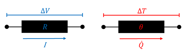

where     θWA   is the winding to ambient thermal resistance. Although this formula is simplified and only considers DC current, it still gives important information about how well the part can dissipate heat. More information based on the end application can be obtained using REDEXPERT, an online tool that accurately calculates losses and temperature rise for specific SMPS conditions. At this stage, it is important to clarify terminology and principles regarding electrical and thermal parameters. The derivation of thermal parameters evolved in much the same way as electrical parameters with similarities in Ohm’s law (Equation 4) and Newton’s law of cooling (Equation 5). For this reason, analogies can be drawn between electrical and thermal parameters (Figure 1).
   △V=IR (4)
   △T=  θ (5)
Figure 1: Visual representation of Ohm's law and Newton's law of cooling.

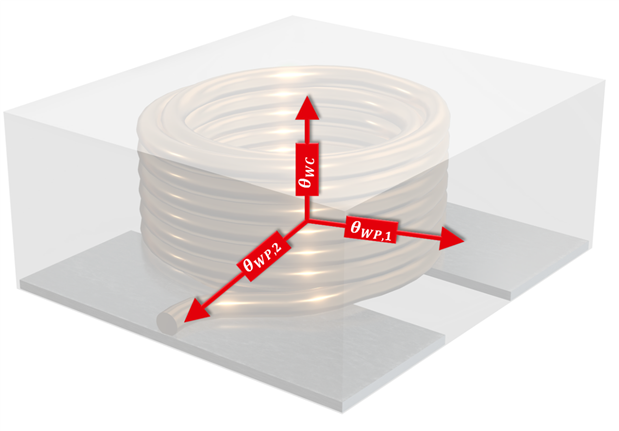

Heat flows through thermally conductive paths as electrical current flows through electrically conductive paths, Therefore heat generation is usually represented as a current source. Analogous to voltage drop across a conductor, the amount of current that can flow is limited by the conductive/resistive properties of the material, the cross section it flows through and the length of the path. This is equally true for temperature differentials between two thermally conductive paths. When considering a simple inductor model, there are two conduction paths of heat, through the winding to the solder pad and through the core to the outer surface of the core (Figure 2).
Figure 2: Visualization of thermal transfer paths in a simplified power inductor. Conduction through the solder pads is divided between the pads (    θWP1 and     θWP2 ).
where      θWC    is the winding to core surface thermal resistance and     θWP   is the winding to solder pad thermal resistance.

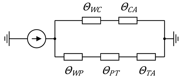

However, what additionally comes into play is the effectiveness of the thermal earth. The lower the ambient temperature is, the greater the temperature differential and the larger the heat flow. For a PCB mounted inductor, the surface area of the core and the PCB trace size together with its surface area represent the thermal resistances that connect the thermal circuit to thermal ground. Therefore, a full yet simplified thermal model of a power inductor can be defined (Figure 3).
Figure 3: Equivalent thermal model of a power inductor.
where     θCA   is the core surface to ambient thermal resistance,     θPT   is the solder pad to trace thermal resistance and     θTA   is the trace to ambient thermal resistance. What this thermal equivalent circuit demonstrates is that we essentially have parallel resistors and a number of voltage dividers. If one resistance value changes, the flow of heat (“current”) will change therefore resulting in temperatures (“voltage”) changing at different parts in the circuit.
Consider increasing the size of the part while keeping all other parameters equal. This will significantly decrease     θCA   resulting in more heat flowing from the winding, through the core to the ambient air and less flowing through the solder pad to the trace and ambient air. Indeed this is what is typically observed with larger power inductors transferring more heat to the air whereas smaller inductors with smaller surface area transfer a greater proportion of heat to the PCB. Now consider increasing the thickness of the winding meaning lower thermal resistance from the winding to the trace. This will mean a lesser proportion of the heat will flow from the winding to the core surface with more flowing to the PCB trace. This behavior is typically observed in high current power inductors that use thicker winding to handle higher currents. Therefore, having a thicker wire both decreases self-heating and increases heat dissipation.
Both of the cases above facilitate the flow of heat from the winding to the ambient resulting in lower self-heating of the part. This means they can be operated at higher currents than smaller inductors that use smaller diameter wire.

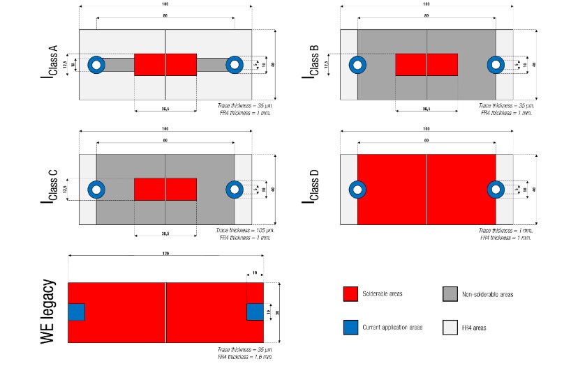

Würth Elektronik endeavors to be transparent with the disclosure of the measurement procedures used and the reporting of rated current (Ir ) data of the temperature rise of power inductors. The method used is based upon section 6 of the IEC 62024-2:2020 standard. The test PCB is contained within a box of roughly 20 cm on each side. The test PCB does not contact directly with the surrounding box. Only natural convection occurs, with no forced convection applied to the test PCB. Würth Elektronik measurement differs from the standard in that an infrared camera is used in place of thermo-couple. This is done to eliminate measurement error caused by placement of the thermocouple. In this way, the hottest external area of the magnetic core is measured. Current is passed through the sample with the temperature allowed to stabilize to less than 1 °C per minute.
Due to the range of sizes and construction types of the Würth Elektronik portfolio, a number of PCBs have been used, but primarily follow that of section 6.3 of the standard (Figure 4). For IEC  IClassA   PCBs, the trace width is different dependent on the rated current (Table 1).
Irrespective of the PCB used, it should be remembered what rated current values on datasheets actually represent. These values are not absolute that can be applied to any application. They are there to give a rough guide as to the current range they can be used in and to serve as a parameter for comparison with other power inductors. The thermal characteristics of a power inductor are influenced by so many factors, it is impossible to characterize the behavior in the final application. This is where precise knowledge of the measurement technique becomes extremely useful to the design engineer. When all parameters are known, rated current values cannot be manipulated facilitating manufacturers to be transparent and consistent avoiding the sham of rated current.
Figure 4: Diagram of PCBs used for rated current measurements

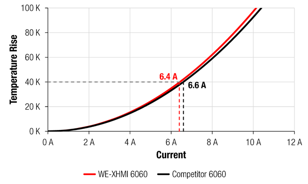

Interestingly, in both comparisons the competitor parts have a higher rated currents stated in their datasheets despite having a higher RDC than the WE parts (Table 2). The rated current of both inductors were measured and compared using the IEC 62024-2:2020 measurement set-up. For each comparison measurement, the same measurement set-up, the same contacting method and the same type of measurement board were used. The WE-LHMI and its competitor on the     IClassC   and the WE-XHMI and its competitor on the   IClassD .
Ref. no.SizeInductance (μH)Rated Current (A)Performance Rated Current (A)Saturation Current (A)DC Resistance (mΩ)
744 373 460 6870306.83.44.458@ 20% L drop54
Competitor 703070306.84.58@ 20% L drop54
744 393 46 1006060105.06.49.7 @ 30% L drop26.5
Competitor 60606060107.07.6 @ 30% L drop27
Table 2: Comparison of datasheet parameters

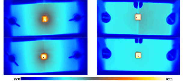

Figure 5: Thermal images of WE-LHMI 744 373 460 68 (upper) and competitor 7030 (lower)Figure 6: Thermal images of WE-XHMI 744 393 46 100 (upper) and competitor 6060 (lower)

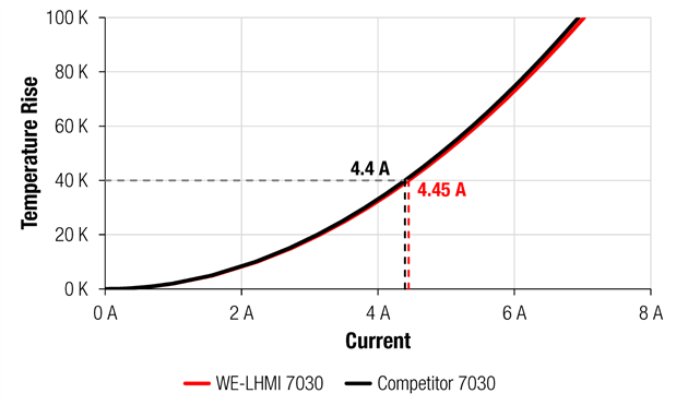

Figure 7: Self heating comparison of WE-LHMI 744 373 460 68 (red) with competitor 7030 (black)
Figure 8: Self heating comparison of WE-XHMI 744 393 46 100 (red) with competitor 6060 (black)
The temperature of both coils were measured with a thermal imaging camera. DC current was applied to the test boards until at least 65 °C was reached, 40 K above ambient 25 °C (Figure 5 and 6). Despite having a higher rated current value on the datasheet, the competitor 7030 part had a lower heating current of 4.4 A when compared to the 4.45 A of the WE-LHMI, measured on the same IClassC   PCB (Figure 7). Similarly, the WE-XHMI had similar heating current values to the competitor 6060 part, 6.4 A compared to 6.6 A (Figure 8) when measured on an  IClassD   PCB. It must be noted that small deviations in the self-heating curve can be caused by component tolerances, especially in RDC, and can occur even when comparing coils of the same construction originating from the same series from the same manufacturer.
This raises questions about how manufacturers achieved this level of heat dissipation. The use of bus bars, heat sinks, and forced convection can all be used to achieve higher heat dissipation. This should be remembered when comparing rated current values and selecting parts for prototyping.

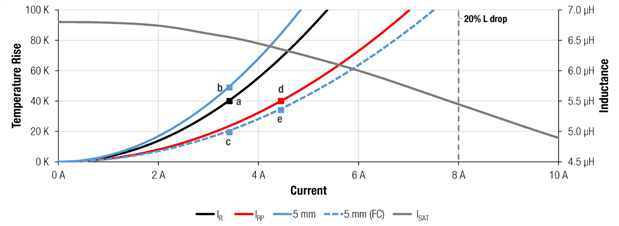

6 Performance Rated Current

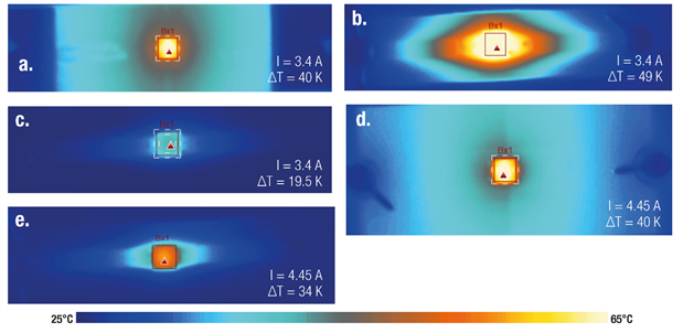

For some power inductors, an additional rated current, specified as Performance Rated Current (IrP), may be included on the datasheet. This is the rated current of the part measured on an IClassC or  IClassD  PCB. Some may argue, why use IClassC and  IClassD  PCBs for testing the rated current? As discussed, increasing the PCB area and thickness increases heat dissipation, leading to higher rated current values. Essentially, the larger trace area and thicker trace layer is to replicate the effects of using multilayer boards, heat-sinks and forced convection that are increasingly being utilized by electrical engineers. This is especially noticeable in automotive and e-mobility applications.
Consider the WE-LHMI (744 373 460 68) which has a rated current of 3.4 A (Figure 9a) and a performance rated current of 4.45 A (Figure 9d) measured on a WE Legacy and IClassC respectively (Figure 10a and 10d). Using the part on a 5 mm wide trace at the rated current results in a temperature rise of 49 K (Figure 9b and 10b), well within the operating temperature of the part. If the application includes forced convection (FC) for reasons of thermal management the same part on the same PCB at the same current results in a 19.5 K temperature rise (Figure 9c and 10c). Although this may be desirable in some applications, there is a lot of thermal “head room”. When the performance rated current of 4.45 A was applied to the part on a 5 mm wide trace with FC, the temperature rise was 34 K.
This comparison demonstrates how the performance rated current ( IrP ) parameter mimics application conditions that implement thermal management methods. Indeed, in this scenario the inductor could be operated at even higher currents as long as it is below that of the inductance drop ( ISAT ) permitted by the specific application. It also demonstrates that  Ir   and  IrP are numbers to compare and guide in the selection of inductors before prototyping. It should be remembered that these are basic parameters, considering only DC currents with no additional heat generating parts on the PCB. In real conditions, AC losses and the thermal effects of surrounding components would also have to be considered. The actual temperature rises seen in the end applications will vary considerably dependent on the conditions.

Figure 9: Self heating comparison of WE-LHMI 744 373 460 68 on different PCBs and conditions.  Ir = WE-LHMI measured on the WE legacy PCB, IrP = WE-LHMI measured on IClassC PCB, 5 mm = WE-LHMI measured on 5 mm trace width,5 mm (FC) = WE-LHMI measured on 5 mm trace width with forced convection and ISAT = the magnetic DC saturation of the WE-LHMI.
Figure 10: Thermal images of WE-LHMI 744 373 460 68 on different PCBs and conditions.
