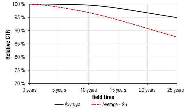

In the following, an example of the acceleration factor calculation and its application to stress test results is shown. The test duration is 1000 h at Ttest = 110 °C and a LED forward current Itest = 30 mA. If the optocoupler is used with 100% duty cycle at a forward current of Inorm = 5 mA and is operating at ambient temperature Tnorm = 80 °C, the acceleration factor is AF = 218. So, according to the Black formula (3), the acceleration stress test of 1000 h simulates a normal field use of almost AF ⋅ 1000 h = 218 ⋅ 1000 h ≈ 25 years.
Figure 2 shows the CTR degradation that is expected within these 25 years. It shows for the Würth Elektronik optocouplers that in average, no more than 5% degradation of the CTR value is expected.
Figure 2:Expected CTR degradation with field time. Parameters for field use: 100% duty cycle, 80°C ambient temperature, 5 mA forward current. Stress test parameters:
1000 h test, 110°C test temperature, 30 mA forward current
The Average - 2σ relative CTRs are also given as a dashed line. Statistical distribution gives the variance 2σ as the amount of variation in the data. In other words – around 68% of the relative CTR values are inside of 1σ distance from the average value. Similar, 95% of the relative CTR values is within the 2σ confidence interval. When considering figure 2, the 2σ curve shows the lowest expected relative CTR degradation is not less than 87% within 25 years.
