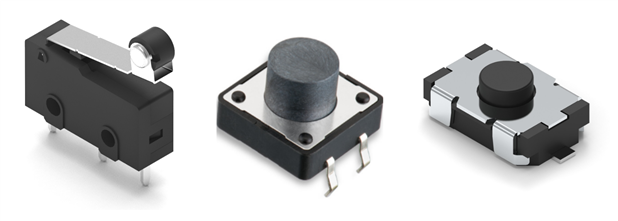

Würth Elektronik offers a wide range of switch products. These products are used for many applications to simply open and close electronic circuits.
Figure 1: Part of the WE-switch portfolio

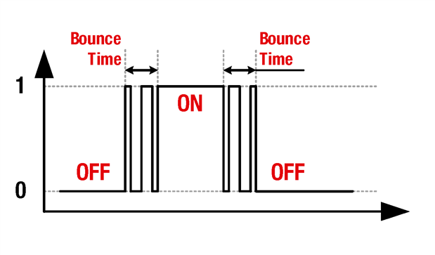

2 What is contact bounce
2.1. Principle of switching mechanics

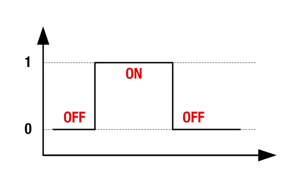

We naturally have the impression that the contact in a switch is immediate and firm.
Figure 2: Idealized graph of a switched signal
However, the “reality” looks a little bit different.
Figure 3: Idealized graph of a “real” switched signal

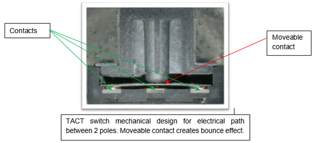

At each switch position, contact between electrically conductive points is established or separated by means of movable mechanical elements.
Figure 4: TACT switch design
Typically, spring components are used as transmitters of the nominal state, either as a metal plate or as a coiled spring, which have a certain mass and thus a certain moment of inertia. When these small components are set in motion for a change of state, they are accelerated until they have reached the desired position. There, they experience a reverse acceleration due to the principles of elastic shock and their spring characteristics. This effect occurs several times in succession until the movement is completely damped. As the damping factor is high and the moment of inertia is small, the effect itself typically only takes a few microseconds. This is not problematic for power circuits but this rebounding signal on status change creates bad transitions for a digital input. During the status change, the electronic signal has an unstable or better said undefined status. For a logic IC this can be really problematic, as it needs a clean defined signal. A microcontroller reading the port may miss the changed state if read at the wrong moment. Therefore a solution is needed to generate a clear output from the switch and we will take a look at a switch debounce circuit to solve this problem.

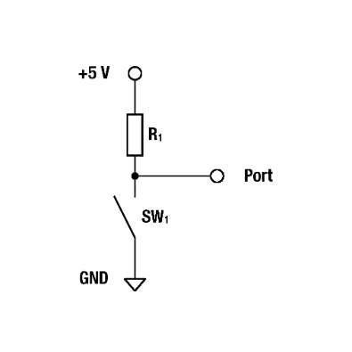

The base switch circuit with no debounce compensation circuit looks like the following:
Figure 5: Switch circuit without debounce circuit
Classical values for resistor are     R1   = 1 kΩ to 10 kΩ and     VCC   = 5 V.

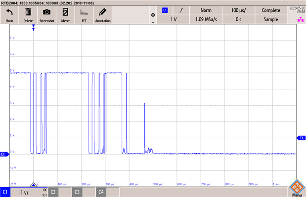

Pushing the switch gives the following switching response that shows the bounce effect:
Figure 6: Output without debounce circuit during high to low transition

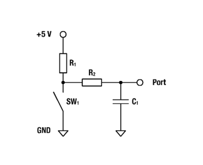

To solve this bounce in the     VOUT   signal, a different electronic circuit is proposed. The following electronic circuit, a simple RC filter is one of the cheapest and simplest to realize. When the switch is open the capacitor charges through     R1+R2   which causes the voltage to rise more slowly. When the switch is closed, the capacitor is discharged through R2 at a controlled rate.
Figure 7: Switch circuit with a basic debounce circuit
When the components are selected carefully, the switch bouncing is absorbed during the charging or discharge period providing a smooth transition.
To calculate the value of capacitor and resistors, we need to know the following time constant formula applicable for this schematic:
ꞇ =     (R1+R2)×C1 (1)
ꞇ : time constant in s
R : resistor value in Ω
C : capacitance value in F
The time constant is a balance between the needs to debounce the switch and the required response time of the circuit. During one time constant the voltage will rise to 63% of its final value or fall to 37% of its final value. In both cases, 99% is reached after five time constants.

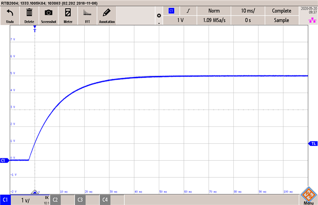

For both circuits, the answer becomes like following:
Figure 8: Output with debounce circuit during low to high transition
Note: Resistance and capacitance values, could vary according to customer circuit design
The value of UOUT vs. time is given by the next formula
   UOUT=UIN×(1−e−tꞇ )   (3)
We see that at t = ꞇ, we reach a value of UOUT ≈ 63 % UIN.
In our example UOUT is at 63 % (3.15 V) of its final value (5.0 V) after 10 ms.

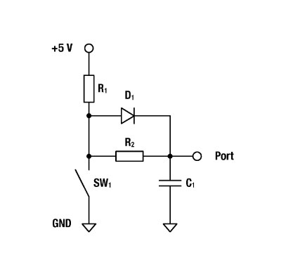

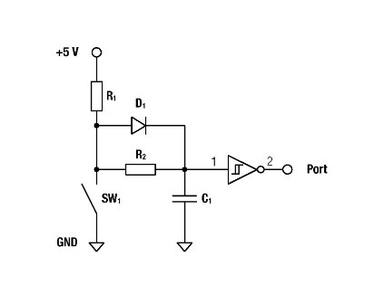

3.3. Adding a diode
It is possible to control the charge time and discharge time separately by adding a diode across R2. This allows for a faster transition time to charge the capacitor using R1 and  D2   and a different discharge time using only R2, as in this case the diode is blocking.
Figure 9: Adding a diode to the schematic
3.4. Adding a buffer
The user must also be aware the digitial logic is defined with zero being below a certain voltage (ie. 0.8 V) and one being above a certain voltage (ie. 2.5 V). The values between are undefined. If the application cannot support the undefined values a Schmitt trigger buffer with hysteresis may be required. A circuit with different switch-on and switch-off times and additional hysteresis is shown in figure 10. The response time of the circuit may have to be coordinated with the sampling time of the microcontroller.
Figure 10: A schmitt trigger enures stable and defined voltage values

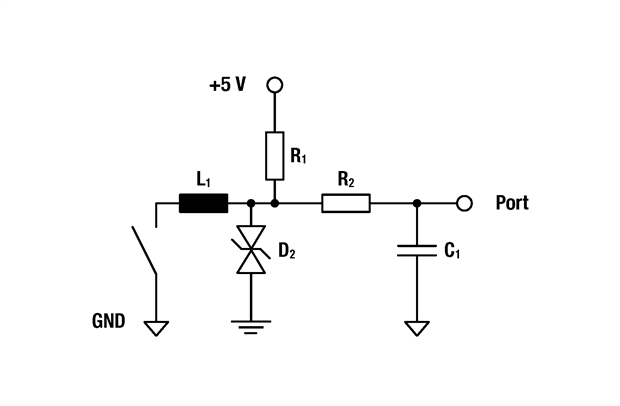

3.5. Transient protection
If the switch is located far away or at the end of a long wire, there will likely be a need for protection against overvoltage, ESD or other transients. This can be as simple as a ferrite bead and TVS diode in front of the input circuitry.
Figure 11: Adding a ferrite bead and TVS diode for overvoltage protection
