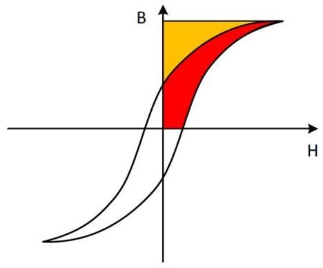

B is measured as H is increased. The response of B versus H is nonlinear and exhibits hysteresis, hence the name hysteresis loop. Hysteresis is one of the core-material characteristics that will cause power losses in the inductor core. A typical B-H curve is shown in figure 1 when a sinusoidal excitation is applied to the core.
Energy loss due to the changing magnetic energy in the core during a switching cycle equals the difference between magnetic energy put into the core during the on time, and the magnetic energy extracted from the core during the off time.
By using Ampere’s & Faraday’s Law, the Energy in the core can be expressed as:
Energy lost in the core is the area traced out by the B-H loop multiplied by the core’s volume. The power loss is this energy (E) multiplied by the switching frequency.
This expression applies on the conditions that the core is not driven into saturation, and the switching frequency lies in the intended (linear) operating range. The hysteresis loop area (red region in fig 1) represents energy loss. Power loss depends on how many times per second the hysteresis loop is traversed. Thus, hysteresis loss varies directly with frequency.
Fig 1: B-H Curve

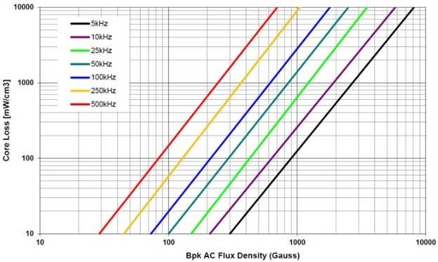

4. Determination of Losses
Historically, core losses are estimated by using power equation (1), also called Steinmetz equation.
is the core loss (Hysteresis & Eddy current loss) for unit volume,    is peak flux density of a sinusoidal excitation,   ,    &    are the constants, derived from core loss graph shown in Figure 2.
The data given in figure 2 for core losses usually includes the effects of both hysteresis and core eddy currents.
Core-loss measurements are difficult because they require complicated setups for measuring flux density and because they involve the estimation of hysteresis-loop areas. For plotting these curves, a sine wave is applied to a toroidal (ring) core with 1 or 2 coil winding with 1 turn and extracts various data to plot the core loss chart. Then the constants are calculated using the graph in figure 2.
The major drawback of the Steinmetz equation is that it is mostly valid for sinusoidal excitation. This is a huge drawback because in most power electronic applications, the Inductor is usually exposed to non-sinusoidal flux waveforms. Even though there are other models which separates hysteresis & eddy current loss to overcome the problem of non-sinusoidal waveforms, the empirical Steinmetz equation has proven to be the most useful tool for sinusoidal flux-waveforms, because it provides better accuracy and is quite simple to use. Hence there are extensions to this power equation to make it accurately effective for non-sinusoidal flux waveforms.
Figure 2: Core Loss graph plotted against peak flux density at different frequencies

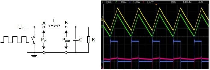

5. The Würth Elektronik AC Loss Model
Würth Elektronik eiSos has developed state of the art model, allowing customers to effectively select the inductor and optimize the system. The model is based on the empirical data, derived from real time application set up.
In the Würth Elektronik eiSos model the total loss of the Inductor is divided into two separate losses as AC loss and DC loss. The power dissipation occurs due to DC current in the inductor windings and will be listed as the DC loss. The additional power loss occurred due to AC flux swing in the coil and the core is termed as AC loss.
The DC-DC converter as shown in figure 3 is utilized to produce an empirical data. A pulsating voltage is applied over the Inductor and the power Input,        are measured, then           =       −         is estimated and then AC loss of the Inductor       is separated. This process is repeated over wide range of parameters including variation of peak flux density swing, frequency, ripple current, etc., to produce the empirical data. This empirical data is then used to create an equation to calculate AC loss in the form of       =    (Δ  ,        ,    ,  1,  2).
Fig 3: Setup of DC-DC Converter for Loss Determination and resulting scope shots

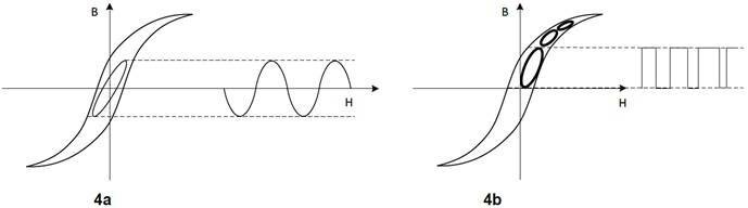

The hysteresis loops shown in the typical core material data sheets represent the core overdriven by a sinusoidal waveform from + to - saturation and the hysteresis loop area represents energy loss shown in figure 4a. This is the same approach used to produce empirical data for the core loss charts as shown in figure 2.
But in an SMPS application, the core is usually driven by a much smaller rectangular waveform with peak flux density limited by core losses to a minor hysteresis loop as shown in figure 4b. Power loss depends on how many times per second the hysteresis loop is traversed. Thus, hysteresis loss varies directly with frequency. The hysteresis loop changes shape somewhat with wave shape, current or voltage drive, and temperature. This variability, makes it very hard to predict core loss accurately. The minor loop area depends on the voltage above the Inductor. This minor loop is followed by the point of operation approach of Würth Elektronik to produce empirical data for Würth Elektronik’s AC loss model. Hence, this approach has proven robust, accurate over wide range of parameters like frequency, ripple current and duty cycle.
Fig 4a & 4b: Typical modelling used for Steinmetz equation and it’s extensions on the left and Würth Elektronik’s point of operation approach on the right

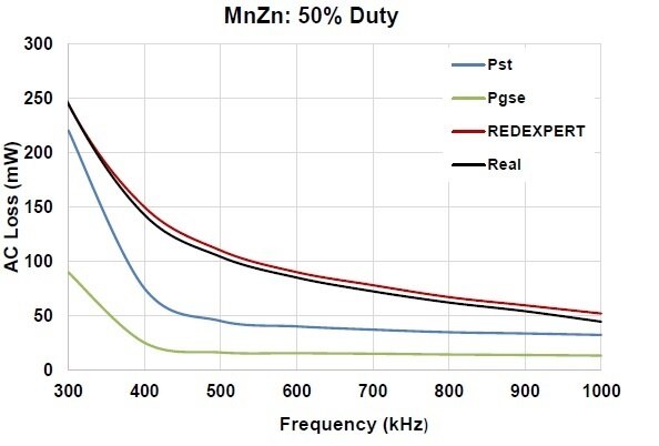

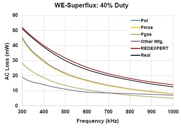

6. Performance of the Würth Elektronik AC Loss Model

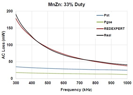

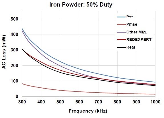

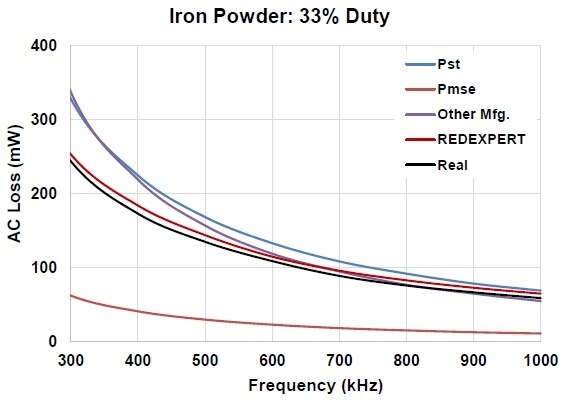

Würth Elektronik model has been validated extensively and compared with existing models and measured data. The AC loss for various materials like WE-Super flux , Iron powder, NiZn, MnZn, etc., are measured at a wide range of duty cycles, frequencies and other parameters compared with theoretical models as shown in figures 5 to 9. In below charts Pst, Pmse, Pgse are core losses determined using Steinmetz power equation, the Modified Steinmetz equation and the Generalized Steinmetz equation respectively. REDEXPERT is the AC loss calculated using Würth Elektronik AC loss model. Real is the measured AC loss.
Fig 5: Inductor made of WE Superflux at 40% DC Fig 6: Inductor made of MnZn material at 50% DC
Fig 7: Inductor made of MnZn Material at 33% DC Fig 8: Inductor made of Iron powder at 50% DC
Fig 9: Inductor made of Iron Powder Material at 33% DC

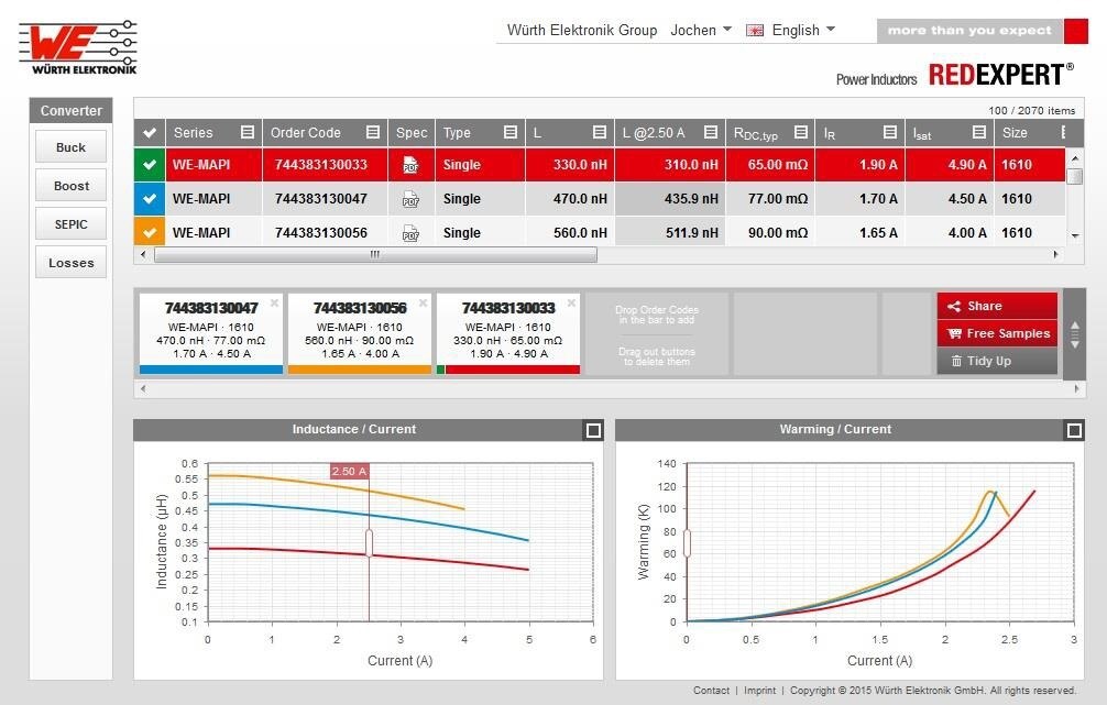

7. Determination of Power Inductor Losses with REDEXPERT

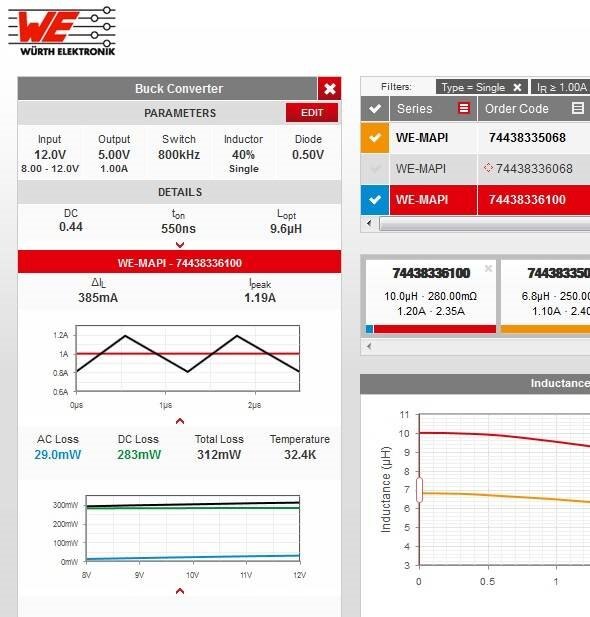

REDEXPERT is Würth Elektronik’s new online component selection and simulation tool which gives an option to the customer to select an appropriate power inductor based on the application. REDEXPERT is simple and effective tool, which allows an engineer to compare and select the inductors in no time. Once, the user enters their input and output parameters in the desired topology, the tool will calculate the inductance value and display the inductor choices. A screenshot of REDEXPERT web tool is shown in figure 10.
Fig 10: Screenshot of the REDEXPERT online tool
Since, Würth Elektronik eiSos has a wide range and variety of inductors, there is a good possibility that the user is filled with options. Then the user can chose the inductor according to the size & performance which suits the application. Calculating AC loss in a magnetic component is critical and complex, but not with REDEXPERT as the new Würth Elektronik AC model is implemented in this tool. With AC loss being calculated accurately, the estimation of temperature of a component is also apt with the application.
An example is shown in figure 11. A buck converter has been chosen. The operational parameters are 8 – 12 V is given as the input voltage, 5 V is given as output, switching frequency as 800 KHz, with inductor ripple as 40% and output current as 1 A. The REDEXPERT tool has estimated the optimal inductance (Lopt) as 9.6 μH, Ton as 550 ns and duty cycle as 0.44 and it has displayed more than 200 inductors to choose from. Let’s assume that the application requires miniature and low loss Inductor, the WE-MAPI series is the one we have chosen.
Currently REDEXPERT has three topologies Buck, Boost and SEPIC where the user can select the component for those applications. Furthermore, there is a Loss calculator for single inductor irrespective of the topology. REDEXPERT is a web based tool and the user does not have to bother about downloading and updates.
Fig 11: Buck-Converter Example
