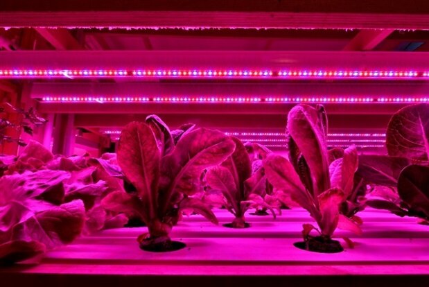

Greenhouse farms may not be a new technology but with an every growing world population and the move towards sustainability, intensive yet highly efficient and standardized food production will increasingly become the norm in future years opening a potentially huge new agricultural sector that incorporates the latest technologies from the bioscience and engineering fields. But how can researchers and personnel from these separate fields understand the mutually dependent requirements of indoor greenhouses?
Greenhouses have a long history, purportedly from the roman era but were not used for viable intensive cultivation until the 20th century. Nowadays, there are millions of controlled protected plant enclosures all over the world, most of which use natural light. However, advancements in lighting, heating, watering and control systems have allowed the construction of vast, artificially lit, indoor greenhouses (Figure 1). These installations can produce significantly larger yields, than conventional agriculture and low-tech greenhouses.
Figure 1: Example of indoor greenhouse plant bed with LED light source
There are also several other advantages. The different stages and cycles of plant development can be controlled by providing different wavelengths of light to gain greater yields or reduce growing times. Water usage is greatly reduced due to reduced evaporation and the control of humidity and temperature in the installation. The control or elimination of insectile, fungal or bacterial pests is also more effective because of the closed system. In addition, the carbon footprint of food production and supply can also be significantly reduced by building the installations close to population centers, reducing transport requirements.

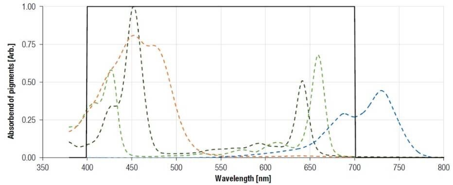

Photosynthesis is the process that converts water and carbon dioxide into complex carbohydrates (i.e. sugars) and oxygen using energy from light. However, although the energy radiated by the sun that reaches the earth’s surface consists of the entire spectrum of visible light (and more), plants only utilize specific frequencies of light for photosynthesis. These frequencies are related to the absorption characteristics of different pigments that are present within organelles called chloroplasts that are responsible for different functions of photosynthesis. The majority of these pigments absorb light in the wavelengths that correspond to the colors blue and red. This is why most leaves appear green as these wavelengths are not absorbed, and carrots appear orange as they contain very little chlorophyll. The most common pigments are chlorophyll A, chlorophyll B and the carotenoids.
Figure 2: Characteristic absorption spectra of different pigments used for photosynthesis [1]
These frequencies are called the photosynthetic active radiation (PAR) region and defined as 400 to 700 nm. Chlorophyll A is the primary photo-pigment accounting for around 75 % of photosynthetic activity and has absorption peaks at ~435 nm and ~675 nm. Chlorophyll B, once thought to be an accessory photo-pigment, extends the range of wavelengths that can be used for photosynthesis with absorption peaks at ~460 nm and ~640 nm. Energy from these wavelengths is captured by chlorophyll B before passing it to chlorophyll A through electron spin resonance. All higher plants have these two pigments accounting for their green color.
Carotenoids have a comparatively much wider wavelength absorption range than the chlorophylls with an absorption range of ~400 nm to ~510 nm. In addition to their accessory light harvesting function, they have a much more complex role than initially thought, protecting chlorophylls from photooxidation when light intensity is high, in the low wavelength (i.e. higher energy) wavelength ranges [2]. This is why the absorption wavelengths of the carotenoids overlap with that of the chlorophylls. Additionally, phytochromes are photoreceptors (light sensors) that regulate numerous processes, such as chlorophyll synthesis. In spite of the absorbance wavelengths laying mostly outside of the PAR region, they are critical to plant development.

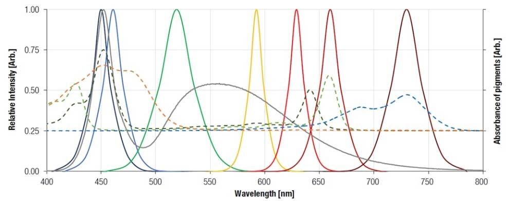

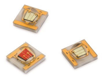

Tomeet these requirements,Würth Elektronik offers the WL-SMDC SMD Mono-color Ceramic LEDWaterclear range of LEDs (Figure 3). The WL-SMDC range has been expanded to include wavelengths of 450 nm (Deep Blue), 660 nm (Hyper Red) and 730 nm (Far Red), which have been selected to match the absorption spectra of photosynthetic pigments. In addition to the existing products in the range, a diverse range of combinations is possible that can be catered to the target cultivar (Figure 4).
Figure 3: Würth Elektronik WL-SMDC SMD Mono-color Ceramic LED Waterclear
Figure 4: The emission spectra of WL-SMDC LEDs overlaid on the absorption spectra of photosynthetic pigments

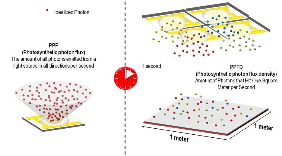

  • Photosynthetic photon flux (PPF, μmol·s-1– this quantifies the total amount of photosynthetically active photons that are produced by LEDs each second. Although it may seem strange to an electrical engineer to quantify the output of a light source by the number of photons emitted, it must be remembered that photosynthesis is a biochemical process that can be quantified by the number of sugar molecules generated per number of photons, even though photons of different wavelengths have different energy levels. The conversion from electrical power to PPF is performed using the Plank-Einstein relation and Avogadro’s number and is the sum of all photons generated in the wavelength range.
Figure 5: The difference between Photosynthetic Photon Flux on the left and Photosynthetic Photon Flux Density on the right with several colors
  • Photosynthetic photon flux density (PPFD, μmol·m-2·s-1)– this quantifies the total amount of photosynthetically active photons that reach the target area per second. This parameter is highly reliant upon the distance and angle from the source. This is usually measured using a quantum meter sensitive only to PAR wavelengths.
