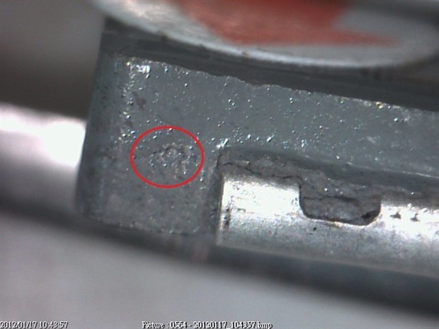

2.1. Hairline Crack: Side View
Cracks around the core are nearly impossible to eliminate as the molding process involves curing the resin binder and iron powder together. During this process small cracks are caused by wall friction when ejecting the component.
Unlike in ferrite powder inductors, minor to moderate and major cracks may occur and they do not affect the performance of
WE-LHMI series. In order to ensure best quality, Würth Elektronik eiSos has set up standards for production department to control the intensity of cracks before release.
Figure 1: Hairline crack and definition of H
The length of the hairline crack should be less than one third of the H on its left and right side of the terminal otherwise they are deemed as rejected parts at production. H is defined in figure 1.
Figure 2: Acceptable minor crack on left side of terminal
Figure 3: Acceptable moderate crack on right side of terminal
Figure 4: Acceptable major crack on right side of terminal
Visual inspection takes place during the manufacturing process. This is generally done under magnifying glass, CCD camera or 10x optical inspection. This gives an accurate measurement of any imperfections. As shown in figures 2 and 3, there is evidence of visual cracking but as this is within specification these are perfectly useable as the crack is less than 1/3 of height H., whereas figures 1 and 4 show rejected parts at production line. All other cracks must be less than the height H to be accepted.

2.3. Chip off
Chip off can occur during the manufacturing process of LHMI products. Even though the amount of chipping does not have any affect until the coil is exposed or broken,Würth Elektronik eiSos has set up standards to facilitate customer concerns and visual appearance. Chipping typically occurs on the edges, surface and corners of the inductor as shown below.
Figure 8: Chip off at various Locations
Figure 9: Acceptable chip off at surface junction
WE-LHMI parts are only accepted during production if the chipping on the surface is less than 1 mm, alternatively the chipping at two surface junctions is less than 1,2 mm and the chipping at surface of three junctions is less than 1,5 mm.
