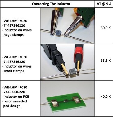

Even within the test chamber there are influences that can significantly falsify the measurement result. During measurement, the coil's connection to the current source is critical, as unwanted heat dissipation produces falsification of the measurement results. For this reason, care is taken at Würth Elektronik eiSos that the component's heat coupling to the environment during measurement is as low as possible. Figure 2 shows a reference measurement with various contacting options for a coil.
Figure 2: Comparison of contacting options
For this reference measurement the Wrth Elektronik eiSos WE-LHMI series coil 744373460082 in the 7030 package is used and a current of 9 A is passed. The type of contacting significantly influences the measurement result. The greater the mass of the contacts, the more heat can be dissipated from the contacts and the lower the relative temperature change of the coil. The first example from the reference measurement shows, for example, that a WE-LHMI with 7030 package only heats up by 30.9 K if the coil is connected by soldering the wires and is contacted via large clamps. With smaller clamps at the same current, the temperature rises by 35.8 K. This type of contacting is not practical, however. In its datasheets, Würth Elektronik eiSos recommends a pad design for each coil, which serves as the basis for such measurements. In order to reflect the standard during measurement, FR4 of 1.5 mm thickness is used as the substrate material and 35 μm copper, chemically gold plated. The rated current is measured using the fourpole method so the resistance of the connection to the power supply is kept as low as possible. This also avoids high heating of the measurement cables.
Figure 2 shows the third contacting option as a circuit board, which is used as an example with the coil from the WE-LHMI product family and 7030 package. At a current of 9 A the coil heats up by 40 K. This reference measurement shows that the temperature difference can be up to 9.1 K. Generally, many coil manufacturers make no statements about the contacting method, so their measurement method cannot be reproduced. However, if two coils of identical construction from different manufacturers are measured with the same measurement and contacting method, the same results should be obtained.

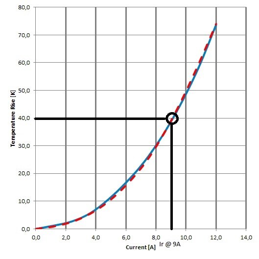

Interestingly, the rated current differs by 4 A between the two coils. Theoretically, there can be no difference given the same package and same RDC. As an experiment, the rated current of both coils was measured and compared using the Würth Elektronik eiSos measurement set-up. For both measurements, the same measurement set-up, the same contacting method and the same measurement board were used. Figure 3 shows the characteristic curve of the reference coil (in blue) is almost identical to the characteristic curve of the WE-LHMI 744373460082 (red dashed line).

On the right of Figure 4 the temperature of the other coil at the same rated current minus the room temperature is shown. It is 40.7 C°. The difference between the two temperature measurements is just 0.6 K and is attributed to component tolerances. Both characteristic curves show self-heating of 40 K at a rated current of 9 A. In addition, the two coils of the same package type have the same resistance value of 6.7 mΩ. As a result, both coils have the same power loss "PDCLoss":
This fact implies that the rated current of the other component is determined with a measurement method with which there must be a high level of heat dissipation. The low deviations in the characteristic curve are caused by component tolerances. They occur even when comparing coils of the same construction originating from the same series from the same manufacturer.
