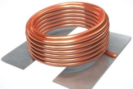

WE-MAPI is the latest and most innovative series of coils from Würth Elektronik. Conventional coils mostly use enameled copper wire wound around the core and soldered or welded to the terminal with a clip.The outer shielding ring is then mounted and bonded with the inner core and the winding.

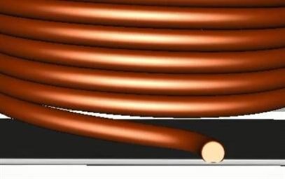

Figure 1: View of the WE-MAPI and the direct contacting of the wire with the connection pads
WE-MAPI breaks new ground and the winding is contacted directly with the component's connection pad without soldering and welding. Saving the clip allowed the effective diameter to be increased, which means fewer windings are needed for the same inductance values. This is directly expressed in a considerably reduced DC resistance (RDC) of the winding. In the application, the start of the winding of the coil is usually connected with the switching node of the switching controller – a marking on the component indicates this. Consequently, the spatial expansion of the "hot" switching node is minimized and coupling effects through the outer part of the winding at a "stable" potential are also shielded.

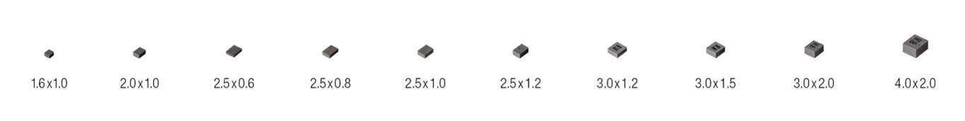

The WE-MAPI series components are available in many different package sizes from 1.6² x 1.0 mm, up to 4.0² x 2.0 mm.
Figure 3: Overview of the available package sizes for WE-MAPI

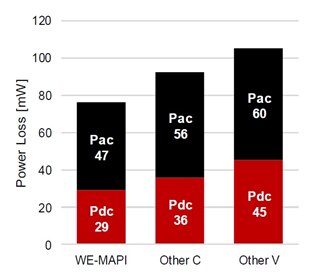

The importance of AC losses in modern switching controllers can be ascertained with a simple set-up and measurement of the relevant losses. As an example, we take a buck converter with an input voltage of 24 V. At the output there is 12 V with 2 A. The clock frequency is 500 kHz. In Figure 4, a WE-MAPI 4020 series power inductor with 2.2 μH is compared with power inductors of the same package size. It is clearly apparent that with all the coils measured, the AC losses outweigh the DC losses.
Figure 4: AC and DC losses of a 2.2 μH coil, buck converter with 24 V to 12 V, 2 A, 500 kHz

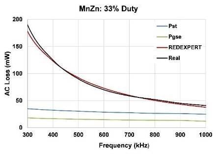

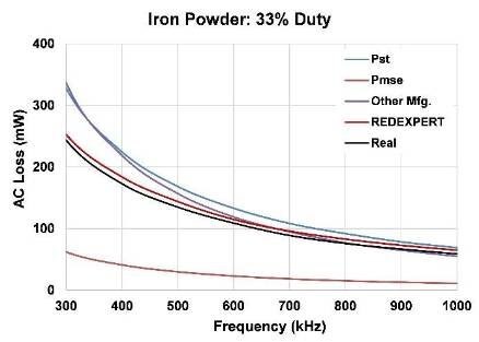

The model from Würth Elektronik has been extensively validated and compared with existing models and measured data. AC losses for different materials, such as WE-Superflux, iron powder, NiZn, MnZn, etc. have been measured over wide duty cycle and frequency ranges and compared with theoretical models (Figure 6). The following graphs show the core losses determined with the Steinmetz power equation (Pst), Modified Steinmetz equation (Pmse) and the Generalized Steinmetz equation (Pgse). REDEXPERT shows the AC loss following calculation with the AC loss model from Würth Elektronik. The measured AC loss is “Real”.
Figure 6: Inductor made of MnZn and iron powder at 33% DC

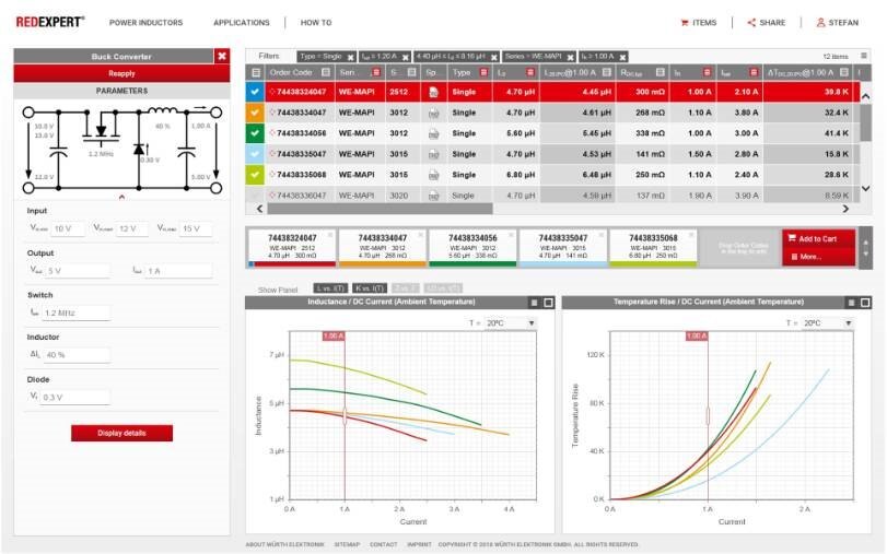

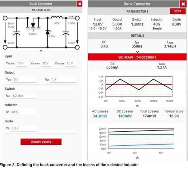

REDEXPERT is the new online design tool from Würth Elektronik eiSos used to select a suitable power inductor for the respective application. REDEXPERT is an easy-to-operate and effective tool, enabling components to be compared and selected within the shortest time. Firstly the user enters the input and output parameters for the required topology. REDEXPERT then calculates the necessary inductance value and displays the suitable inductances. Figure 7 shows the REDEXPERT screenshot.
Figure 7: Simulation of a buck converter in REDEXPERT with WE-MAPI components
The calculation of AC losses in a magnetic component is just as critical as it is complex, but not with REDEXPERT, as the AC loss model from Würth Elektronik is integrated. Based upon accurate calculation of the complete AC losses, the application is also suitable for temperature estimation.
Currently REDEXPERT supports three topologies in which the component can be selected for the application: buck, boost and SEPIC converters. The losses are displayed graphically over the complete input voltage range in order to also take extreme scenarios into consideration. This way the most energy-efficient power inductor for the respective application can be selected in next-to-no time.
In order to determine the right inductor for a buck converter, enter the existing input voltage range and the output voltage and current in the input screen (Figure 8), as well as the switching frequency, the diode flow voltage and the targeted ripple current of the inductor. By clicking on "Display details", the suitable power inductor is obtained, including its anticipated ripple currents and the losses in the application.
