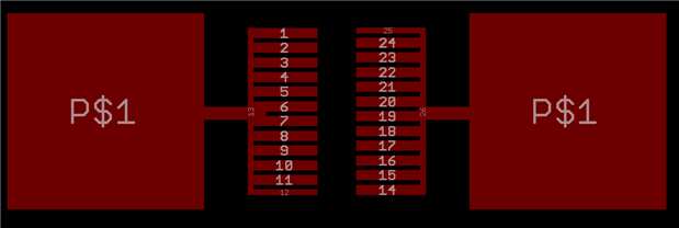

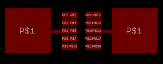

3.1. Custom Land Pattern
It is a known technique to implement a cross hatch pattern on the thermal pads of the large QFN–package ICs, such as processor ICs. Similarly, the idea of custom land patterns of different geometries and orientations was implemented and subjected to experimentation. The main aim was to see, if the wetting process of the solder paste was faster than the outgassing process, which would result in stronger joints and voids reduction. The land patterns were purposely made a little bigger than the foot print of the WE-MAPI in order to get a meniscus and to accommodate for the outgassing process.
Keeping in mind the points mentioned above, land patterns of various orientations and pitches were designed. Pre-tests were carried out, to check as to which land pattern would yield the best result. After the pretest the 180° rectangles and distributed squares showed to have best results as shown below:
Figure 1: Distributed squares (for MAPI size 3mmx3mm)
Figure 2: 180° Rectangles (for MAPI size 3mmx3mm)

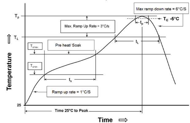

3.2. Reflow Profile
We have used lead free solder paste (SAC alloys) for experimentation purposes. It is a common understanding that reducing the solder paste will help in minimizing voids. This is usually implemented by making a pattern on the stencil on a solid land pattern. At the same time one should also account for the lesser flux per unit area w.r.t the land pattern due to smaller, -solder paste printing. As a result of the reduced flux per unit area, the solder paste does not have enough flux to avoid the solder paste from drying out and oxidize during the reflow process.
Ramp to peak or Ramp to spike is the reflow profile that was developed considering the smaller solder paste print deposit sensitivity and higher temperatures. This profile is basically aimed at reducing thermal stress and total heat input but this profile is seen to strain the solder paste. Especially for smaller paste deposits and in order to avoid voiding to a certain extent a soak profile was implemented.
A reflow profile was designed with an extensive trial and error method to implement the following points:
  • The implemented reflow profile was ramp –soak – spike (RSS).
  • Linear ramp rate (approx. 1 °C/sec) – This minimizes the overall number of problems associated with the reflow process, for example: solder balling, solder beading and hot slump – leading to bridging effects etc.
  • Soak zone – is important to minimize voiding. It assists in a faster wetting process than outgassing and in turn it helps in avoiding the tombstoning effects (keeping in mind the light weight of MAPI components).
  • Peak and Time Above Liquidus (TAL) were in accordance with the recommendations of standards and datasheets. (Peak temperature of 265°C and little longer TAL of about 90 sec).
  • Cooling stage -a drastic cool down is desired in order to obtain a fine grain structure. Slow cooling down will result in a large grain structure which typically exhibits poor fatigue resistance. A cool down ramp of almost 6°C/sec could be realized.
imageFigure 3: reflow profile
Note: The reflow profiling was in accordance with IPC/JEDEC J-STD-020D, refer to the same for further details.

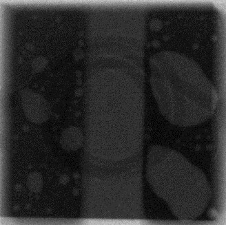

Before going into the results of the conducted tests and experimentations, below shown are some results from the MAPI products with original land pattern:
Figure 4: Lake Voids
Figure 5:Lake Voids
One can see clearly the lake voids (figure 4 and 5). These voids result in weakening the joint and act as thermal insulators.
This results in faster increase of the inductor temperature, during inductor operation, as they obstruct the transfer of heat from the inductor to the PCB.

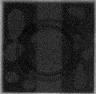

3.3.1. Pre– Tests Discussions and Results
Below shown are the CT scan results for the land patterns, which yielded the best results.
Figure 6: Distributed Squares
Figure 7: 180° rectangles
From the CT scans one can clearly see that the lake voids are completely eliminated but smaller voids still prevail the details of which will be discussed a little later.
Note: Stencil thickness of 120 μm was used and the rhombus shaped patterns that are visible in Figure 6 are due to the shape of the land pattern and are not actual voids.

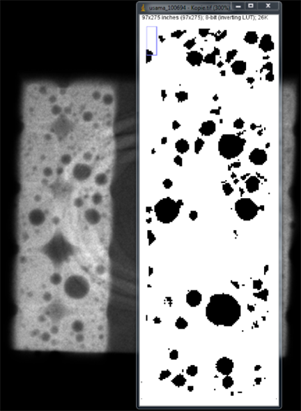

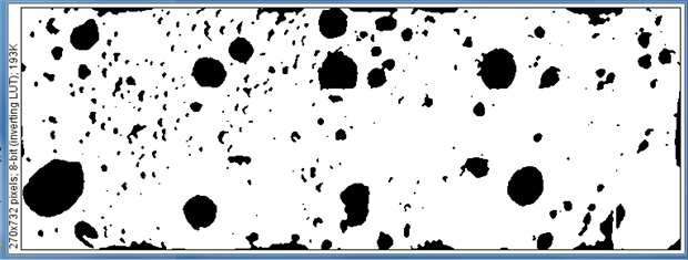

Shown below are the voids area calculation for Figure 6:
Figure 8: squares voids areaimage
The area of voids was calculated to be 14.96%.

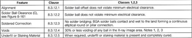

There exists no standard/norm which specifies the proportion of voids in a solder joint for BTC components. According to IPC610 30% of voids are allowed for BGAs and this was taken as reference for our analysis.
Figure 9: IPC610

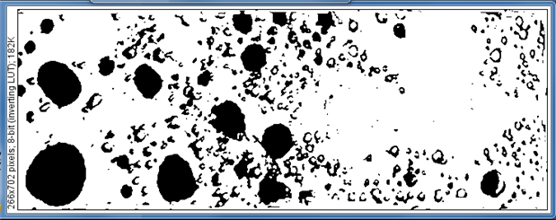

Note: the pitch of the stencil and the land pattern are always the same. Below shown are the voids area calculations for fig 10:
Figure 13: Void area calculation for figure 10 (left pad)image
Area of voids was calculated to be 21.10%
Note: The red circled area in figure 11 is not accounted for voids calculation. It is not actually a void rather a place devoid of solder paste itself. It is due to the land pattern design and bad solder finish because of the higher fine pitch capability of the solder paste than the pitch size of land pattern itself.
Figure 14: Void area calculation figure 11 (left pad)image
Area of voids was calculated to be 14.2%
