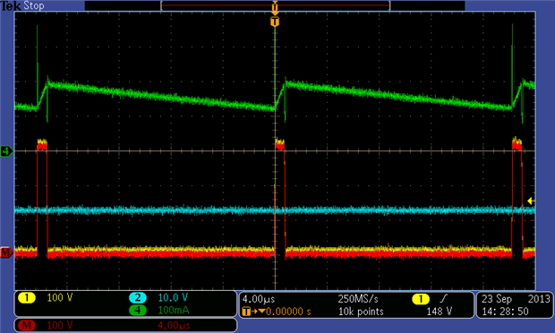

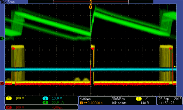

Figure 2: HV Buck in CCM with L1 = 3,3 mH. VIN = 230VRMS, VOUT = 12V, IO = 150 mA
Ch.1 (Yellow) = Switching Node, Ch.2 (Blue) = VOUT Ch.M (Red) = ΔvL1, Ch.4 (Green) = IL1

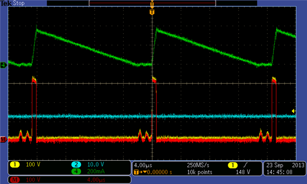

Figure 3: HV Buck in DCM with L1 = 470 μH. VIN = 230VRMS, VOUT = 12V, IO = 150 mA

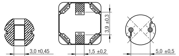

Figure 4: Pad-to-pad and wire-to-wire clearance in the WE-PD2 HV, WE-PD HV and WE-TI HV families
Figure 4 shows the smallest member of each of the three families of HV-rated power inductors, and shows that each more than enough clearance between the electrical connections to prevent arcing at 2500 VDC. The magnetic cores of inductors (and transformers) are considered to be conductive parts as per IEC-60950, and as such their level of insulation is functional.

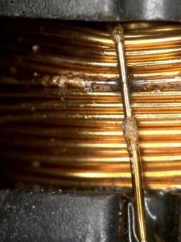

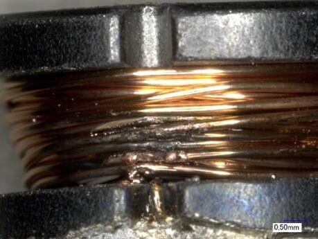

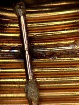

4. The Danger of Using Standard Inductors
It is common practice to use the same families of through-hole and surface mount power inductors as both the energy storage elements in low voltage (< 60 VDC) DC-DC applications and for input or output filtering in offline applications. One important factor in both these applications that is often overlooked is the voltage rating of the inductors. In fact, the vast majority of power inductors lack voltage ratings in their datasheets. Good quality manufacturers can provide this information upon request, or provide information on the thickness of the varnish used or other details of the mechanical construction, but the time required to then calculate the voltage that a given inductor can withstand is completely out of step with today´s fast-paced design cycles.
Figure 5: Arcing and short circuits due to overvoltage on a standard power inductor
In a rush to complete design work on-time it can be tempting to select standard power inductors, but Figure 5 shows the unfortunate results that can occur when using these parts in high voltage applications – breakdown of the insulating varnish, short circuits between adjacent windings – in short, failure of a component that is normally the most robust part of a switching converter. A shorted inductor, especially one that can short AC line and neutral together during part of the switching cycle presents a genuine safety hazard to operators and service personnel. If electric shock, injury or even death occur as a result the equipment manufacturer can be held liable.

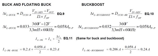

5.1. The Inductor

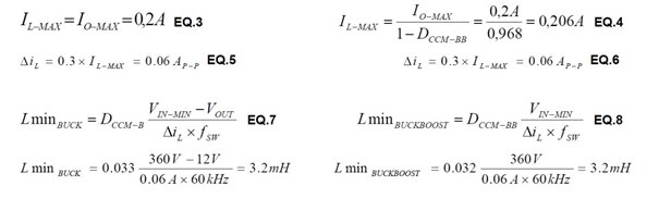

Magnetics form the heart of any switching converter, from this example delivering 2,4 W to a multiphase fullbridge converter delivering kilowatts of power. Regardless of topology, the most common way of selecting the required inductance in CCM is to specify a ripple current through the inductor, ΔiL as a percentage of the maximum average inductor current, IL-MAX. Setting ΔiL equal to 20 % to 40 % of IL-MAX represents a good compromise, tested and confirmed by the design of countless switching converters, and gives a balance between size (larger ripple requires less inductance and therefore smaller inductors) and efficiency/noise (smaller ripple leads to lower RMS currents and lower EMI).
For buck converters IL-MAX = IO-MAX, with the floating buck sharing the exact same design equations with the standard buck. In buckboost converters average inductor current is a function of duty cycle and output current. The first-order equations are for a ripple ratio of 30 % are:
The next highest E12 value is 3,3 mH, designated L1. Once this value has been selected the actual inductor ripple current and then the peak inductor current (IL-PK) can be calculated:
With inductance average current and peak current all calculated actual inductors can be selected from the Würth Elektronik eiSos catalog. For this example the  76877093327687709332 of the WE-PD HV product family is a 3,3 mH shielded device specially designed for 400 VDC operation with an RMS current rating of 0,37 A and a peak current rating of 0,52 A. This part uses surface mount technology and is best suited to two-sided PCBs that already incorporate other SMD circuitry. Lower cost applications often use single-sided PCBs and purely through-hole technology, but in this case the principal disadvantage of CCM operation becomes plain – no 3,3 mH, HV rated through-hole parts are available.

Figure 6: HV Buck on CCM-DCM boundary with L1 = 2,2 mH. VIN = 230VRMS, VOUT = 12V, IO = 57 mA

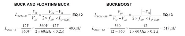

The point where inductor current just reaches zero at the end of each switching cycle is often called Boundary Conduction, or BCM, and can be defined mathematically as follows:
These equations show the inductance values above which the converters would operate in CCM when delivering their maximum rated load currents. In non-synchronous converters there will always be a threshold of output current below which the converter will transition from CCM to DCM regardless of how large the inductance is. There is no harm in DCM – in fact for high voltage non-isolated applications it is actually more common to operate in DCM under the full range of load. In CCM converters, once the actual inductance has been selected the equations EQ.12 and EQ.13 can be re-written to show the threshold for boundary conduction as a function of load current. Taking the example of a 2,2 mH inductor, these would then be:
6. Design Example for Discontinuous Conduction Mode (DCM)
In DCM the current in the energy storage inductor falls to zero before the end of every switching cycle, and in order to operate in DCM the switching converter must either use a diode as the uncontrolled switch or actively control the synchronous MOSFET to prevent current from flowing backwards (from drain to source). For cost purposes it is far more common to use a diode, and for operating voltages above 200 VDC the preferred technology is the ultra-fast PN rectifier.
The principal advantage of DCM is that the inductance must be lower to ensure that the converter stays in DCM even at the highest load. Lower inductance translates to a smaller core and hence smaller, lower cost inductors. A second advantage of DCM is the reduced switching losses in the control FET, since the current in the inductor is always zero when it turns on.

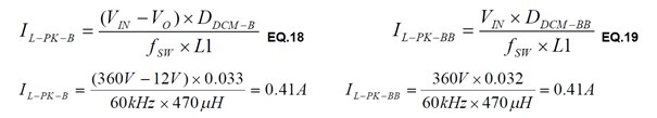

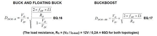

6.1. Inductor Selection
The same equations used for identifying the boundary between DCM operating and CCM operation are used to select inductance for the DCM case, the only difference is that they now set a maximum permissible inductance. Repeating the results from EQ.14 and EQ.15:
In theory any value below LMAX will work, but because inductance and peak current are inversely proportional in practice it is best to select the next lowest standard value in order to prevent peak current from reaching excessive values. A standard E12 value of 470 μH will work well for both designs, and in order to select an actual device from a catalog the peak currents for each topology must be calculated. Peak current and peakto-peak ripple current are equal in DCM, and to calculate this value the duty cycle must be calculated first. With the actual inductor value selected the amount of energy transferred from input to output during each switching cycle is known, and the duty cycle of the control FET in each topology can be calculated:
The next step is to calculate the peak inductor currents:
Based upon the limits for inductance and peak current an actual inductor can be selected The  76877144717687714471 from the WE-PD HV product family is a 470 H inductor with a saturation current limit of 0,8 A
This is a surface mount part that includes magnetic shielding for low EMI and measures 10 mm x 10 mm by 6 mm tall Most important of all the 768771 family features design and post-production testing to ensure that its parts function correctly with differential voltages of up to 400 VDC Such a part would be a good choice for dualsided PCBs where an HV non-isolated buck accompanies other surface mount circuitry For simpler applications where the PCB has a single layer and less expensive through-hole parts are used for the capacitors diode MOSFET and resistors a better choice would be the  768772471768772471 from the WE-TI HV product family a through-hole device also 470 H and with a saturation current rating of 0,9 A

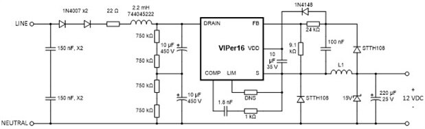

7.1. Complete Circuit Schematic for Buck Regulator

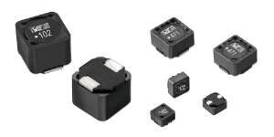

7.2. Würth Elektronik eiSos’ High Voltage Power Inductors
The following families of inductors are guaranteed to operate properly with up to 400 VDC according to Würth Elektronik eiSos-Standard 1516, even after three reflow processes:
