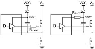

Figure 2 shows two possible positions for a slew rate limiting element: in series with the high side MOSFET´s gate or in series with the bootstrap. The bootstrap position is superior for three main reasons. First, it only limits the rising slew rate. This saves power, since only one switch transition is slowed each cycle and switching loss increases when slew rates are decreased. Second, slowing the falling slew rate of the control MOSFET in synchronous buck converters can provoke shoot-through – where both MOSFETs are ON at the same time, and this is never desirable. Third, whereas the gate resistor can only be used when the power MOSFET is separate from the control IC, the bootstrap pin is accessible to the user for most buck regulators with internal MOSFETs, making this technique applicable to many more control ICs.
Figure 2: Gate resistors slow rise and fall, whereas boot resistors only slow the rising edgeimage

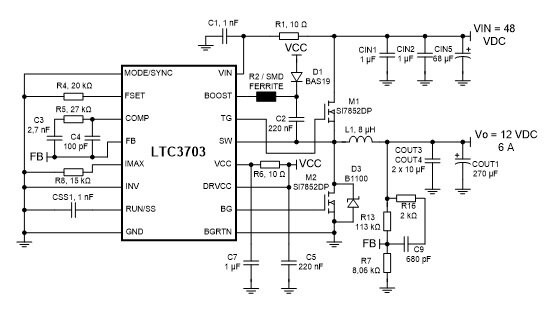

For this application, note the example circuit is the DC501A demoboard, using the LTC3703 synchronous buck controller from Linear Technology. Figure 3 shows a simplified circuit diagram, and the complete circuit schematic is shown in chapter 11.
Figure 3: Simplified DC501 demoboard showing the bootstrap and slew rate element R2image

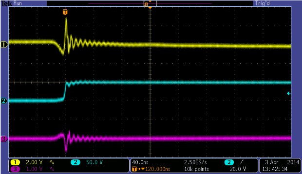

3.1. Step 1: Measure the Ringing Frequency

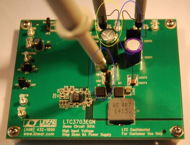

Starting without any slew rate limiting elements, set up the converter with the typical input voltage and the maximum output current. As shown in Figure 3, these conditions are 48 V in, 12 V out and an output current of 6 A. Capture the rising edge of the switching node, making sure to set the oscilloscope to its full bandwidth. For best results use the spring-tip accessory supplied with most oscilloscope voltage probes to minimize the pickup of radiated energy in the loop created by the probe tip and the grounding pigtail. A section of three 2,54 mm spaced breakaway header pins with the center pin cut off makes an excellent test jig. Also, a piece of 0,5 to 0,75 mm bare wire wrapped around the exposed barrel of the voltage probe will work well if the spring-tip is lost or missing.
Figure 4: Proper, low-noise voltage measurement. Yellow is the input voltage, pink is the output voltage, and blue is the switching node

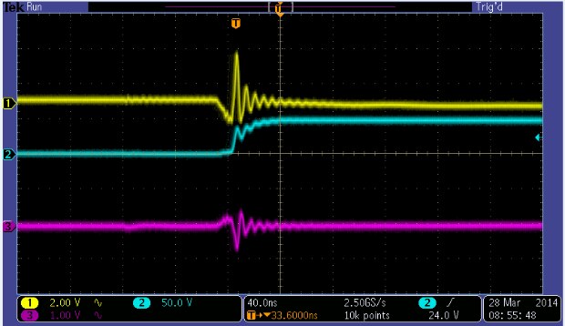

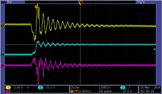

Zoom in with the oscilloscope until the period of the ringing can be measured as shown in Figure 5. For this example the ringing frequency is almost exactly 150 MHz
imageFigure 5: Careful measurement of the circuit without slew rate control shows a ringing period of 6.64 ns, corresponding to a ringing frequency of 150 MHz

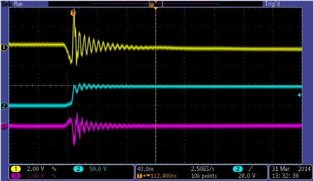

Figure 6: Ringing of the DC501A without any slew rate control. VIN = 48V, VO = 12V, IO = 6,0A
Ch.1 = VIN AC coupled, Ch.2 = Switching node, Ch.3 = VO AC coupled

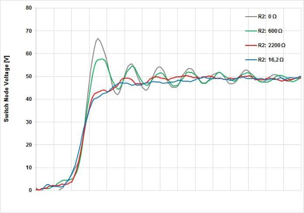

The device with the highest resistance at the ringing frequency provides the best reduction in both the amplitude and the duration of this unwanted oscillation (as shown on figure 10), and selection is a simple matter of consulting the product datasheets.
Figure 10: Comparison of the switching node voltages

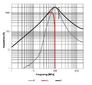

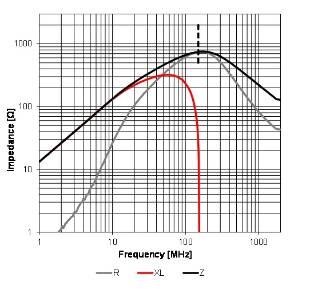

Figure 11 shows the typical reactance, resistance and impedance curves for the 74279265 (600 Ω) and the 742792693 (2200 Ω). Make sure to use the resistance curve, since true resistance is what converts the high frequency current into heat.
Figure 11: The 74279265 (Left) and 742792693 (Right)

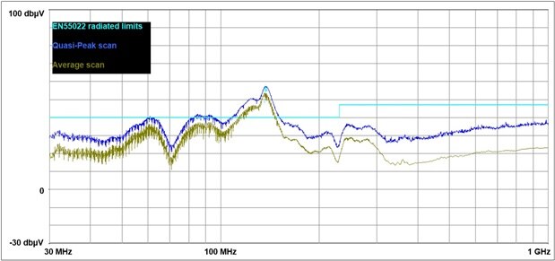

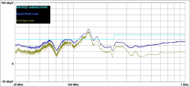

4. Radiated EMI Scans
This section shows the response of the DC501A evaluation board to radiated EMI scans as per EN55022, the EU standard for EMC in IT equipment.

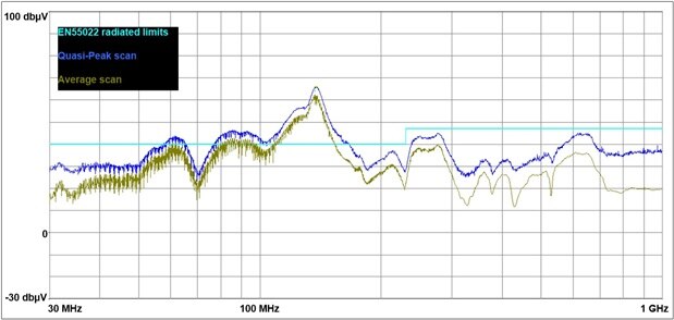

Figure 12: Radiated EMI scan of the DC501A without any slew rate control. VIN = 48V, VO = 12V, Load = 2,0 Ωimage

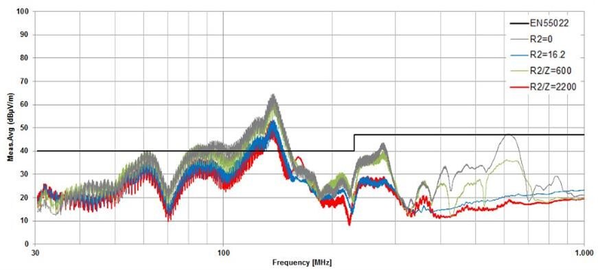

Figure 13: Radiated EMI scan of the DC501A with R2 = 16,2 Ω. VIN = 48V, VO = 12V, Load = 2,0 Ω
Figure 14: Radiated EMI scan of the DC501A with R2 = 600 Ω, 0603 ferrite. VIN = 48V, VO = 12V, Load = 2,0 Ω
Figure 15: Radiated EMI scan of the DC501A with R2 0 2200 Ω, 0603 ferrite. VIN = 48V, VO = 12V, Load = 2,0 Ω
R2 = 0R2 = 16,2 ΩR2 = 600 Ω 0603 ferriteR2 = 2200 Ω 0603 ferrite
Frequency (MHz)Quasi Peak (dBμV/m)Average (dBμV/m)Quasi Peak (dBμV/m)Average (dBμV/m)Quasi Peak (dBμV/m)Average (dBμV/m)Quasi Peak (dBμV/m)Average (dBμV/m)
149,98951,0140,5641,3331,1149,0340,339,1629,67
150,08650,4246,3340,4736,8249,1844,5538,930,63
150,18350,6241,1640,9529,6548,9638,638,0130,57
Table 2: Radiated EMI in the range of 150 MHz vs. slew rate elements
Figure 16: Comparison of the Radiated EMI scans of the DC 501A
Overall, the radiated EMI scans support the data taken in the time domain: A well-tuned resistor placed in series with the bootstrap circuit´s positive supply reduces both quasi peak and average radiated power levels by about 10 dBμV, but a ferrite bead, selected for the highest resistance at the fundamental noise frequency works as well, and often better than the resistor.
