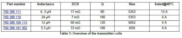

Following are the Würth Elektronik eiSos transmitter and receiver wireless coils considered for evaluation-
Transmitter coils
          1. 760 308 111
          2. 760 308 110
          3. 760 308 104 113
          4. 760 308 101 302

The Wireless coils considered for this evaluation are listed in section 3, the brief specification summary is provided below for further calculations.
5.1. Transmitter coils

Now that the receiver coil is selected and its inductance value is 47 μH, the transmitter coil can be selected to meet the turns ratio of 1:3 as recommended in LTC4120 datasheet.
For the above requirement Wrth Elektronik eiSos has a part  760308101302760308101302 A brief specification is 5.3 H 6 A 33 mΩ Q 100
